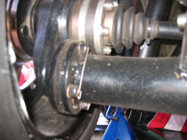

I took a whole lot of pics on 4 cyl gtv race car on the weekend on allits supension etc. This car is absolutely brilliant in design and on the track. It races in our legends series and holds off some our 7litre mustangs. He runs now three seconds faster than my 24v. Yes it does way 800kg's but its superb . Cut long story short I was going to post awhole bunch of pics until his mechanic said " dont post any of those on the net ''. Any im only going to post one pic of his toe,camber set up on the dedion which uses two flanges and tapered wedge made to correct angle setting. This design allows you try a whole bunch of options at the track without having to strip the dedion and re heat and bend. Tell me what you think
Re: Suspension
Nice idea for sure. Just how much adjustment it would get in use is hard to say once the "mean values" were set. I dont beleive a car's suspension would neet THAT much tinkering with on a regular basis. If it did, it certainly lends itself for other conversions that makes for adjustability like the front end by some sort of thread and lock nut configuration.
Re: Suspension
Yeah , but the trial and error going thru however many steps to find what works when there isn't a 'formula' or a 'recipie' or any advise to be had....this lets you find out what will work for a particular setup...then you can bend a fixed version to match if you want.
That kind of thinking is part of why he's so fast.
Re: Suspension
I have actually thought about something similar but to use a hub from a FWD car 916 GTV for instance, four screws and adjusted by "wedges" like that one. Never got round to it but it would be nice.
Can see a big benefit in being able to easily adjust camber and toe at the track.
Re: Suspension
The main reason why he did the rear like this was, initally he had cut the dedion and rewelded to 1.5 deg camber BUT just like most who have done this it had crept up to another degree by the time welding was complete. I think this is the cheapest solution(in the long run) to avoid the hit and miss aproach for extreme accuracy. My race car for some strange reason has 1deg neg on left rear and .5 deg positive on right rear. its never been in an accident so maybe accuracy was not the finest priority when welding at the factory. Unless mine is a one off. Anyone else have this problem?
