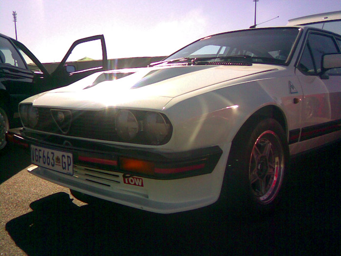

The line back to the right head is the oil overflow(standard on 166). This car has had the RS kit on it whole year including the 30mm front anti roll. 115kg with torsion bars front and 50kg rear. I have already ripped the bodywork on the front anti roll mounts from that rough stretch of road to Swartkopps, but all welded in with a plate now. It was just a matter of time as there is no support on the inner mounting bolt. I am going to leave the suspension as is, as I still like to drive the car to the track and hopefully back which I have done this whole season. Yeah I know its a comprimise but its working for me.
Not sure which Gotech it is but I know its the latest one. As long as it works dont really mind what moedl it is.
I have another LS in my Dads car(3.7) which I want to pull out tomorrow night just incase I dont get mine ready.
Believe it or not. Got a Gotech pro x installed and mapped in a day. I had already a spare 166 harness which made life very easy reagarding coils and injector looms. The boys at gotech loaded a standard 3.0 24v map then we ran it on the dyno to map properly as I have the Glenwood GTA2 cams in on the inlets. This took another hour.
Ran qualifying at todays race only two seconds faster than my 2.5 12v as I battled with the extra 70kw to keep the car on the track as my braking points were far out(over shooting corners). Anyway by the end of heat two I was seven seconds faster and still making a lot of errors.
Must say the car is extremely smooth low down and then that cams kicks in at four thou making an awsome exhaust note right up to seven thou( not to mention it goes like hell!). I will try record this sound with a clip. I think I have just the right power at this stage and need to work on driving skills . Will post pics later this week.
Forgot to mention I still have no LS in the car which makes it cery tricky to drive on this circuit with its double hairpin. Cant wait to put that in(LS still in pops 3.7 with the faulty e6x ecu) as there is the Kyalami 9 hr revival race this weekend. Only have to drive for two hours though. I still have not put the big brake upgrade in either and was very surprised the old old ones held out with no fade for twenty laps.
Pics from last Saurdays event including a 24v 3.4 Giulietta with front mount gearbox on full slicks. Also not as fast as the 2.0l 8v white Giulietta.
I put the red striping back on for origionality to make it 100% GTV3.0L except the motor has an extra 12v. I did not tell this to the poor chap, well actualy very wealthy chap in his D type Jag. Pretty much even down the 1km straight with him and then I pull a huge gap through the twisty bits. As there was a small entry of the other Historic cars ,they mixed in with us which was great so we got to go up against heavily modified 911 rs's as well.

Your car is beautiful. Very tasteful mods! What happened to the widened 15 inchers you had before?
More Giulietta pics please! :P
Grant, those rims were in the boot(trunk) of the 164 as spare. I prefer the compomotives as they were an optional rim on the GTV3.0L here and makes it look more origional. Mostly all came with the mesh type inners. Must admit these compomotives are not the strongets after 20yrs as I have one from the weekend with a major split in it where the bolts go through. I am even reluctant to weld this one up. It would be interesting to find out if these compomotive rims were designed to handle racing slicks. I will put some more pics of the Giulietta's up, need a week to get my memory stick back.
