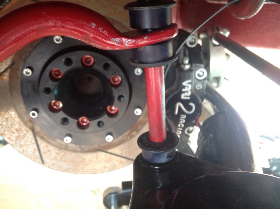

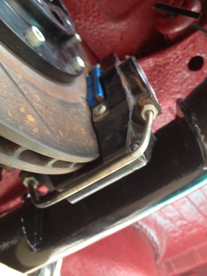

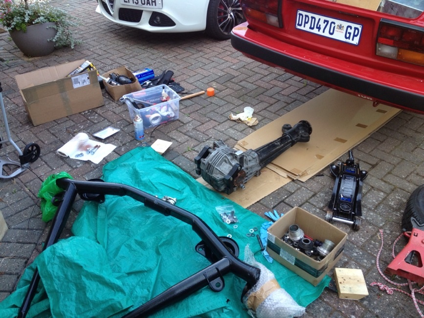

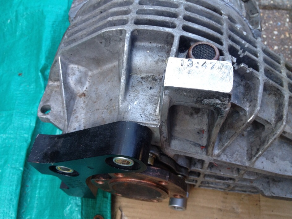

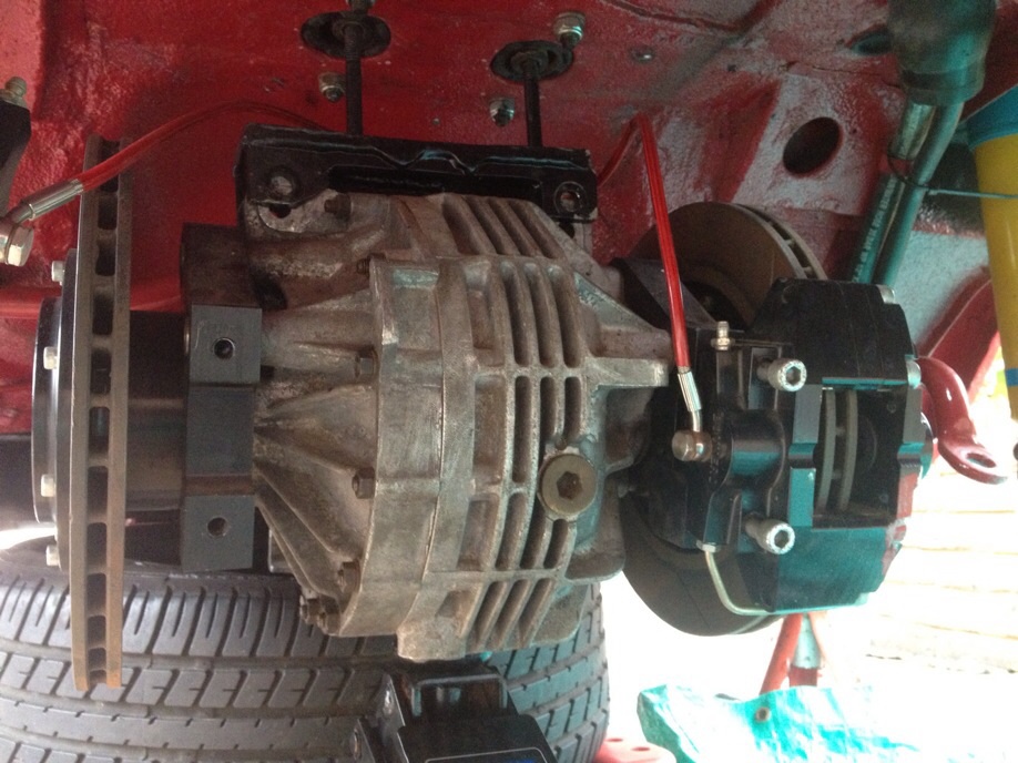

Work progressing slowly . Luck would have it my spare a Sei diff is the correct ratio and the LS was overhauled with new clutch plates a few years ago and its never been used . Just replaced my Dedion and fitted new wheels bearings . Thanks to Alex for supplying tools , workshop space etc . My Giulietta has been a perfect van when the rear seats are down to transport the Dedion over the UK countryside , so its now powder coated and already to go back . I did some different cut outs and strengthening webs inside the Dedion to take care of my mods to clear my callipers .
I could have just changed the calliper mounting brackets but I wanted the bleed nipples 100% on top unlike the 105 series ones I had on my previous race car . Those proved a nightmare to bleed . Speaking of that I see Goodridge has a self bleeding calliper nipple . Think I might order some since I'm on own to do work .
Some pics to follow of work in my hi-tech workshop ie the paving in the drive way : D )
I can just sense the neighbours wanting to moan

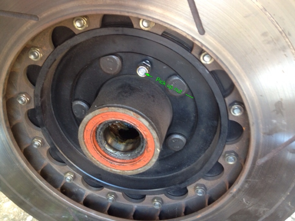

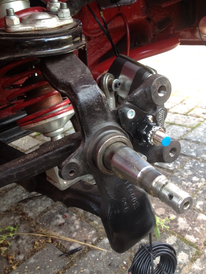

Amongst the many steps to get this car back to road trim ( 90%track 10% road) I have been trying to find easiest way to connect a speedo without doing the sat nav thing . I used the Hall effect pickup from Race Technology and mounted it to the stub axle . This picks up with the countersunk bolt that goes through the hub . Don't use stainless bolts

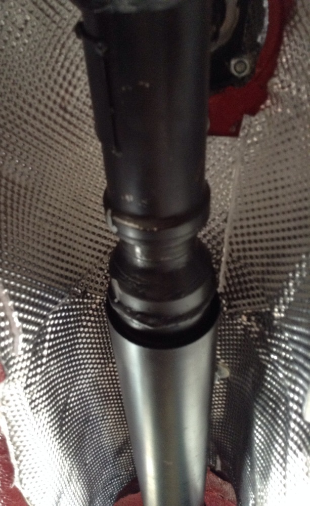

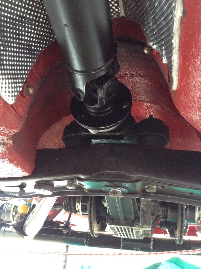

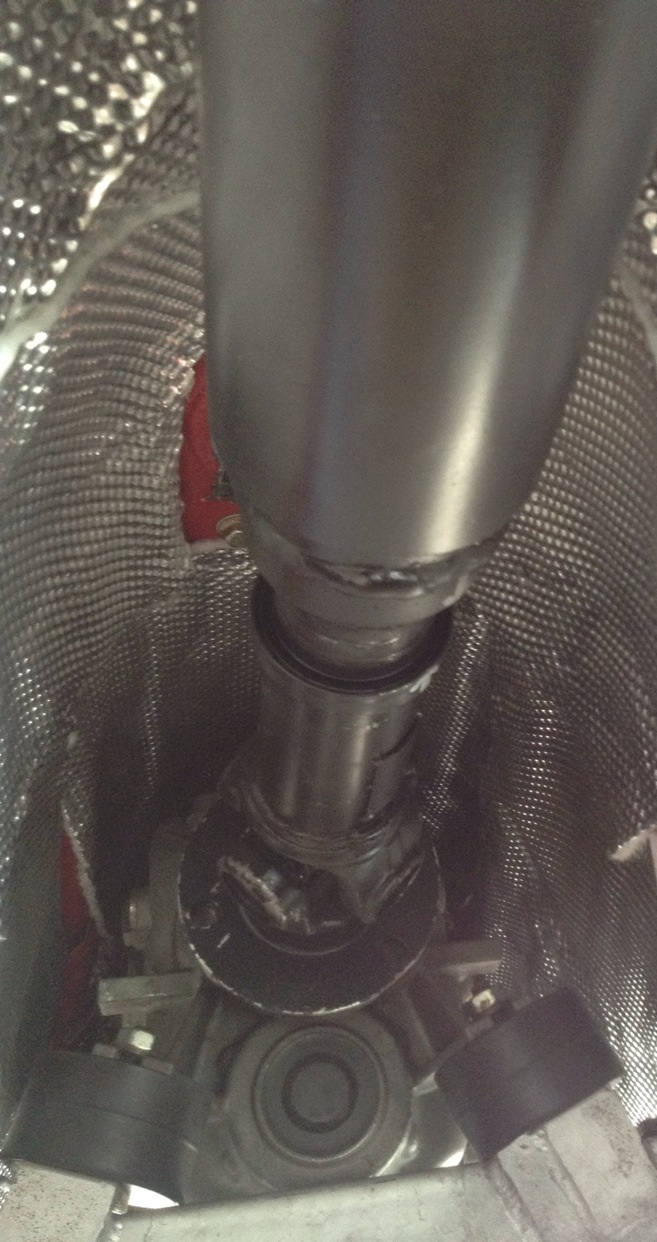

Work continues painfully slow on all fronts on the car . Wiring and remaking dashboard panels continues while the mechanical side gets refined . My new prop is in and its actual the exact section of torque resilient used in the Aston Martin . Before I put the prop in I lined the tunnel out with lightweight heat reflective and sound deadening material from DEI . Pretty expensive but I need to keep it light . Some pics
