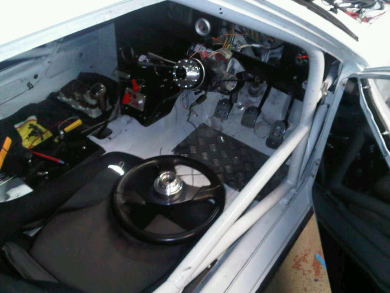

i started finishing off other small things on the car hoping my brakes will some how fix themeselves. With my new roll cage I had to change my steering wheel so i can actually work under pedal box in some sort of safe manner without breaking a rib ( again ).

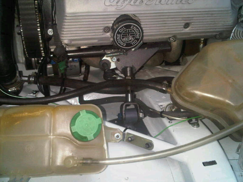

Also had to put back the mandatory breather overflow bottles for water and oil. they supposed to be 1.5l .
My engine stay is in on bushings . the brackets is riveted to body . should be fine as its on compression side. This will now compliment the straight prop etc from prevoius posts.
