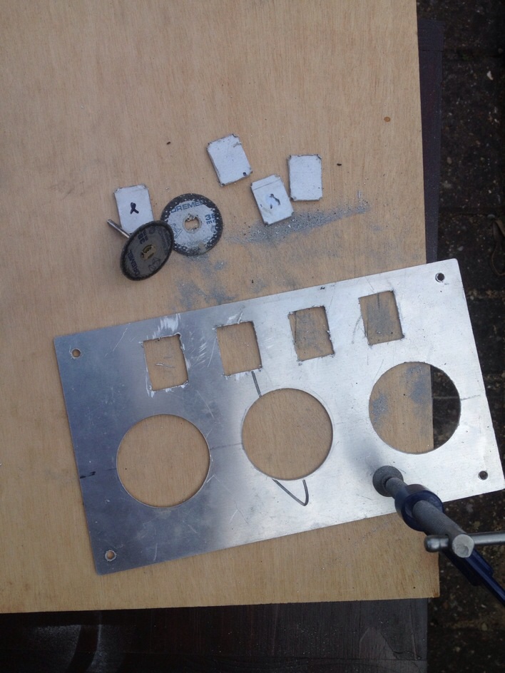

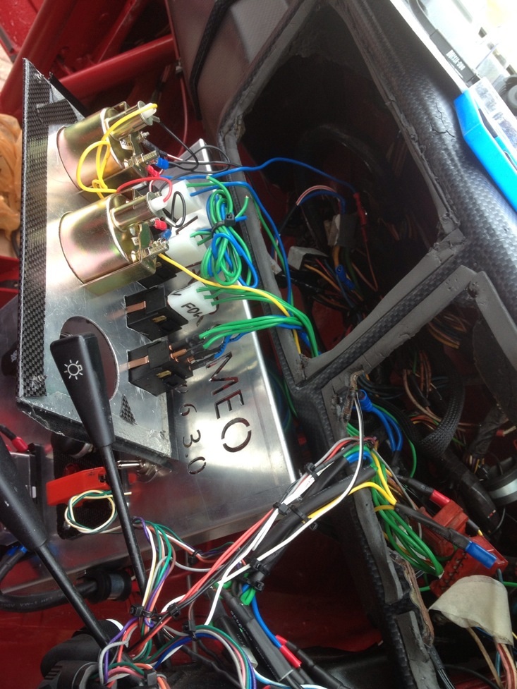

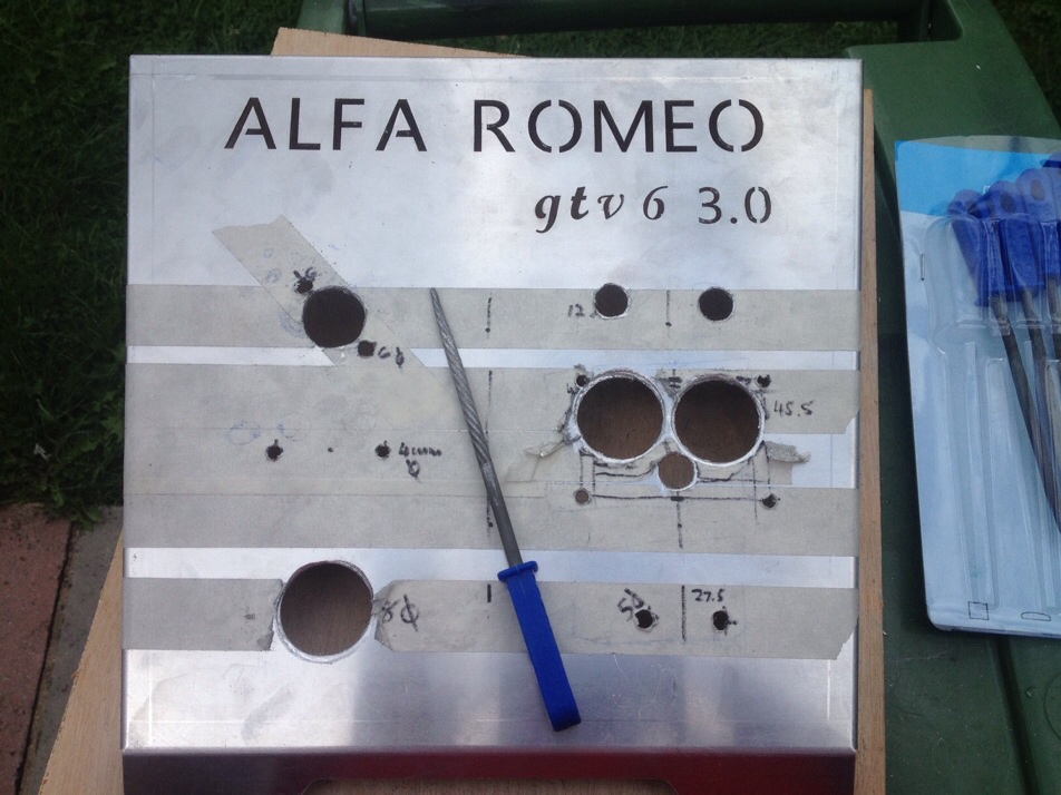

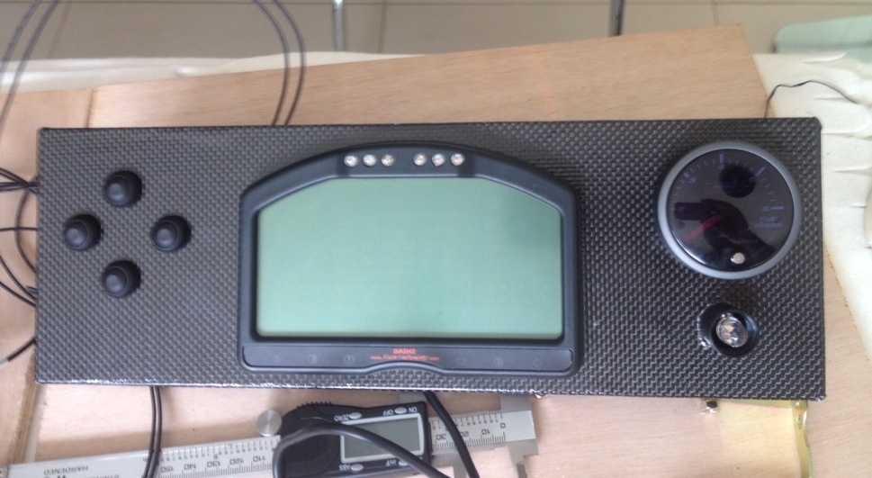

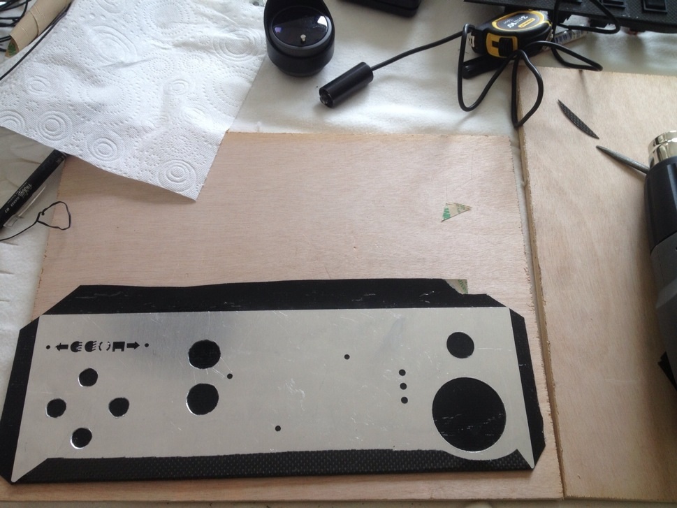

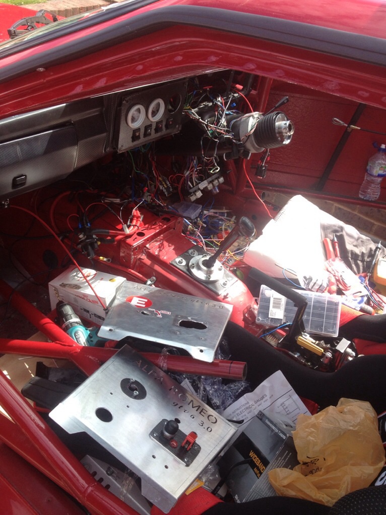

Started cutting out for new guages and buttons for DASH 2 display . Also additional buttons to get car through a MOT including fog lamps . I will add some more pics of prop to previous post when I find them . If anyone is interested I can put the name up of the guys who make these in UK .

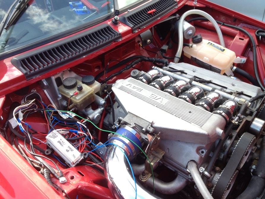

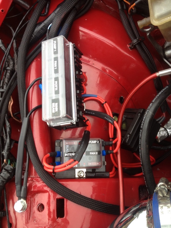

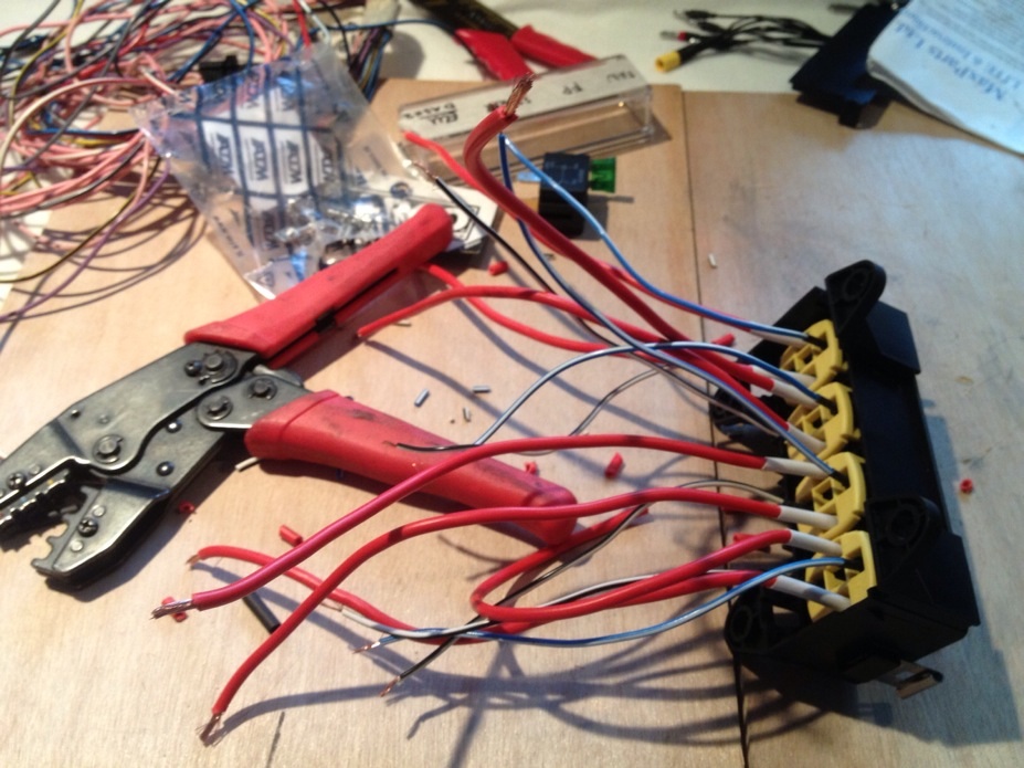

I bought a new relay holder and fuse box to run extra items . Atleast this relay holder is closed as its always being a problem getting rain into them in bonnet area . Not sure how though . Even with all these extra small items it still will remain mostly a race car but I have to cater for inclement weather which is quite common now for me . Need to run demister, wipers , rear windscreen heaters , extra fuel pumps , bigger fans etc . Hoping to get a lightweight heater / demister soon so just prepping the wiring .
Still a big mess in engine bay but slowly getting there . Can see the old and new centre consul .

Using the 3M carbon rap on panels created more problems as it originally stuck nicely but if you took the panels off the wrap would peel back off the edges . Even if the aluminium was cleaned and heat gun was used to soften the wrap on corners it still lifted after a few days . I think I will just have to glue the edges again as right now it looks pretty crap . I needed to find something to mask all the holes and scratches and I thought it was the solution .

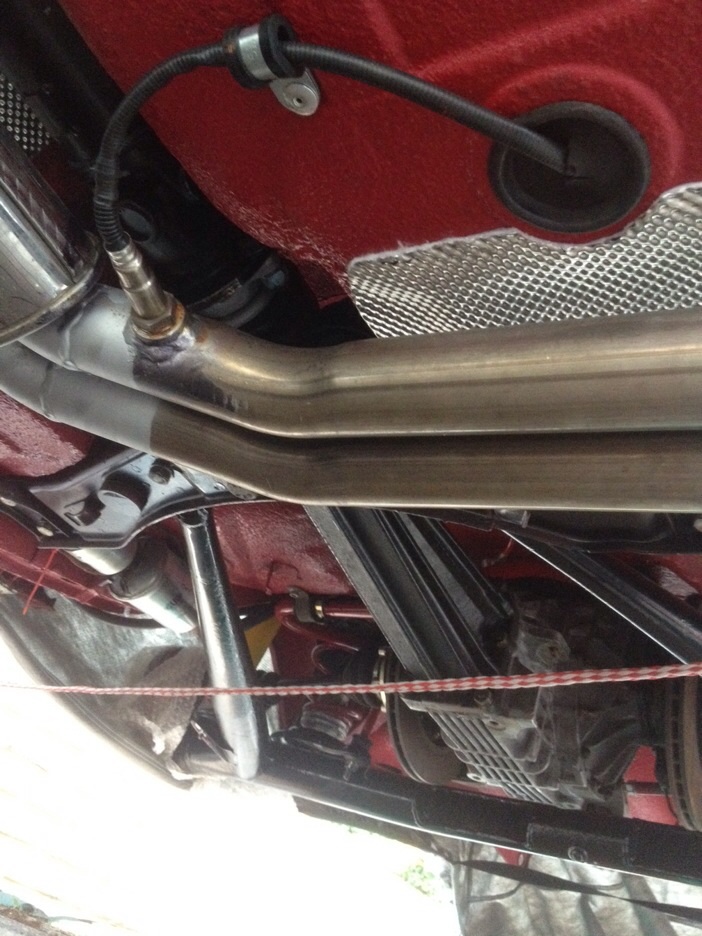

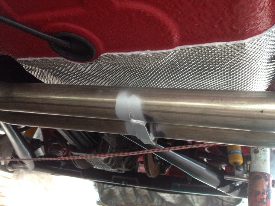

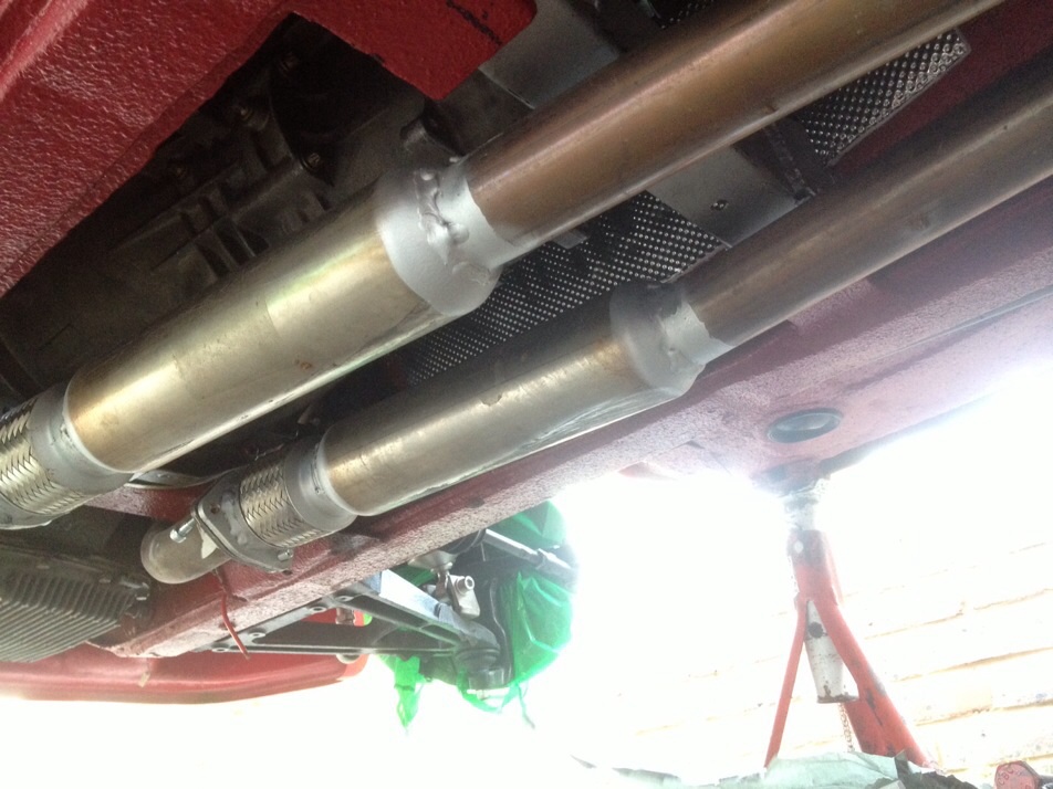

Some more pics of heat shielding directly above exhaust . Just cleaned and touched up on welding on exhaust joints to prevent corrosion as it was mig welding on stainless pipe .

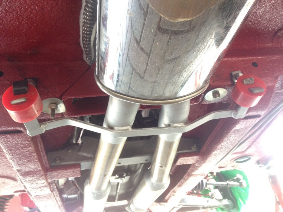

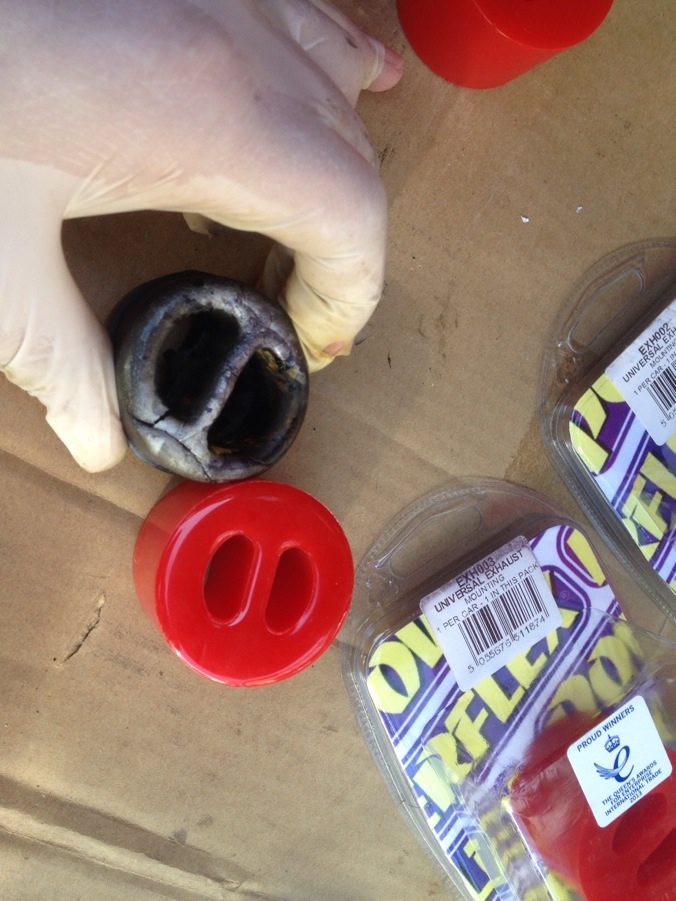

Tired of exhaust rubbers cracking after a year on the car so decided to try these powerflex ones at £5 a pop . Time will tell what he effects of tension and heat have on polyurethane .

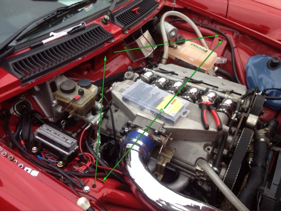

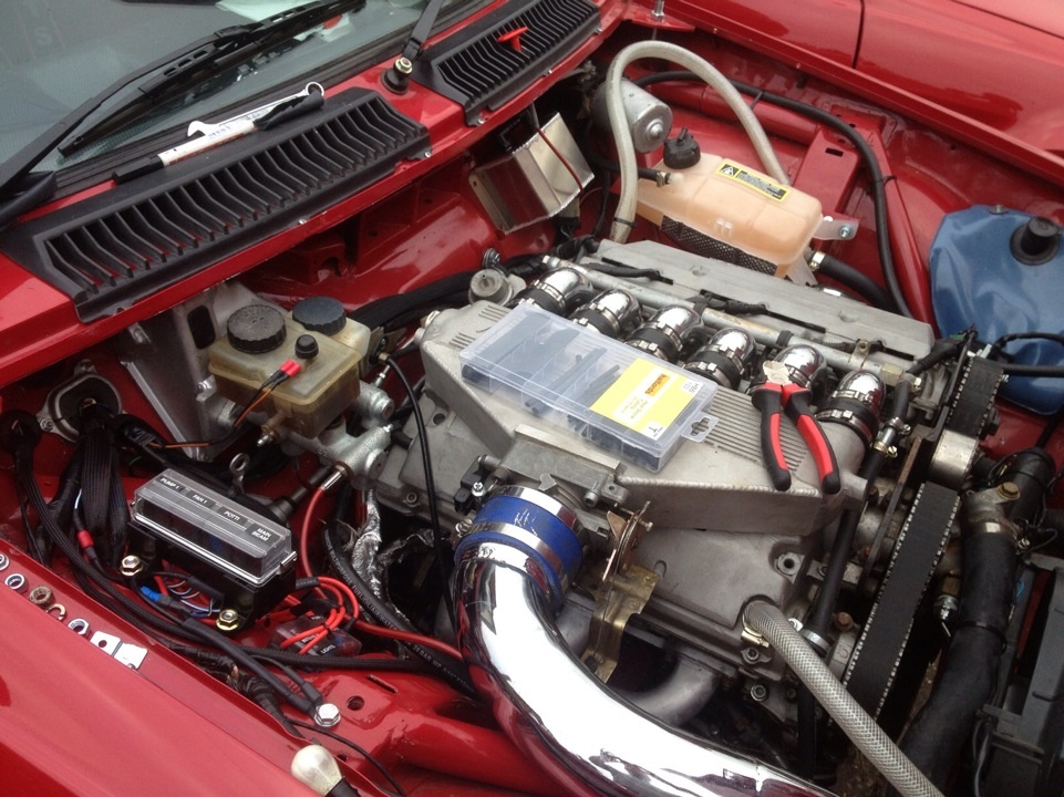

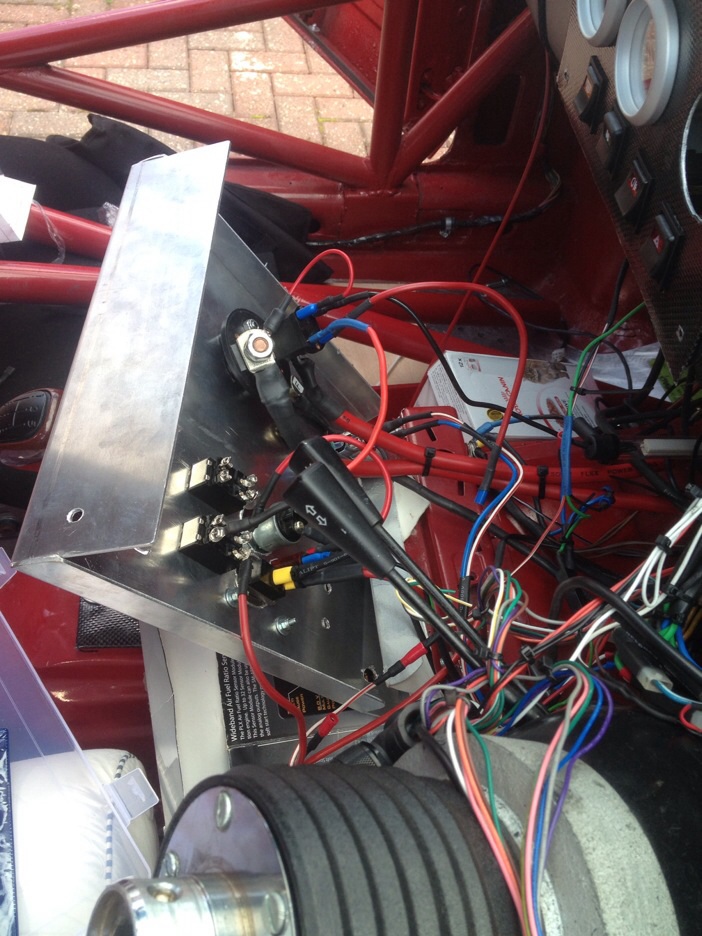

Fitted my newly made up relay box , fuse box and bulkhead connection all next to each . Decluttering the area where my cross braced for engine bay will triangulate to bulkhead .

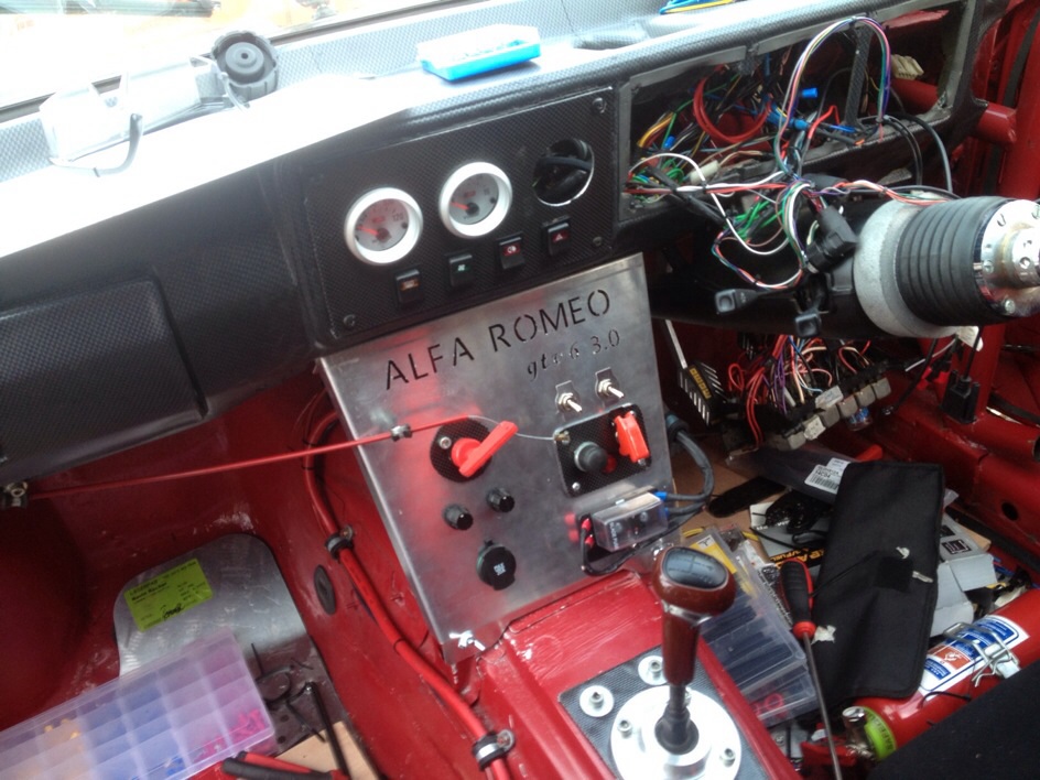

I got separate fuse box in centre consul to cater for ecu, race technology Dash 2 display and lambda sensor . Took a while to find a 1 amp fuse for the dash 2 . Dash 2 is all calibrated as I used their sensors but I must just calibrate wheel speed sensor .

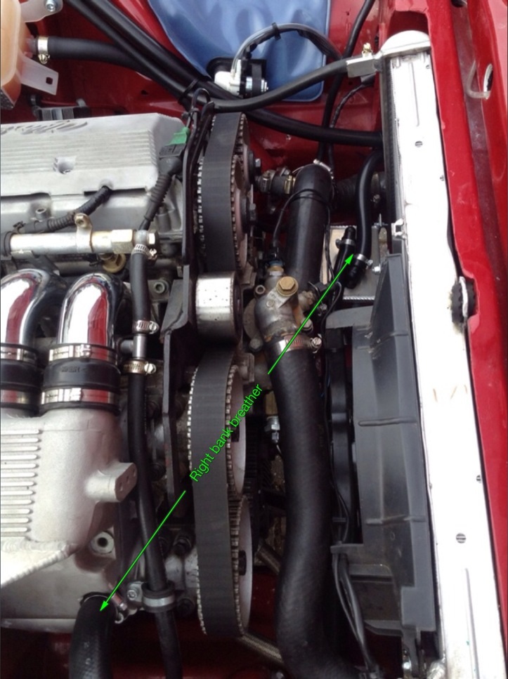

Engine bay is starting to look neater but still busy with all the pipe work for breathers .

Future cross brace . All connecting points are in just need to fabricate it .

Thanks for pic , that covers everything
. I won't need to brace on engine as the gearbox that sits behind it has very wide mounts so engine won't move much . I do have tubing that runs from shock towers towards the castor arm similiar to that of the 75 touring cars . Underside I still have a sump guard not that it adds to much other than protect my sump . My key thing is to triangulate back to the bulkhead as I have very heavy coil overs . I guess its all immaterial as its no longer a 100% race car but a track day car ..., however with possible future plans to race it again .

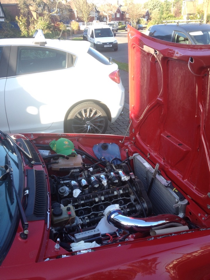

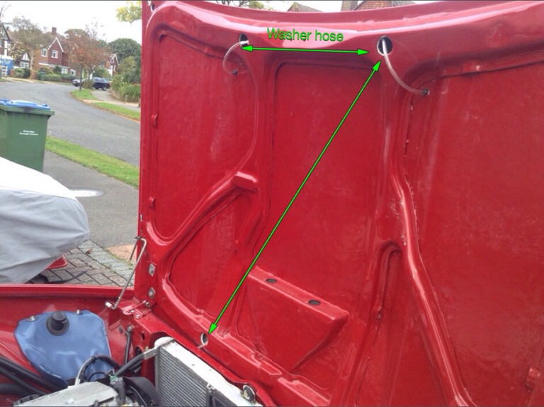

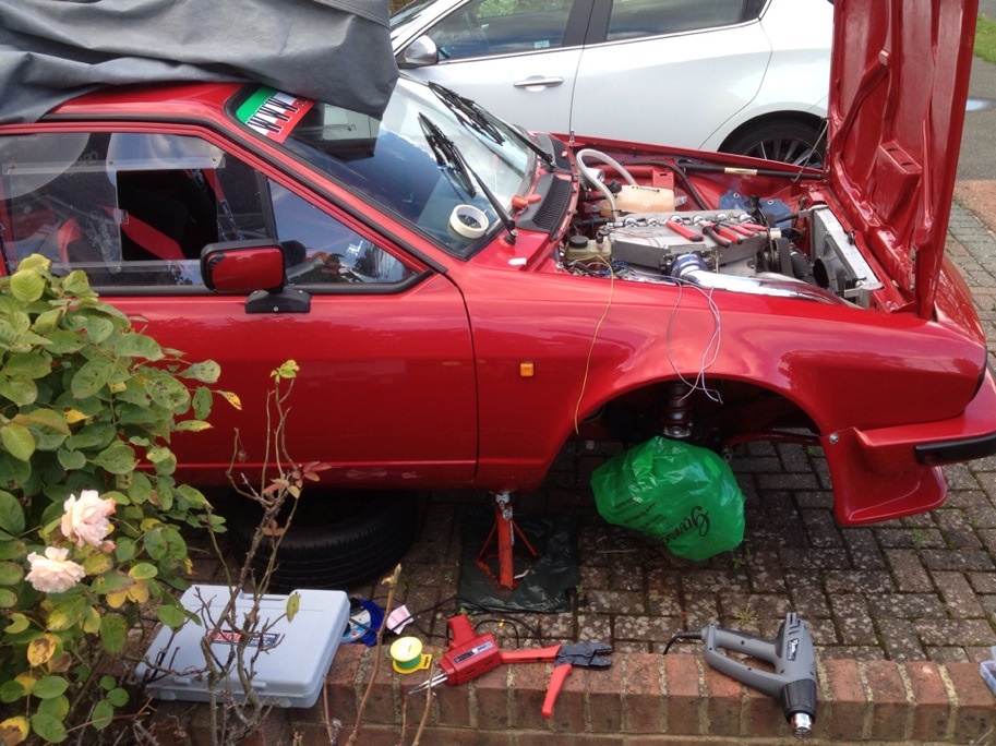

With the wintery rainy weather now rolling in now I think I managed to get 98% of the work done I set out to do in refining the original build and making it roadworthy . Fitted the windscreen washer hoses . Bit tricky to hole saw in back of bonnet without it suddenly going through to the front but all went well .

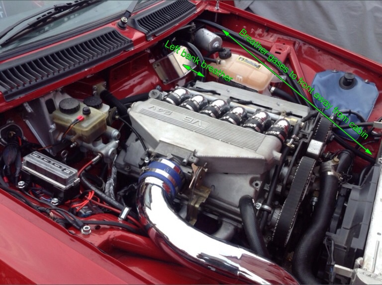

Got both banks breather bottles in . I intended using just the one oil catch tank but it was to small for both banks ( according to fellow Alfa racers ) and the bigger tank could not fit . I placed the second catch tank in bottom corner in front of the large aluminium radiator . I made sure this time the vent hoses are well away from cabin so I don't get the oil smell in even though all holes in firewall are now blocked .

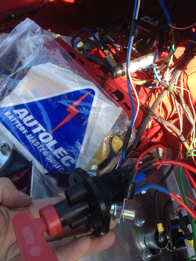

Even though I had a good kill switch I decided to upgrade it with an Autolec FIA type . Not cheap but then its great quality . I did already have new battery cable but changed the battery terminals .

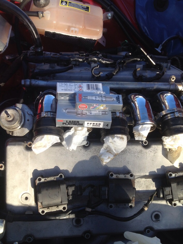

Finally changed the sparkplugs as I killed those from to much idling and over fuelling this was caused by not having a thermostat in . The ecu feuling on cold start is directly related to water temp . I could get away with it in SA as the car would warm up quickly and I could rev it without anyone hearing it in two miles . So yes as road track car many things have had to change including my new rear silencer section that I'm getting custom made for side exit .

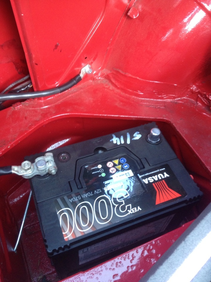

A proper battery has also eliminated any doubts of out of ordinary voltage drop on cranking . I got a great Yuasa battery . Again not cheap but it will be on a conditioner in the winter to save it .

So Mr Kevin,may I suggest to always install a plastic battery tray under your battery? It is also a good idea to treat the battery enclosure with a good wax based quality rust inhibitor paint cause sure as JK sleeps with a Teddy Bear
, corrosion will find a way to piss you off.
