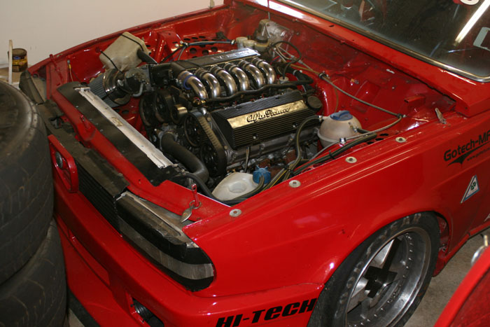

There was a good battle from two totally different cars one being the 3.4 24v Gliulietta (Domingoes) and the other a highly modified 2.0l 8v ultra lightweight Giulietta(Rost). Both these cars lap faster than 911 RS porkers to bring into perspective how fast they are. Some pics to follow.
