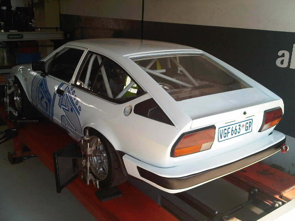

Anyway here are some pics of car at alignment ,below is before pic but ended up with equal castor just under 6deg. i have really pushed body work in at back of arch. Its always good to be allowed free access into my friends workshop and set alignment. He always argues that I should be running toe out with my driving style but he does not understand I dont have any style . I just go as fast I can without taking anyone out and rely on excessive power for lack of skill and no fear under braking - so far so good.

pic of car on alignment bay. See how those one piece fiberglass bumpers look like the originals at fraction of weight. Note spare wheel shoved in back of car incase i got puncture on route.

Car looks good - like the graphics.
Not much camber going on there? I'd expect 3.xx (was that upped in the after?)
Also ,factory setting was a small amount of toe out (?amt) so maybe your friend is right (not about the style issue, obviously) - toe out will address any reluctance to turn, but is prob less relevant with soo much castor - can't remember what my gtv6 got when I sprinted it - will try to find settings.
