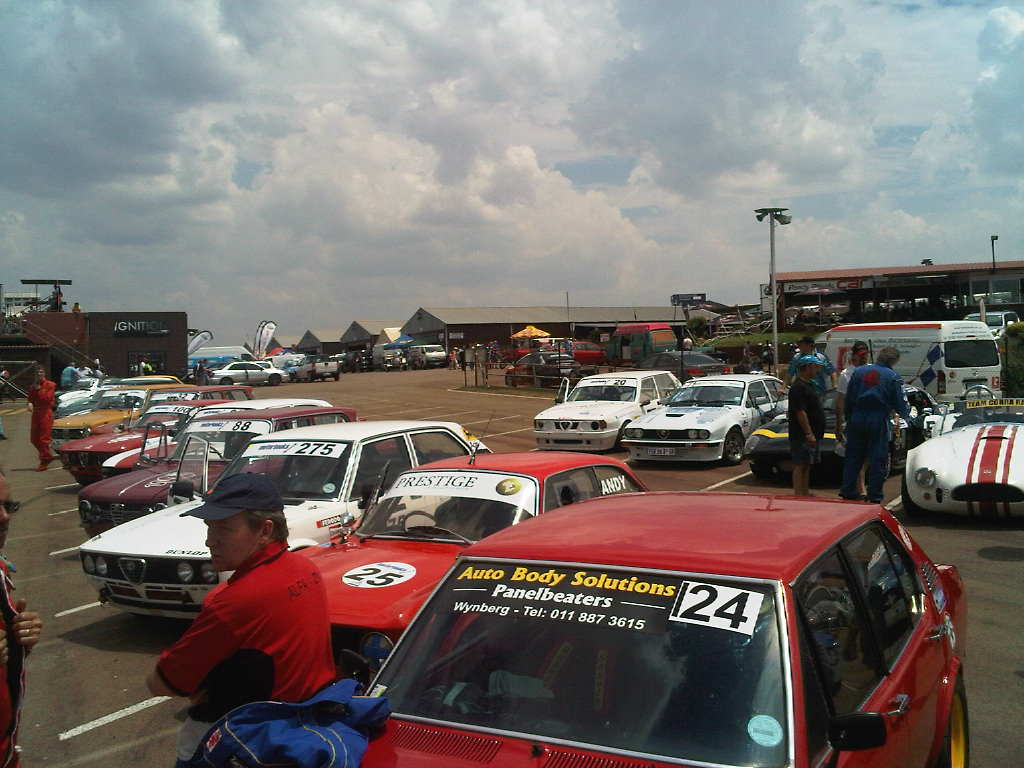

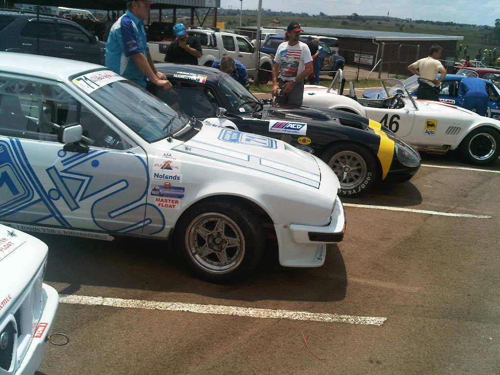

Here some pics of Race day on Saturday. We had 33 entrants and mixing in with the American muscle cars at the same time.
As usual there were only two clowns who drove to the track and home after the race and in a proud way I was one of them as it meant nothing broke. On the positive note I had 5th fastest time of the the day. This included the cobras, daytona, and other Alfas but finished in a poorly 15th as a cobra stalled on startline and I was stuck for 30 seconds(and another lightweight Giulietta) behind it while the rest of the field were long gone. Not even 1 second seperated the top 5 fastest cars.Anyway I will post later on what were the positives on the car

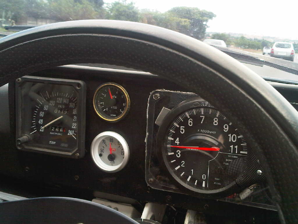

Ps the speedometer is just for show incase the feds pull me over.

After reading Jims book , i decided to relook into the engine oil department . I have been using a Shell 15w40 which has been good for road use but under track conditions and hot weather the oil pressure has been dropping to scary 2bar at 120 degrees (4500 rpm) Remembering this 24v motor has hydraulic lifters and combined with forged pistons its needed a bit of experimentation but in the right direction . I think i have found solution and decided to change oil after qualifying with a castrol edge sport 10w60 . I managed to gain a further 0.8 bar but im still not to convinced its even close to perfect but its now its 2.8 bar at 4500rpm at 120 degrees . My water temp was only 80 degrees which has come down since i have opened up the front bumper.
Some questions to you guys
Should my oil temp be getting that high in these hot racing conditions . (track temp was 34 degrees) even with an oil cooler.
Whats a minimum pressure you should be running ?

A lot of NA race engines use that oil over here without any problems. Maybe your oil pump needs to be rebuilt to closer tolerance. I think the oil pressure should not fall below 40 psi.
The water temp is way too low at 80*. Your combustion efficiency is crap. It should be close to 100*C with appropriate additives and pressure. I run the Cab at 98*C.
Md , i hear you but if i have 7 bar at start up and gradually loses pressure as heat increases is it a tolerance issue ?
Next question what would you set the temp forfans to kick in andthen what temp to switch off . Maybe i am engineering my own problems here

Far out man ! 7Bar oil pressure that would be way more than you need and a waste of horsepower. I had 5.5 on the Brick at the start, no oil cooler, ran a 20W60 oil and never had a pressure problem. IE. it remained above 2.7 which in my view is OK.
I cannot remember if you're using an oil cooler on the engine or not but it sounds like you should. If you are already using one, then I am fresh out of ideas for you.
As for the temps, well kick the fans in around 102-3*C and switch off at 95*C. Currently I am not using a fan at all and just let the forward motion of the car do the heat exchange and remember, our tracks are in the sub-tropics.

A bigger oil cooler sounds like a good plan if you get up to 120 degrees with the current one. I believe 130 degrees is the breaking point for oil, after that it start degrading quickly.
My friends use the Castrol Edge 10w60 stuff in their turboengines and speak very highly of it.
The old rule of thumb is 10psi oil pressure for every 1000rpm - so if you have 2.8bar (about 40psi) at 4500rpm you are just under par.
120 deg is not outrageously high for a modern synthethic oil - the high temp rating for viscosity levels is at 100deg - but I think your move from 40 to 60 was well advised.
Agree the coolant temp seems low - is the thermostat working?
