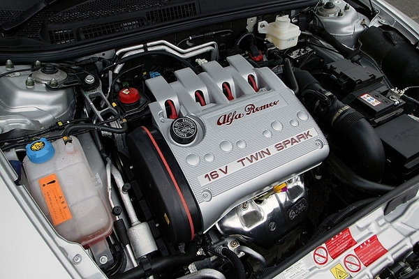

- 155 16v 2L Fiat-Alfa engine.jpg (230.59 KiB) Viewed 8177 times
I'd got the 2.0 16v route...I imagine engine mounts and somehow adapting the bell housing via a plate to the engine.
Adapting the 2 liter V6 to NA application would mean fiddling around with the engine more than with the 16v, plus on the 16v you have TS...
Don't know, it just seems to me too much effort to adapt the 2L V6 to NA application for not so much to be gained.
Mike,The 20l 16v is not such an impressive option.Not reliable (bearing reliability) and expensive to modify ! We have a few running here in mostly 105`s but also a 116 gtv20l..

Barry wrote:Mike,The 20l 16v is not such an impressive option.Not reliable (bearing reliability) and expensive to modify ! We have a few running here in mostly 105`s but also a 116 gtv20l..
Now a little 20l v6 at 10 000 rpm..mmmm,now Im drooling !
I've heard of such bearing failures before, yet again, my father has a 2.0 16v 146 that is going for 185.000km now, never been opened, never changed the dreaded cam phaser thingy and pulls like new. I guess using Motul synthetic oil and oil changes at 5000km is paying off. Don't know about racing applications though.
I've been opened few 16V TS engines, and there seems to be two common reasons for failures. The reason no. 1. is the cam belt, which may break before changing interval. Looking under cam belt cover sometimes will help a lot.. No. 2. is that some of the engines use to drink some oil and users don't bother to check it and fill it up, which causes bearing problems.. Conrod bearings go first and mains follow soon after. These were road engines, so racing engines may have other problems.
