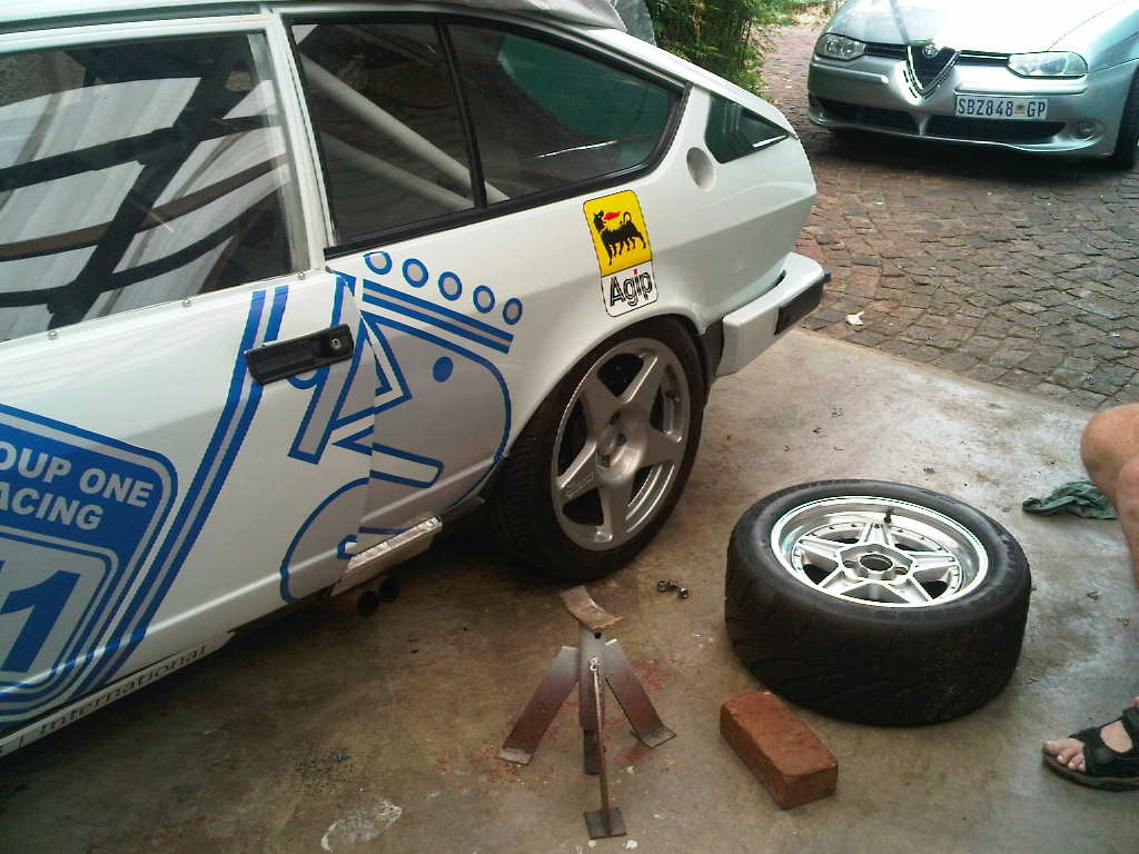

i have decided to save costs and wear on race tyres when driving to track (120km) so I got a set of compos 17inch from Bazza with road tyres. Actually I am trying to reduce my fine when the five -o finally stop me . All they can fine me will be no handbrake (but I do carry choc block and a warning triangle
), loud exhaust, and stickers on front windscreen.
Its gonna take some more mods to get these wheels to fit with the large castor.
Also gonna cut a spare set of speedlines from 8.5J to7.5J as the definately can clear the castor arm even with spacers.
- rim-compo17rear.jpg (97.47 KiB) Viewed 16432 times
- rim-compofront.jpg (110.94 KiB) Viewed 16432 times
- rim-compofrontlow.jpg (86.59 KiB) Viewed 16432 times
Some pics of speedline rims I wanna modify. I need to bring cente piece in 10mm and take 25mm off inside rim.
- rim-speedlineside.jpg (66.34 KiB) Viewed 16431 times
- rim-speedline.jpg (88.52 KiB) Viewed 16431 times

Speedlines are a much stronger rim than those old compos . But they are double the weight and still pretty light relatively speaking.
Hope you using new nuts and bolts . Had a rim snap its bolts last week. Last time i send them in for refurb so now do it myself unless you supply new bolts and check they have tightened them properly. A slightly bucked split rim also put unecessary stress on bolts as well.

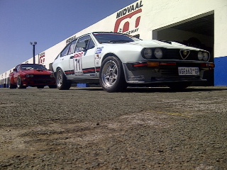

some more pics of 3.7 vs TT - obviously at Midvaal raceway - the TT had a really good outing...
- kevin vs tt.jpg (49.22 KiB) Viewed 15971 times
It was good so see the tt on the track after nearly two decades of storage . They ran it at such low boost to shake car down and soften those old slicks . Irony is it had some gearbox issue ( lost reverse and kept selecting 5th instead of third) but still managed to finish . Note this has it's gearbox upfront.
My car with all the mods ie outboard brakes , gearbox cooler, and using Redline 75w90NS oil has proved pretty bullet proof .
Having a 3.7 with huge power has also allowed me to skip using second gear which was always the gear I was vin when the pinion failed on the other 3 boxes . I have also made more effort to be smoother on box even when there are four cars abreast all fighting for same piece of tarmac.
