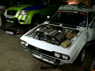

some pics of LAST minute Oil Cooler issues... just before race
kevin 12.jpg (42.49 KiB) Viewed 14072 times
kevin 11.jpg (43.94 KiB) Viewed 14072 times
kevin 10.jpg (43.36 KiB) Viewed 14072 times
kevin 9.jpg (46.84 KiB) Viewed 14072 times
My new workshop is a communal basement parking. Every time I want to start the car I have to push it 50m into the open otherwise all the mother grundies start complaining . Probably do one hectic burnout in here when I leave :D these people simply don't appreciate an alfa orchestra :wink:
