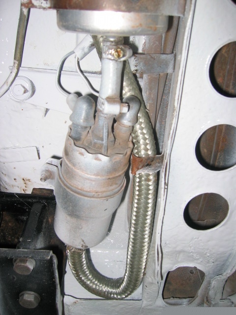

All fuel hosing has been replaced including the one from the tank to the filter. This particular pipe has always given me problems on all the GTV's due to its age(15-20yrs) and the 180 degree bend. Got some braded fuel hose with a spring inside to stop it from collapsing.

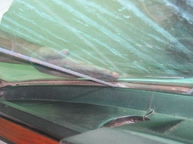

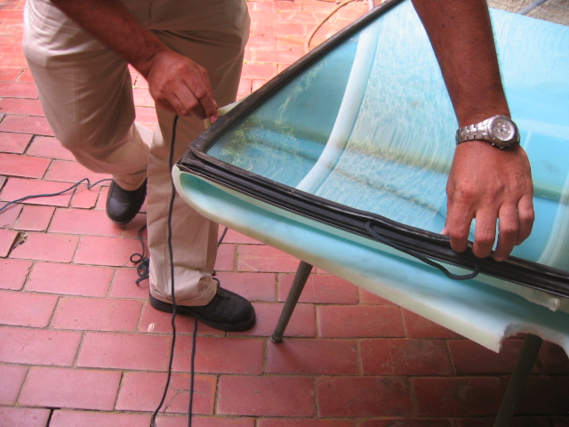

Just two pics of putting the windscreens back in. Very important is to check before you take them out is for any chips. If you have like I did you must get them drilled and sealed(glued). If you dont that tiny chip will run into a huge crack as you remove the windscreen.(done that before). First pic shows how you loop the nylon rope on all for sides so when you lie the windscreen down9on the car) and press ,you slowly pull from the loops.

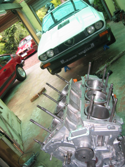

pic of the 3.7 in progress.

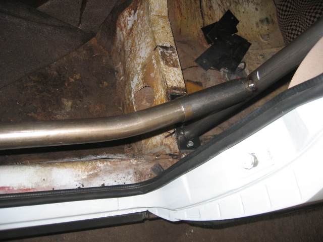

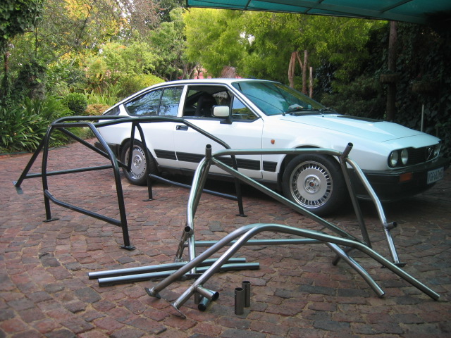

Firstly this cage adds nothing to the car (in terms rigidity) other than fulfill a requirement. Any way it turned out well and can be removed in five minutes. I designed it so it could be used in my other road GTv's without having to rearrange the furniture(all seats in and working sun visor). Only six brackets welded to the chassis, with nuts welded to the back off them are necessary. Here some pics of the process.

Hi Kevin,
You seem to be seeking some feedback so on the basis of the invitation..
Couple of things about the main hoop (your so called mid mount)
1 The mounting position is fairly useless on crush because the section you have placed it upon has very little guts to support it. Have a look at the rear of the crossmember and see. You need to fabricate a baseplate that takes the sill section into account.
2 The main hoop is usually required to be of larger wall thickness or larger diameter than the other sections. I cannot tell the thickness but the OD size seems to be the same.
3 As for the bracing qualities of the design, well where do I start?
As you say, this set up seems more cosmetic than anything else to me.

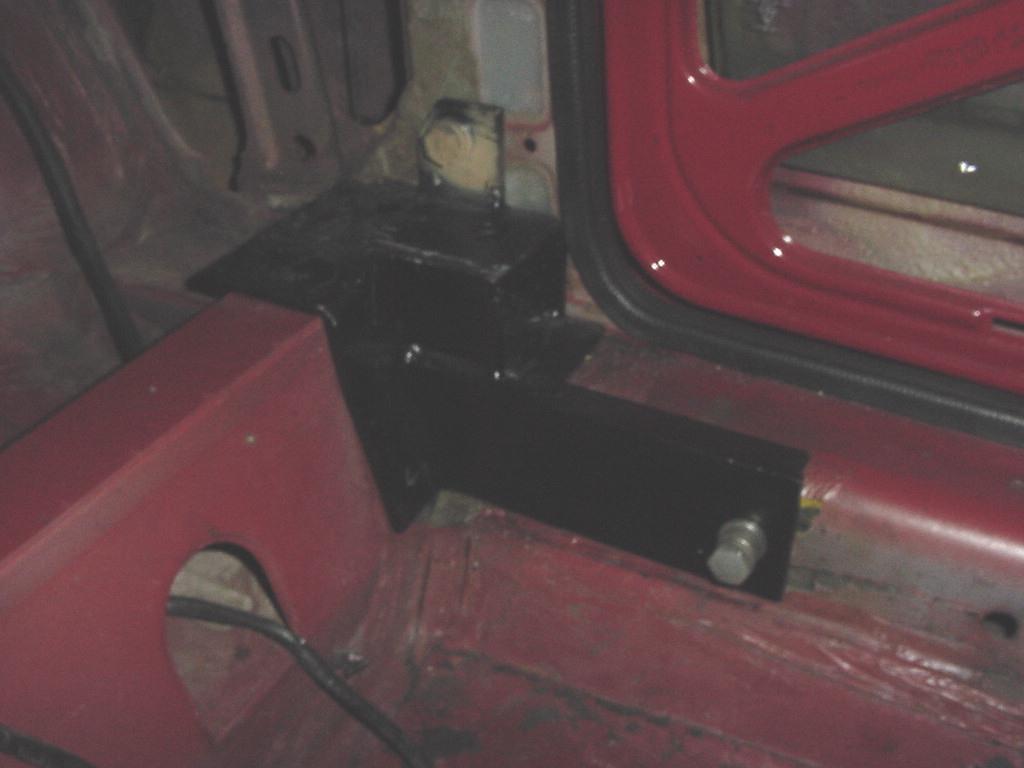

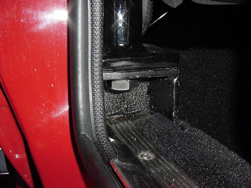

See pic for main hoop base detail. Sorry about the quality. Note the engagement of the two safety belt anchors. The cage is removable by undoing a 16mm high tensile bolt clamping it together from underneath. The nut that it bolts into is held captive within the base of the tube.
- Main Hoop Base Anchor Brkt.jpg (132.22 KiB) Viewed 11373 times
- Main Hoop Base Bracket.jpg (56.96 KiB) Viewed 11374 times

And MD, that design looks a bit scary too, that bolt would shear off instantly even if that open walled bracket would actually take the load without buckling, Kevins design looks much better in that aspect. A closed box on the sill would naturally be the best option but I think you have your reasons for the designs you have. Street legal cars no doubt?

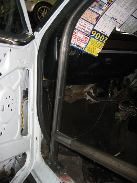

Thanks for feedback. There is a 5mm plate welded to the mid section but your are right it is pretty useless unless it is wrapped around and strenghened up. Come to think of it all the slip joint connections are useless because the connections use two 6mm bolts.Not so good in tension I will take pics of this to show more clearly. Basically at this stage Im just trying to pass scrutineering and get my log book stamped and then the engine transplant will take place. When this happens I will weld the slip joint and make it a lot more effective. Mats have you got a pic of the brace you are talking about or draw it. Thanks.
