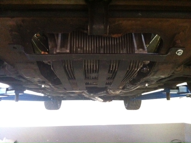

Re: A new GTV6 2.5 entry into SA Marque car catergory

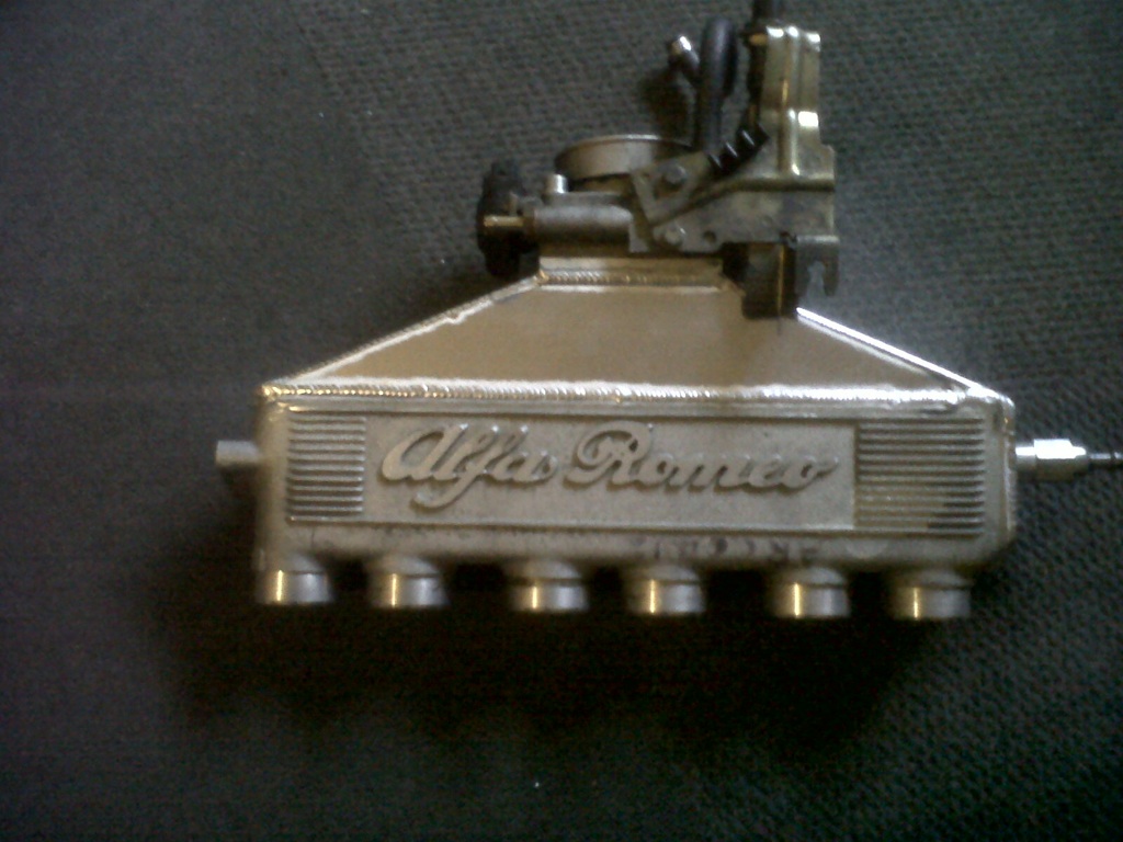

another pic... plenum
- Modified Plenum
- plen modified.jpeg (188.09 KiB) Viewed 8656 times

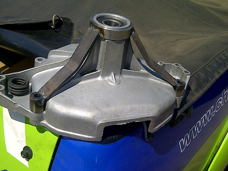

Completed Clutch Housing - Thanks to MD for giving info to Kevin!!!!!!!!!!!!!!
- housing4.jpg (97.38 KiB) Viewed 8641 times

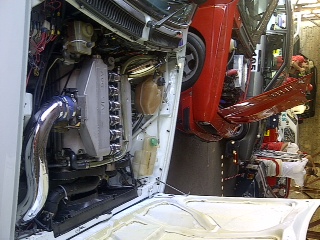

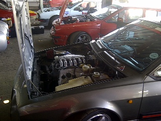

Race weekend coming up at Midvaal - I hope car will be ready.... motor is in, the rest to be done, wiring, air filter, dyno setup, etc, etc -some pics below
- engine is in -
- new sump guard.JPG (100.71 KiB) Viewed 8621 times

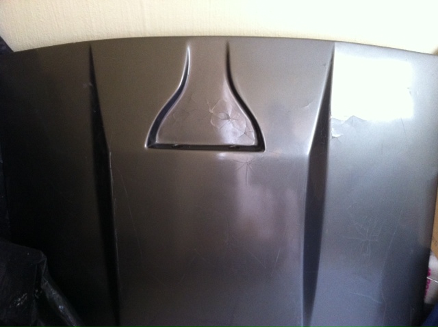

- 3.0 Lt original bonnet - need to clean and paint it now
- bonnet.JPG (78.68 KiB) Viewed 8621 times

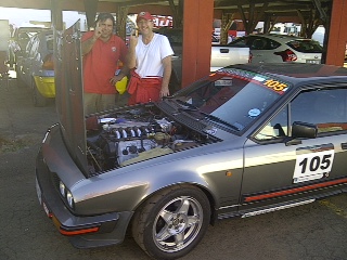

- A trio of GTV6's - Mine in foreground, Jose's second and Kevin furthest -
- midvaal 2.jpg (48.62 KiB) Viewed 8597 times

Joemart,
Something has been lost in the translation.
Your clutch housing braces need to be straight- not bent.
Yep MD , we had to retranslate . The first housing with the straight arm required about 15 mm of bodywork to be pushed in and it's really difficult when taking clutch in and out under the car at the track which I found out . It can be done but if you have reallyheavy rear springs like I do at 65 kg then you have to get two guys to sit on boot when jacking dedion up to make space to pull clutch out .
SO option was if the design was compromised with bent arms all this means that the welding will have a twisting moment on it as you no longer have a force running directly along the y axis of the flat bar ( unless you put a small web). I did take this into considreration and felt we are still so much better than without - so that's the way it fits now . Also the new moment on the welds will try turn the ring off and not twist it off if that makes any sense .
Ideally we need four arms . Main thing is we are steps forward .( hopefully) MD please comment - hey we learn all the time from you

Kevin, I accept the compromise explanation. There is a likelyhood of minor body build differences in the sedan versus the coupe to explain the clearance issues. The Brick didn't have these problems with 420lb rear springs. Anyhow moving on..
Others wanting to do this and for an update on a new version of these braces, see my edited post on the Cab on page 15. This is a better brace and should overcome your clearance issues too.
Cheers, MD
Cheers, MD

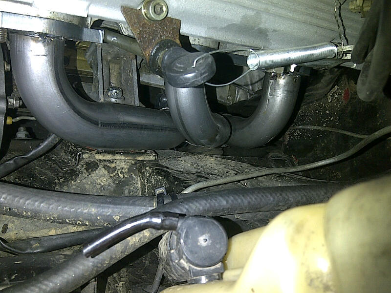

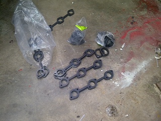

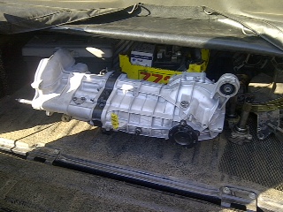

Hi All
Ok - time for an update
- been a while.... after the last race, I "broke" the manifold/s
, so had to get new ones made... PLUS i decided I would also get a refurbed gearbox and LSD!!!! \
so, (i am sure Kevin will add his bit), here find some pics of manifold...
38mm ID, 41.?? OD
and BOX
38mm ID, 41.?? OD
and BOX
- gerabox low res.JPG (50.79 KiB) Viewed 8528 times
- manifold low res1.JPG (111.71 KiB) Viewed 8528 times
- manifold low res3.JPG (45.32 KiB) Viewed 8528 times

Joe , they should be 39 Id . Even though these are not and ideal equal length set up I have seen 120 kw on wheels here with exact set up . Ok he had group 1 cams .(6000ft altitude here) .
With your LS in there should be at least a1.18 time at swartkops .

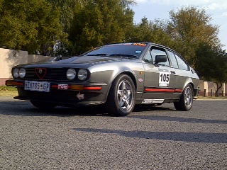

Latest Pic
- latest pic of car...
- photo aug 2012lowres.JPG (55.14 KiB) Viewed 8473 times

Well... The race weekend never WAS....
- long story, but the car never got to the track
BUT, here is an interesting thing I found out....(not sure if it is in the right category?)
About 2 months ago, as I said in another post, I fitted a reconditioned box with LSD - well, after fitting it the car felt very "pap" (an afrikaans word for flat)... it just felt as if the car has lost power .. took it to SAME dyno, (yes there are factors like Temp, etc that can affect), but the car was down about 6-8kw at peak power, and was down substantially throughout the rev range (we had changed headers at same time), so I thought iot may have been the headers, though it made no sense as these were the same as used previously by Kevin R and in fact in all other installations, power was gained...!!!
Anyway, last week (due to fact that 2nd and 3rd gear are grinding), yes, within a month of isntallation
we have put the old box back and guess what ??? - YES, the power is BACK!!!!!!!!!! - ALL OF IT and MORE
........we did a run before on dyno (about 1-2 months ago) and AGAIN last week... we went from about 102-103 KW on wheels, back to 112-113 kw on wheels, BUT with an EXTRA 10kw at 4500!!!!!!! - the car FEELS great..
So, not sure if anyone else has had same experince???, but in my mind, appears that LSD sucks a LOT of power.... is it linear to power??? dont know, don't think so, or is it a FIXED amount of power that is just sapped by an LSD?? - if so, it could be anything between 7-9kw - now on 102kw, that is close as dammit to 8%...
Thoughts???
PS - Kevin has some details as well... Kevin, your thoughts??

Yes , the race weekend that never was - my car was also stranded as the transporter hydraulics broke .
Any way back to the LS , we had a 147 with an LS that also lost about 5 kw but according to the experts at the track , they said this is not an issue as measuring on the dyno is not the same as when the oil warms up in the gearbox and after a lap or two on the track the power should be back
Good to here ideas from the guys who been through this before . JK , anyone , anyone
