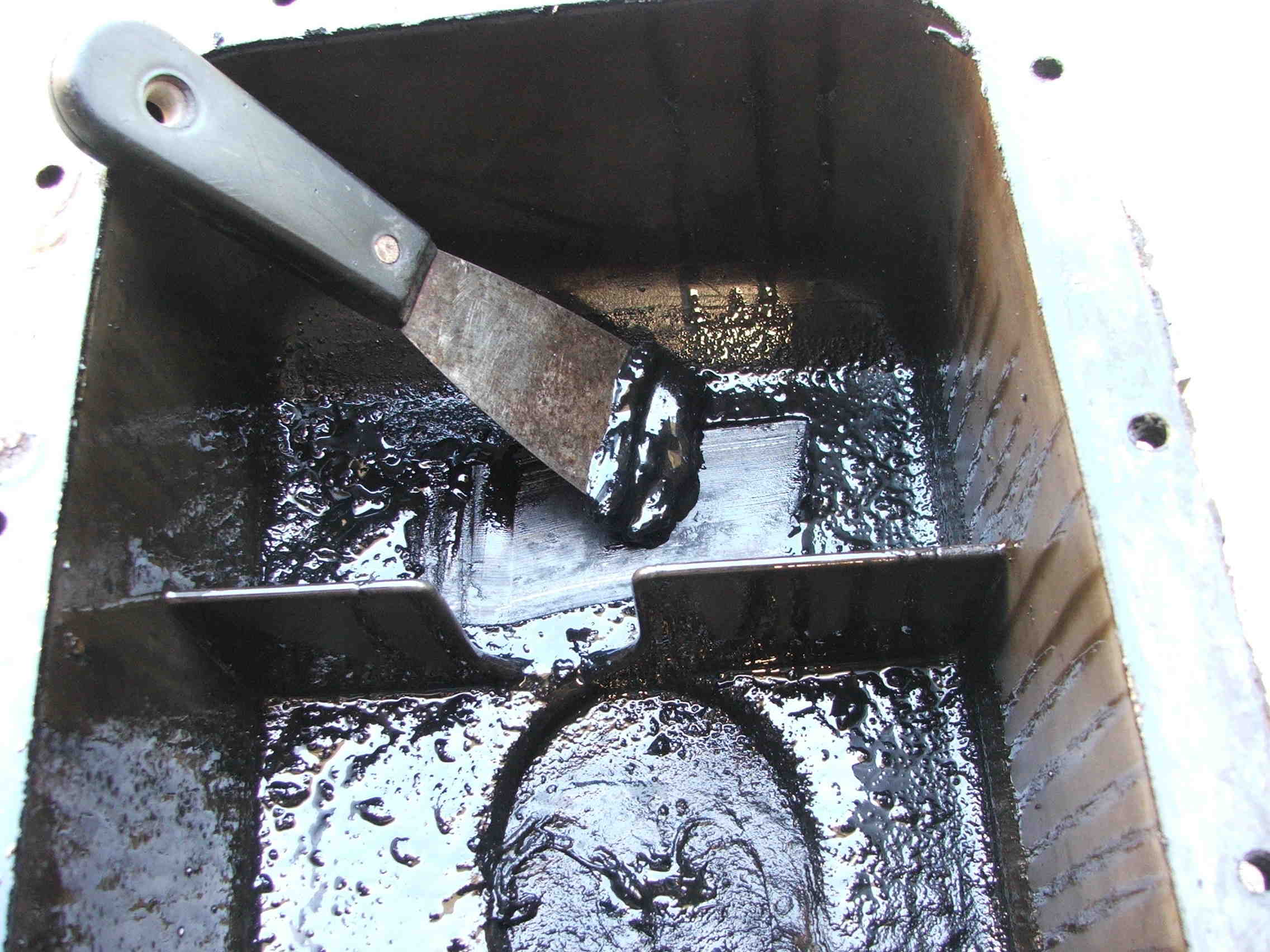

The bloke who owned this engine in the original donor car needs a pull though with brick. Totally clueless about changing the oil and using engine flush. If this poor engine didn't get a broken head gasket the idiot would have driven it for the next 400 000km on the original oil. Unbelievable !
Check out his handiwork.

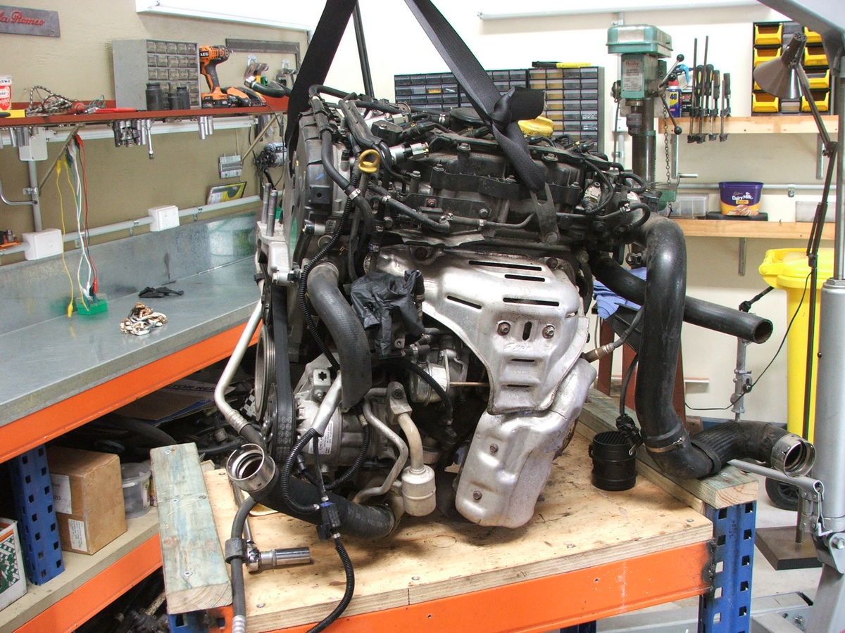

Really glad you gonna boost this engine ! What’s gonna be ... turbo or supercharge
Make no mistake their is more than enough power in there to be unleashed . What capacity you looking at there ? Edit : I see it’s 1.8 . Way to go .. just need to find out what where to get those Head gaskets the man who has no name uses .. hint some say he likes olives

I originally intended to install this engine with modified specs to do the job. Wasn't meant to be. In the present after market ECU climate basically cannot accommodate it economically for a privateer. So I am moving onto some old school technology. For now I am sitting on the fence about which way to boost but boost it has to have.

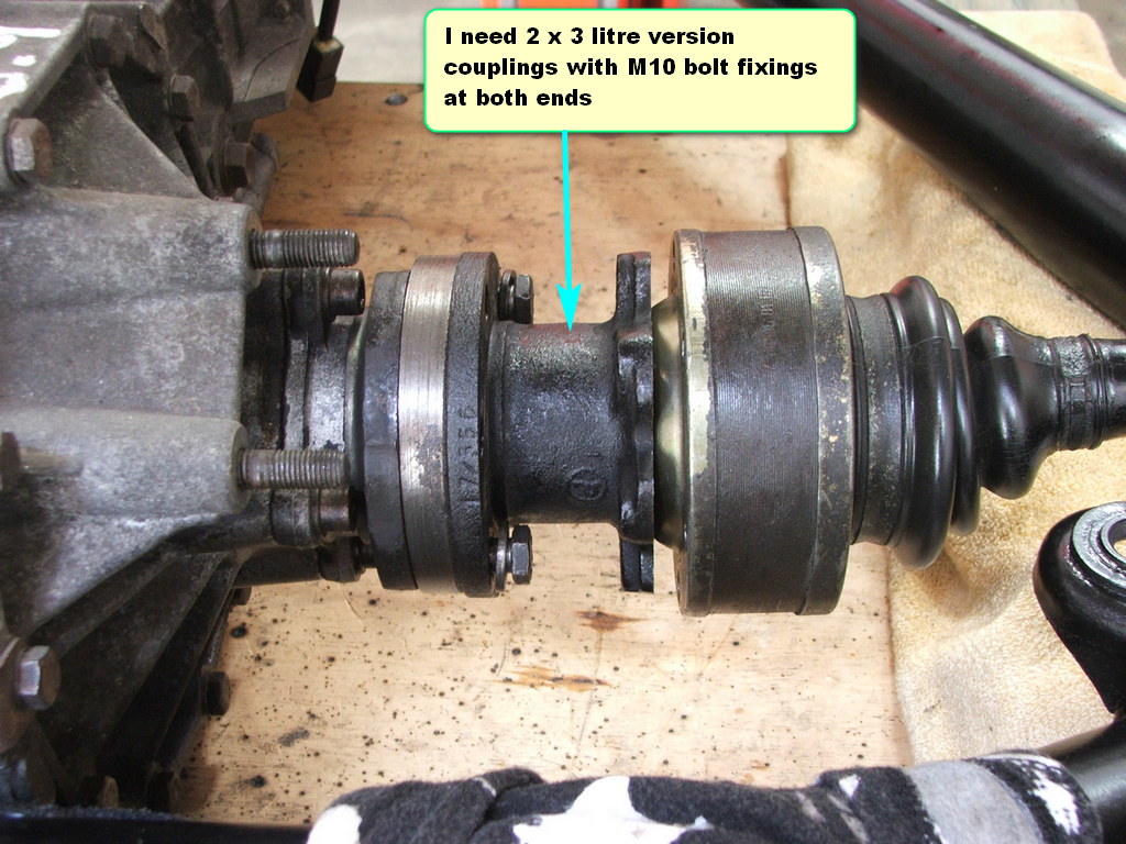

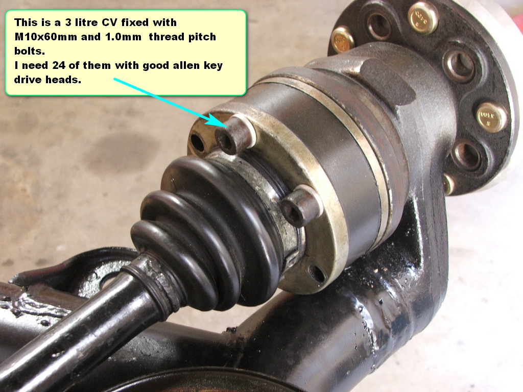

I am hoping somebody can put me onto a source of the parts in the attached photos. I've got the super ferret from Dutchland looking for me but I don't want to wear out my welcome so pitch in guys. Cannot make further progress on my transmission install until I score this stuff.
Either post here or a PM either is fine with me. I 'm thinking the US had lots of 3 litre units exported there, perhaps the US members can have a look in the spare parts box... ??

Let me ask Larry at Alfa Parts exchange if he has those. Usually people don't look for those so I'm guessing he has a bunch. Will let you know the price.

Why is it so difficult to make two such spacers on the lathe and then place on a divider head for the holes? I imagine there are plenty of good machine shops in Oz as well as suitable iron bar chunks. As for the bolts, look in most hardware catalogs. They are not the cheapest due to size and pitch but they are available. Haven't known you to give up so easily before!

Cannot say I disagree with you Jim. If I had lathe, I would do it myself. Actually one of the hardest things I have to face locally is the lack of small machine shop businesses. Everybody has gone upscale. Yeah, sure buddy we can make that no problem. Just give us your CNC codes and how many hundred thousand units do you want again?
There are many "one -off " things that I customise in the process of building my own spec racer and the absence of these facilities is really testing my patience.
How stupid is this? I can buy those Allen key bolts of the correct diameter, pitch and tensile strength. Only problem is that they are 10mm too short at one end
Searched Oz wide and no go. If I have to, I will use 10.8 tensile and get conventional hex head bolts. I think that may be possible. However the couplings have to be OEM. Our hardware stores do not sell industrial quality bolts (ie. high tensile, exotic pitch, allen head etc) Such specialist outlets are few and far between.
An absolute worse case scenario will be to install my 2 litre shafts and couplings which I have a full set of but I am thinking Alfa upgraded everything when they moved the power up for a good reason.

Oh yeah Larry got back to me he has everything email me zamaniz@gmail.com. I can probably get it out to you once they've lifted the travel restrictions.
So these M10x60mm are rare? Arethey as rare as toilet paper rolls at the store? That's pretty rare these days.
