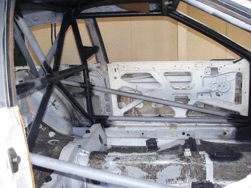

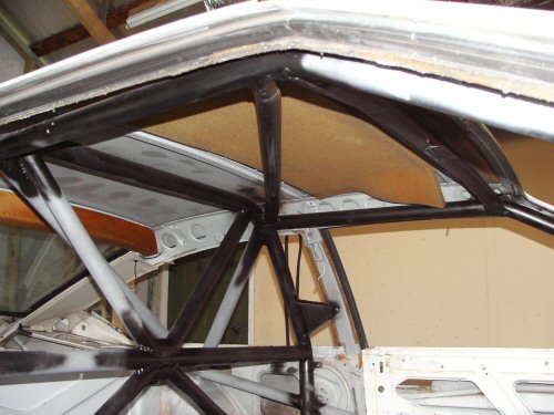

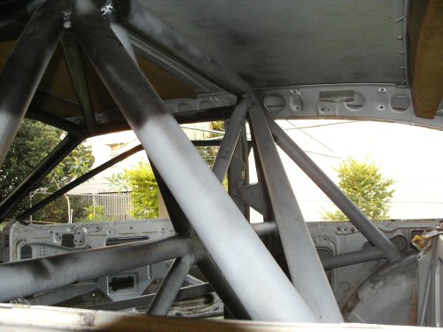

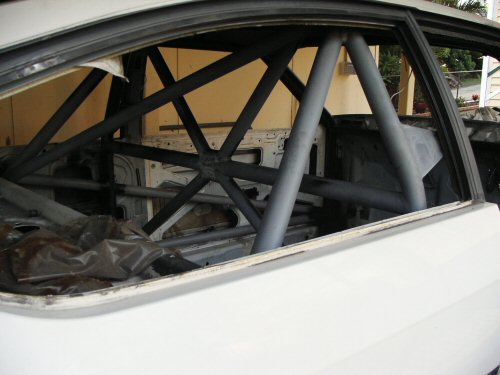

Well here's what I've done.
Like I said, some compromises to keep it street legal but definitely strong.
The A pillar is tagged to the cage all the way down including the kick panels, the original seat belt points are also tagged to the cage and the dash bar is tagged to the firewall.
Double cross in the main hoop and single diagonal in the rear and roof planes.
Upper side intrusion ties the front and rear legs together, lower one ties the bottom of the main hoop to the front legs and to the rear seat support cross member.
So here's the pics (unfinished obviously) -

Daniel, nice cage. You would pick up some more stiffness with a second diagonal in the rear window plane instead of the second diagonal in the main hoop (This is based on some analysis an aquaintance performed while designing a tube frame car), and a running a tube from the base of the main hoop to the base of the rear plane tubes that pick up off the arches should help stabilize that area a bit better.

The same bloke that does all of the work on this car did the cage - me
I don't know that I'd notice too much more stiffness than this will give me, I'm still running this thing on the street and won't be using the kind of spring rates that will shake it to pieces. Double cross in the main hoop was more for piece of mind in safety than chassis stiffness and since this car was planned around no cage at all, I think this one will give a substantial increase in chassis stiffness anyway.
