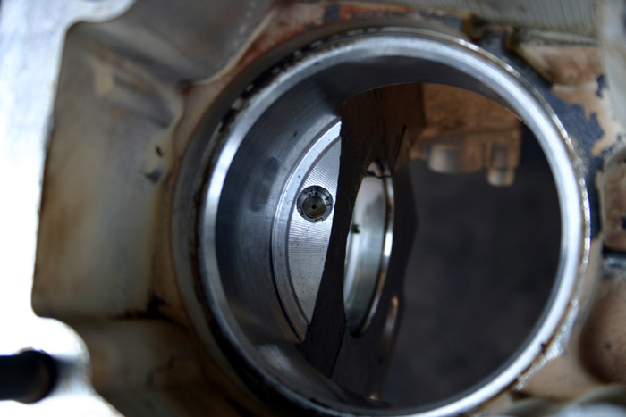

kterkkila wrote:... Shame that there isn't oil spraying holes or nozzles..
alfa 155 2,0 TS block have oil spray nozzles but any one know is it the same block as 75 TS?
