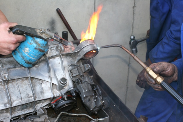

Don't you have a single press in that entire country? Welders and hammers??kevin wrote:New box . Changing rear bush.
Are you 100% sure that the clutch axle aligns with the gearbox input shaft?
Barry, Im using the LS and all new sincros as we I type into another box for the 3.2. Please dont think Im digging at you. Racing puts serious stresses on parts. Just a question B, is the pinion bigger on GTV6 box(stronger). No part is going to waste. Mats , we believe in fire on this continent. We had a puller but was misplaced. Would not noramally do this but only had today to get it in. Mats also checking alignment as you suggest.
