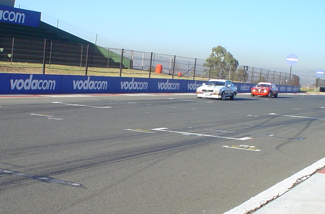

Do you have a camera installed? Your races sound very exciting, we definitely would like to watch some of your action!
Zman,it was good..Kev is being very modest here...
B, notice the car is still it bit sideways while the GTA is totally settled. I cant seem to put power down in second, probably about 7000rpm there. Third no problem. It only got 140 on the wheels.LS is in.

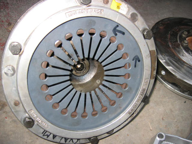

Racing tomorrow. Clutch is working properly at practice today. I made three other clutch units while I was at it . I was pretty lucky to find the correct linings which are bonded and riveted. Im running a combination of copper and lined clutch which I did earlier in the season before it exploded. The double copper is a bit harsh in traffic hence did not go that route.(I still drive to the track and hit major traffic today. Still trying to think of an excuse when the cops stops me and ask why the tyres are so smooth). Some pics to follow

Close up of the pressure plate showing the indents where the pressure plate was retentioned to give 220nm.
