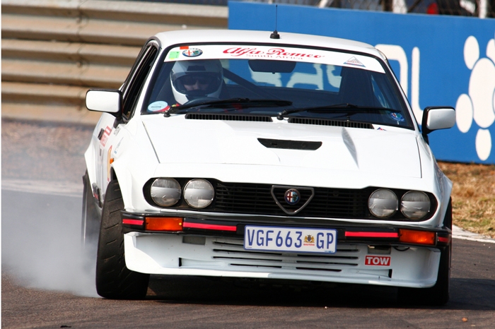

Got a pic from Saturdays race showing some more bad driving skills. Lock up in the corner due to trying to hard to make up ground. I guess racing is just like any sport as the harder you try the more tense you get, higher your heart rate which all impacts on your balance.(In pro golf if your heart beat goes up you imediatley add extra yards to that club . Probably thats why they do drug testing in golf to check for stimulants to regulate your heart beat).
Hey Kevin !! That photo is hotter than the sunny side of Mars man !!
GO KEVIN !!! :D

kevin wrote:another Image
I like the rear caliper access panels...

Thanks MD, by the way Kevin, nice pictures, wich tires are you using?? glad to see an Alfa being pushed to the limit and beyond! :D
Fed, using bridgestone re55 semislicks. MD, Mats there are a few here looking at your pics and reading your comments. Mtas that race car here sheared the CVj off the flywheel. the bolts were correct lenght. Maybe to much power as mentioned before however having said that there are a few Twin turbo set ups here that have more power but are not driven in race conditions which use cv upfront. I still think it could be a shock issue ??
