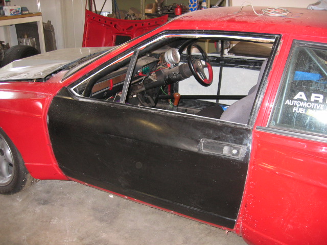

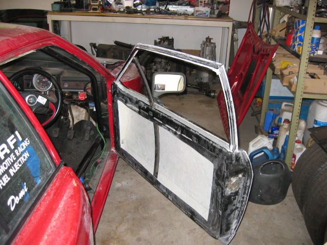

First set of doors on car and fit well. Domingoes decided to put window guide from old doors in. Im going try with out.

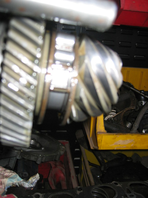

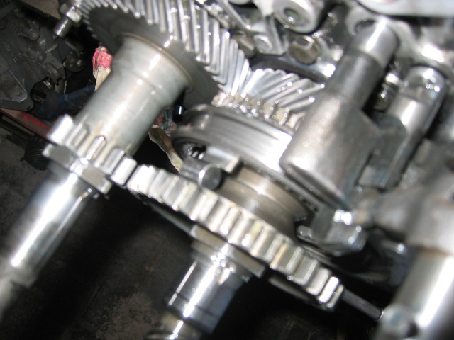

Just like MD, Im also going through my share of problems on the 'rear' end of car. Come to think of it I did not have one problem when I had a standard 2.5 V6 in and raced whole season on same clutch and box. Must be a morale there somewhere.
Even though last race was relatively trouble free I could not get car into reverse when left track to go home. Started with the usual suspects of gaerlever touching body, shifting linkage housing etc. Eventualy I pulled the box out for the !@# time and found a roller bearing from the pinion stuck in the reverse gear. How it got there is vitually impossible as it would have to travel from back of the box through a tiny hole in the central housing(miss all the gears) and get stuck. Secondly how I could I race on a broken roller bearing. In order for bearing to travel to front it would have had to come out of its bakelite housing on assembly. I guess I should have checked this box before I put it in. Got it sent out from UK in good shape. Look in pic for bearing stuck in reverse gear and missing bearings out of cluster.
