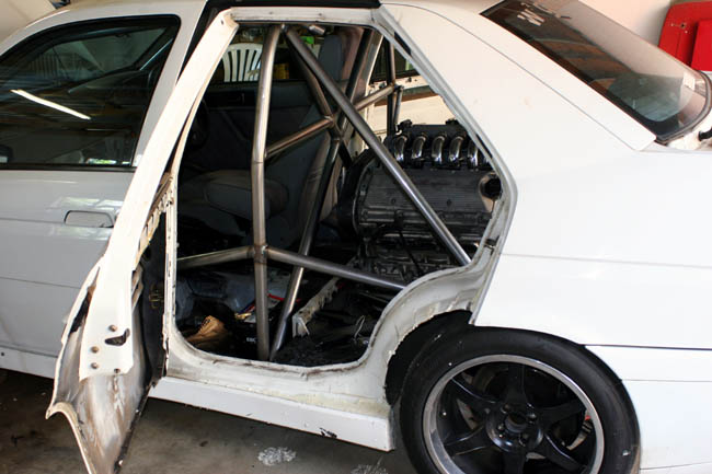

open boot

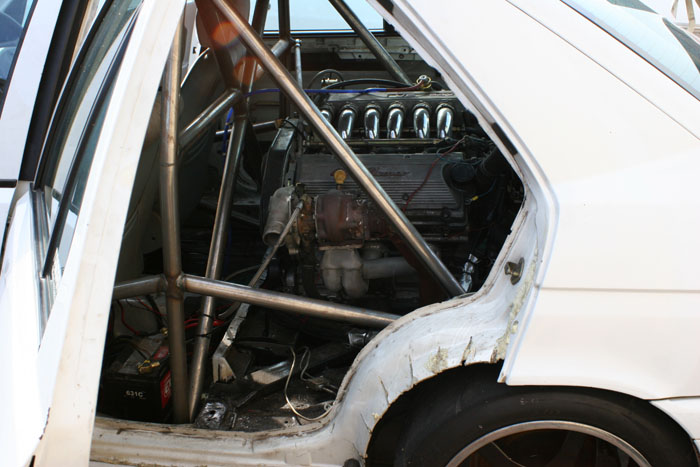

open rear door

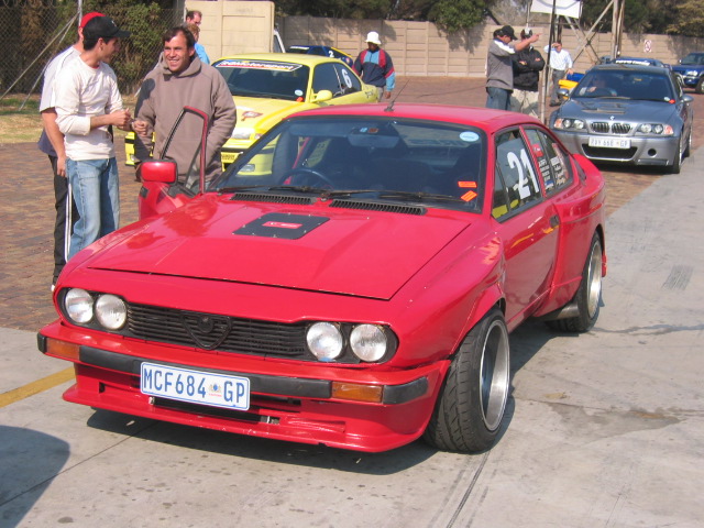

front view
nice 155
That's a nice 155! But i would prefer this one....

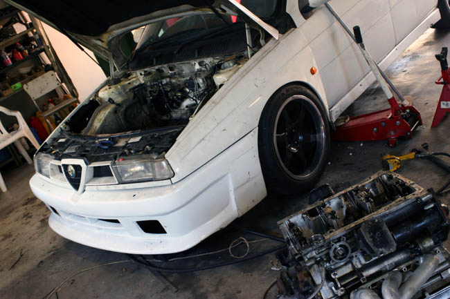

Jules good to hear from you again. This 155 is up and running without gear linkage. Going to be made this week. If you look in the bottom corner of the last pic of the155 there is a 24v tt motor with the sump off. It comes out off a gtv drag car. It ran bearings from the oil surge on pull off(major g's on this car). Will keep this thread up to date. By the way the GTV drag car is also pretty awsome. Quicker than any production Ferrari at the moment.(not enzo or FX).

That box is an Audi model 012 5 speed
As per the GT40 replica guys. (let me rephrase that, as identified by the GT40 guys in this thread: http://www.gt40s.com/forum/gt40-tech-po ... saxle.html )
Its not the transaxle they use, not really up to a 5l v8.

The 155 is coming on. saw it run today. alot of stuff is still temporary just to get it running like the rear radiator. The cage will be completed next week to hook up gearbox mounts. All gearbox shifting points are all going to be rose jointed but this is still temporary.
not so clear but you can pick up shift linkage.
Something I prefer. This was South Africa's fastest Alfa until the owner replaced it with an Ultima using a tt 24v 164 motor. This car has been standing for a few years but now it is slowly been restored. Its looking dull as the polish has not been buffed yet. Got 12v TT motor, major boost, 6spd getrag up front. It shares the same wide body kit as the other one I posted earlier. It has completed a few laps in the neighbourhood and will be track ready soon. This is my ultimate 'ferrari' project. It does not get faster, tyres cant get wider, brakes cant get bigger, gerabox cant be better, But it can get lighter.
