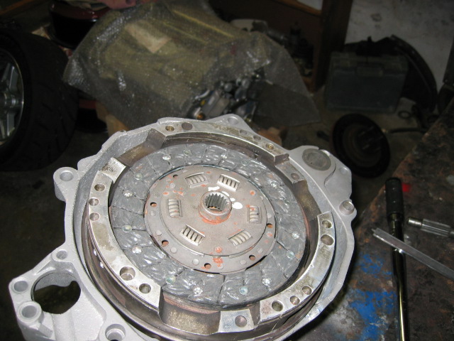

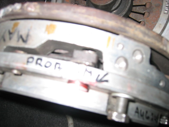

Going back to the beginning of story the car was brilliant as all clutch issues had been sorted and I thought I had the best possible oil in the box(as I have been struggling with sinchros). As in other posts i have not found the correct oil for LS (GL5) and sinchromesh (GL4). Will carry to another thread.
Here is a pic of my old clutch. One of the three pins that slide was bent from torque which prevent the clutch releasing easily. not sure if its clear in pic.

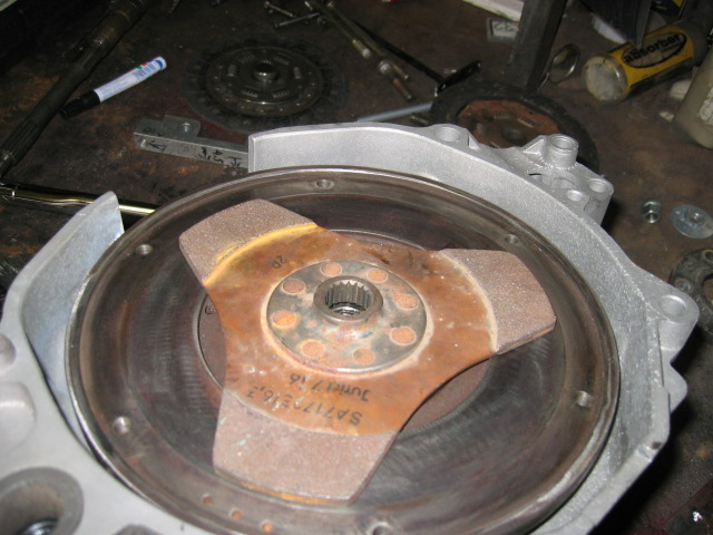

Pics of my new clutch set up which works great again. As there are no thrust bearings left here in SA had to take all my old ones and split them to find best set. Then recooked them in skf grease. Combination clutch with copper one side.

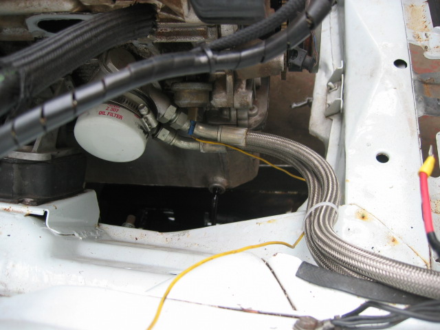

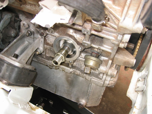

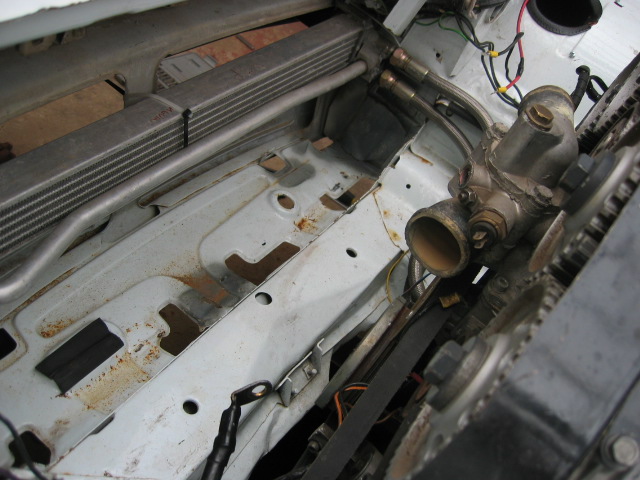

My BMW oil cooler with thermostatically controlled connector. Bit worried about Jims comments on extensive modifications on connector as I have done squat. I have just kept pipe id's the same through out. No problems in two years BUT I would like to know whats the min pressure the motor can run at (2.7 bar?)
- IMG_3323.JPG (120.69 KiB) Viewed 7587 times
- IMG_3322.JPG (94.61 KiB) Viewed 7585 times
- IMG_3321.JPG (108.28 KiB) Viewed 7589 times
Strat up pressure about 5 bar . Middle of race about 3.5 bar and worse case on hot hot day near end of race 2.7 bar.
