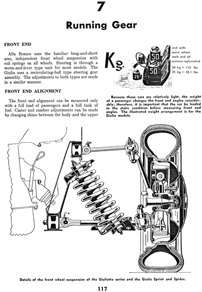

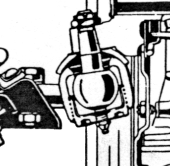

OK I have taken my Village Idiot hat off just long enough to say I respect everybody's opinion here.
Having said that, history tells me that it has all been done before. In fact it has been done by Alfa Romeo themselves. Check out the photo of the 101 series Giulia front suspension made in the late fifties/early sixties. You will see a ball joint in the exact configuaration we are talking about. It is screwed in from the bottom. Also remember that this is for a road car too so even more caution would have been required.
Now if it was good engough for Alfa, it is good enough for me. So yes, I does need a specific type of balljoint and the bottom arm would require modification as does the upright to properly seat the tapered bolt but hey, it's not rocket science. It is however a lot of pissing about and I can't see it getting too many takers.

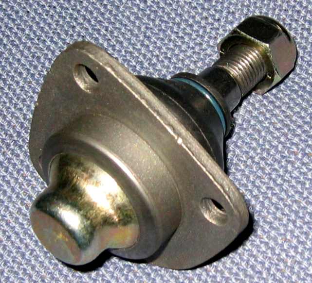

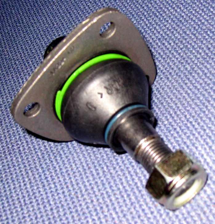

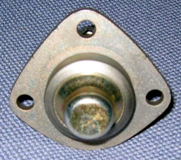

Today I can post something constructive for a change.
As we're about to start fabricating the tubular A-arms tomorrow I sourced some new upside down ball joints. The same as I successfully used the last 10 years.
Lada 2105 (or any rwd Lada).
Price €7,- each.
Lada ball joint 1.jpg (60.52 KiB) Viewed 11700 times
Lada ball joint 2.jpg (72.42 KiB) Viewed 11698 times
Lada ball joint 3.jpg (48.64 KiB) Viewed 11699 times
Price €7,- each.
as my county is ex comunistic we have shitloads of ladas here :lol: from friends that tuned lada for rally i know not to use old stock items USSR made ..they often are build with very poor quality ... i too have 2 of those but trying to fit in stock alfa lower wishbone is no worth the effort ... better with lighter cromolly or SS fabricated ones
Micke what brand are those?
Beats me! Western writing anyway.
For 7,- a piece swapping them now and then doesn't destroy my account very badly.
O! Found some writing on the bag:
Redaelli ricambi
Made in ITALY
