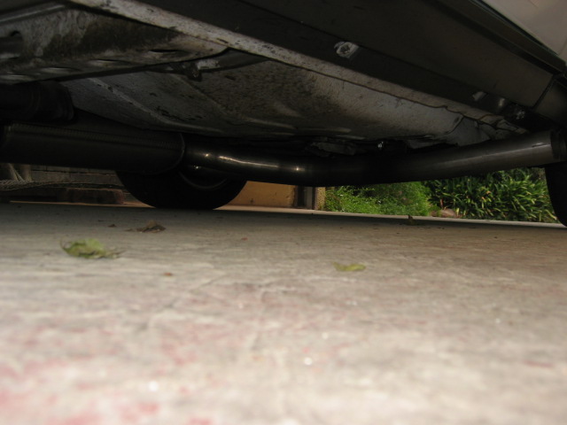

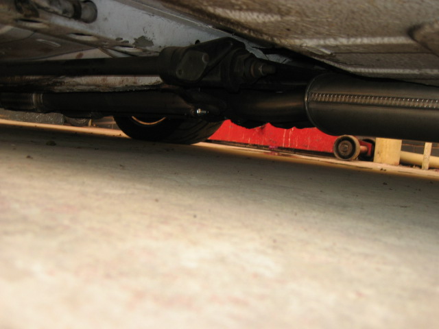

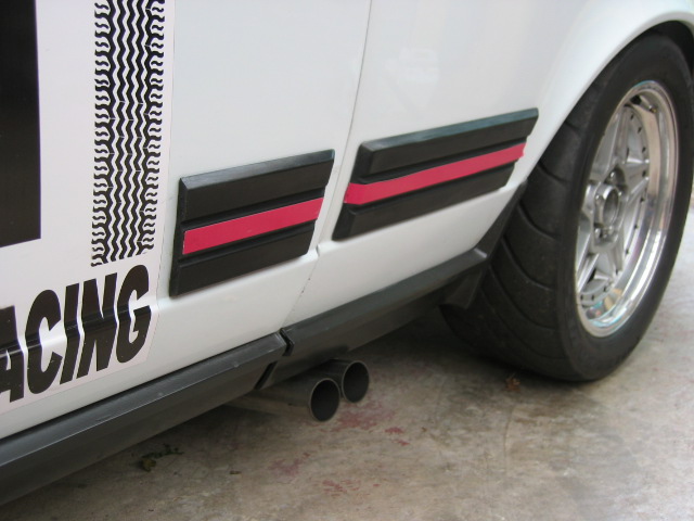

Thanks MR 2, got radiator in. I have left whole open in 3.0l bonnet and got a shrouded fan which I am also sealing onto radiator around sides with rubber . Will find out only next week if its working. I meantime I have moved exhaust to the side with one box. Now my CV boot and rear caliper temps will be same as right side. I used two 50mm pipes from from headers through flexi, through 500mm box and out side. Just need to heat shield plastic on lower cills. Must say the sound is totally different.
For front of car been unstable under braking with full slicks i am going to reduce tyre pressure again and also recheck my toe under bump steer to see how much variation there is.(method in Track and Race Magazine).

Probably should have put box under gearlever section but was running out of time. Must heatshield above box to protect rear coupling. Maybe thats not an issue.

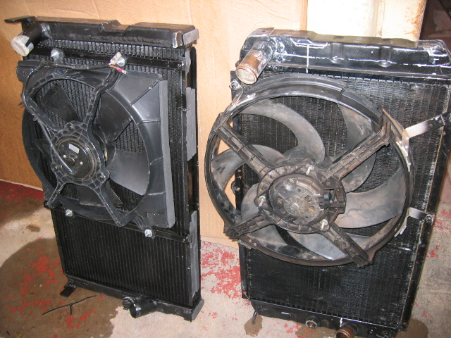

Pic of old vs new radiator. Sealed up all the sides. Mats do I need more

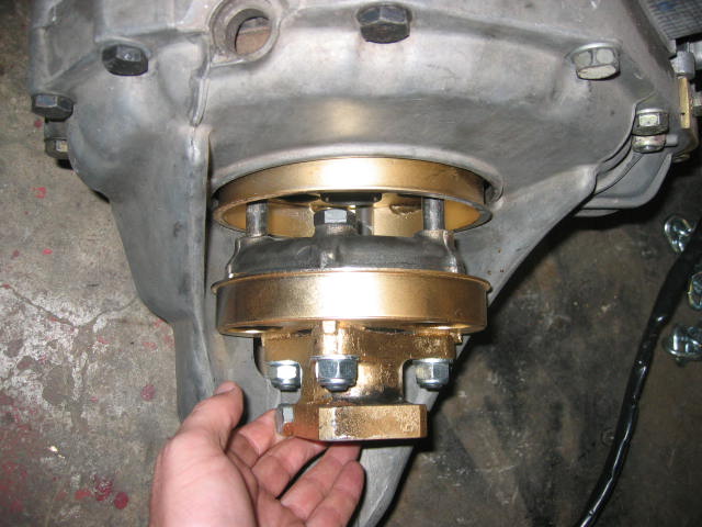

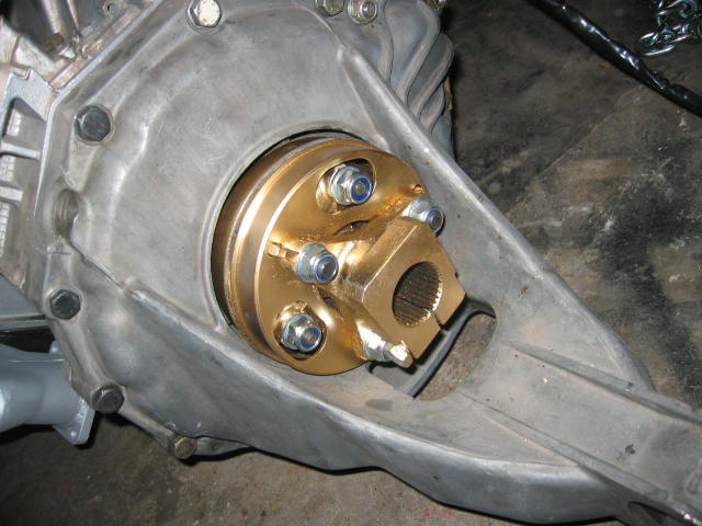

Hey Kevin,
Could you post a pic of the cage for the driveshaft coupling that you make and use on your race car? I saw in Fernando's engine mishap thread that he got one from you. My 3.7 race Milano is mechanically done and I expect to run it next year, although cosmetics are still lagging. I still have some sorting and the driveshaft is coming out shortly. I'm thinking that perhaps adding a cage to the front coupling would be worthwhile (besides or instead of the 3-ear reinforcement plate).

Quick tip on the radiator install.
Be sure to plug off ALL other holes on the sides of the radiator panels to force all frontal air going to engine bay through the radiator.
Use distilled water and a 50% ethyglycol mix to increase the boiling point.
Be shure you have the correct pressure caps fitted.

MD, thanks will close up side even though there is a tiny gap . Good point on distilled water . I have started using Water Wetter.(google it). Temp got to a max of 85 on a very hard dyno session tonight so very happy about that. Then again there was no boiling hot track under car or 'traffic'. The power is up 13kw from new intake plennum, new intake pipe and new exhaust and nore mapping time. max power is at 6300rpm, 34 deg adv with 205 horses on the wheels at our extremely high Altitude. I would say base on some calcs (kevins calcs) that this would be +- 300hp at sea level on ENGINE not wheels.

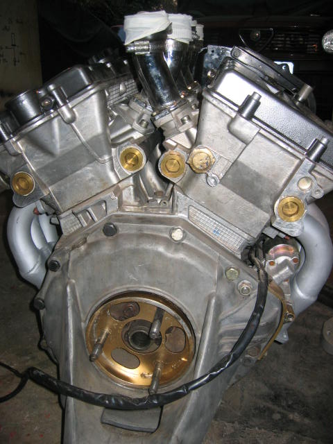

Jes, the cage stops the coupling from expanding and also limits the flex which is still huge. There are no more cages left. Only made enough for me , Baz and Div.

Thanks for the pics. As they say a picture speaks a 1000 words. Hmm, any chance Dawie has some left, you think?

Those look really nice! Someone will have to step up to the plate and have a dozen or so sets made up.

I would definitely like to get the cage for the donut.
