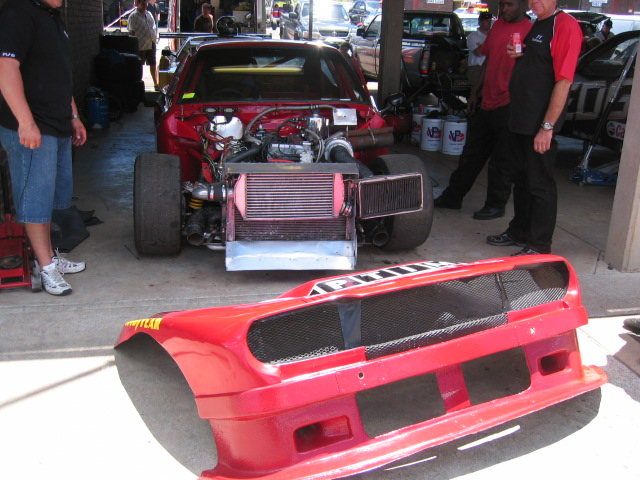

Now on to racing. Went out to track for qualifying today and there it was the 500hp twinspark GTV. This has to be the fastest 2.0 Alfa GTV track car ever. After indepth conversation with owner I was amazed it ran for five years producing 400hp with an Autodelta straight cut gearbox at the back. He did brake a few bit still got him many race wins until he finally moved box upfront . This is wat I am after or to make - a straight cut Autodelta box with the heavy external webbing.

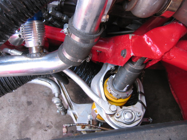

More input.
You say the front moves left then right, is that all? Two moves?
Do you have anti-knockback springs in your calipers? Curb hopping can make your pads move away from the discs pushing the pistons into their bore. This can make your brake bias left/right if one side makes contact before the other side...
Might be worth a thought?

Mats, yes two moves. Another thing I have noticed if you are travelling at walking speed 5kmh and you suddenly pump the brakes, the steering wheel rotates just as quickly to the right. Its just a fraction of rotation. Now this does not happen all the time. I noticed this sitting in heavy traffic on my way to track in rush hour on Friday. Picture this race car packed full of tools , four spare wheels etc and driver with duct tape stuck on his ears because short exhaust testing brakes. Normally the back up 164 does transport tools. Anyway got to track, checked rack(steering) was tight,calipers tight, no play bearings or any suspension bushes. So maybe right pad biting before left. All pads have equal wear. Braded hoses as well.
Maybe that has nothing or every thing to do with it. This race we just had , had no serious curbs unlike last track come to think of it. Just thoughts.

So it happens every time you apply the brakes?
New prime suspect, left front wheel bearing.
Kevin,
Question : do you ever get a brake pedal that varies in height before it pressures up?
I you do, the wheel bearing is not fully home (usually the inner) causing the rotor to shift slightly from side to side based on turns and this causes caliper piston movement that tries to track it.
This can happen after new bearings have settled into their housing following renewal. It's happened on my road car but now sorted.
MD, There is zero play on bearings which I checked at the track. Right now the car is locked in the back of the garage so i cant go near it until the work year is up(15 december). I got to force myself to do some work some time as I aint going to afford racing next season. I am going to then jack car up spin wheels and watch carefully and then start stripping the side until I find problem.
