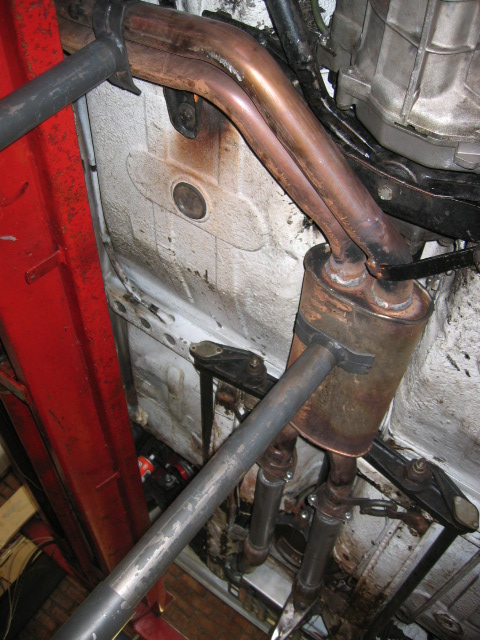

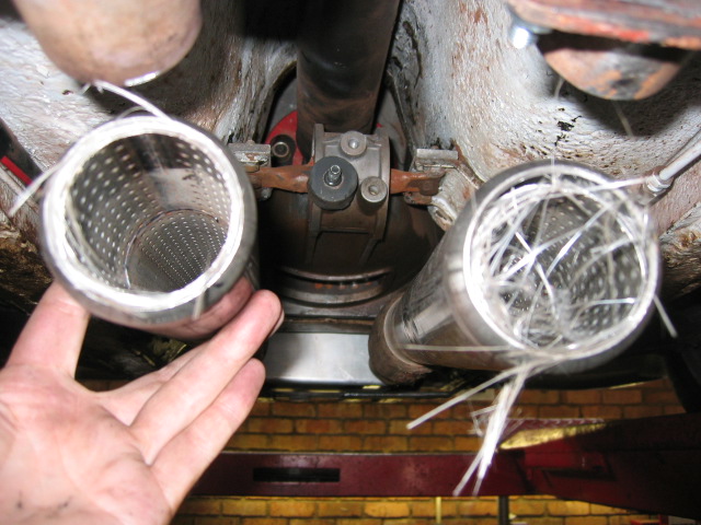

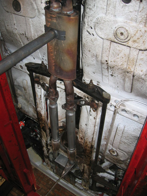

Basically got a 50mm perforated pipe and wrapped fiberglass packing around it then put a 63mm outer pipe over it. Made two of them 400mm long. Car sounds quieter but still dam loud . There is only space for one box and ground clearance is an issue. Pics to follow

Your cops are friendlier than ours - we would be royally reamed for the side pipes, let alone the volume. Is the muffler a common chamber or separate all the way through?
Jason
1983 GTV6 2.8 litre
1983 GTV6 2.8 litre
GTV 27, the muffler has two pipes straight through and the they are wrapped. It is in a common chamber but there is no crossover effect due to the wrapping. I have tried to read up if the v6 needs to have a common chamber and feed off one bank but due to no conclusive evidence I went with two seperate pipes. I have gained another 13 kw but that due to many other factors ie mapping, new intake, Short exhaust but i ave not gone backwards.(same dyno). The car definetly has a very different sound with two individual pipes.

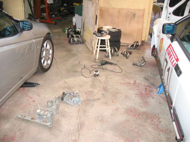

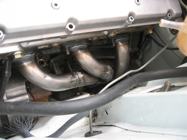

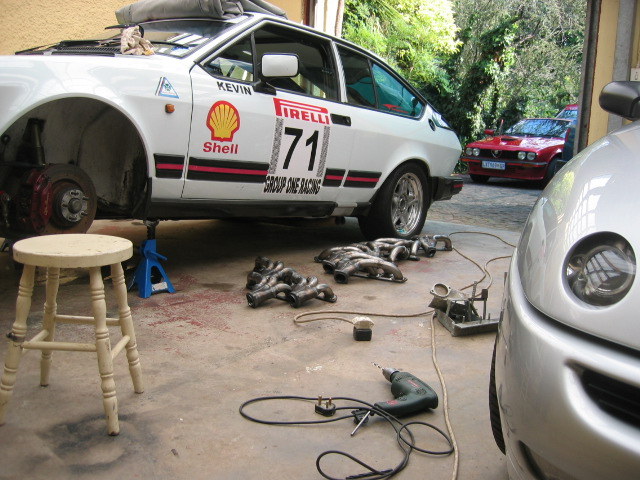

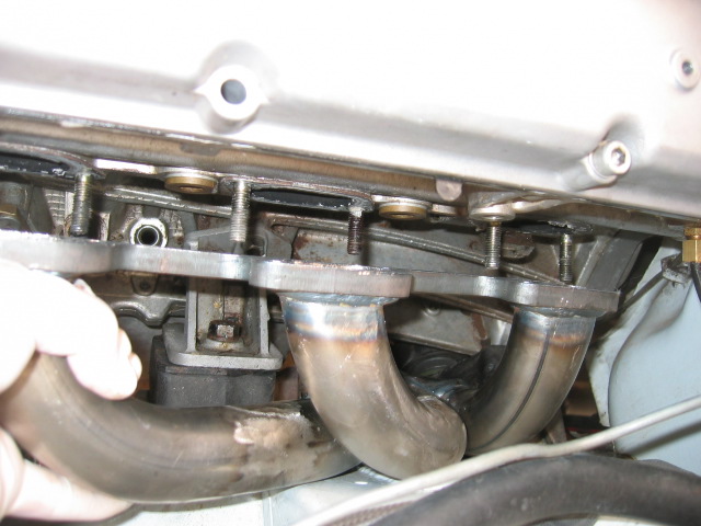

Had the exhaust off today checking all the headers I had made to make sure they are all correct. (I swear this is the last time to make these.) These headers fit easily with studs in heads excepth on right bank the no 3 pot, the studs need to be slslightly shorter. Some other pics off templates etc

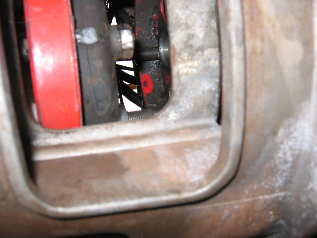

Looking for some pics on rs rear anti roll bar on 75 or GTV6. I have an origional autodelta adjustable one which I bartered it from Barry. Whats the easiest way of puting one in as I never have thought about taking it out during the countless times I have removed the gearbox. Its one of the last things to complete this so called budget race car. Touch wood, reliability has been pretty good on last two track outings. Big race tomorrow so hopefully can get footage as taking video camera along.

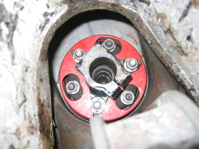

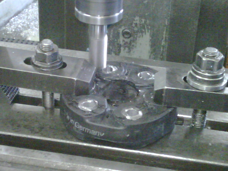

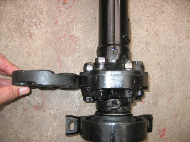

Good news is I have done my first propshaft inspection after a year of racing(with the 24v motor) and the front coupling is looking as new as the day I bought it. The coupling cage has proved an absolute must for reliable racing. Also this same prop did two years on the 2.5 motor.
Conclusions. The prop can take an absolute beating with the cage. No need to modify anything. Having said that my centre coupling was looking rather tired so i ahve replaced it with a thicker BMW one which is 28mm compared to 23mm.
My first plan was to machine the bm coipling down but after finding hidden spacers around the tubes under the rubber this proved impossible. The spacer just ripped the rubber open. I did try various machining methods which did prove dangerous after dodging a flying coupling coming out the lathe!!
I ended up cutting 5mm out the prop and welding it up again(proffesionally done)
Here are some pics of condition of coupling and my second method of maching down coupling.
The bm coupling is far superior as it should be with 20yrs more development than the old alfa one.
- coupling inspection.JPG (78 KiB) Viewed 6974 times
- bmw centre .JPG (120.07 KiB) Viewed 6977 times
- machining coupling.jpg (125.03 KiB) Viewed 6977 times
If I could have got an Alfa centre coupling in South Africa I would have used it but as no supply I used the bmw one. Only reason.
- IMG_2947.JPG (112.49 KiB) Viewed 6972 times
So Kevin, you got an original Alfa Coupling in the front in a cage. A modified BMW unit in the centre. What's in the rear of the shaft?
Rear is standard Alfa coupling. I dont jump kerbs when racing and get the wheels airborne as coming down breaks cv's and couplings. Thats the only area where I am conservative other than that i am fourth fastest of forty cars. I know Barry put one of those cage on the rear coupling which is a good thing to do.
