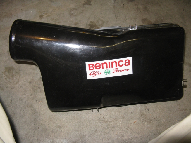

Z, now we are talking. Thats what I am going to do with my current set up with the big plenum. Thanks for pic.
that beninca airbox looks sweet!!

I think it costs AUS$350 with hose and clamp, but may not include the 4" aluminum adapter. You need to confirm with him. If you're buying from europe, I think it's worth it. It will be less than $250 euro.
I thought about modifying my own airbox, but a lot of the shops here charge US$100/hr. So if it takes 2 hours to modify the stock airbox, then that's $200. Then you have to budget for "mistakes" done by the shop who looks at our cars and say "hey is that an Alpher Romero or somethin'? What is that, an eye-talien car? ".
**** that!
Why not buy from someone who has sold so many of these boxes which are known to fit? Makes more sense.

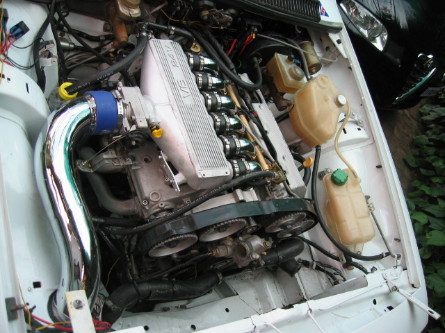

Hi RZ, hows the car coming on ? Z, I am going with this similiar intake of race car on the 3.2. This intake must work as my 3.0l is one of the strongest 3.0l 24v on this dyno and all its got is the gta 2 spec intake with the gotech. Ok so the power only peaks up above 6000rpm(which is normal). I got some interesting data from the dyno room as mentioned on my cars where power occurs with the particular specs. Must say my 3.7 is not nearly as strong as yours but then im an amateur. Its got huge midrange.
If you dont have individual throttles there is huge power to be found in the plennum and intake as I found . Hence watching the other thread closely. I am gonna bigger than this one.

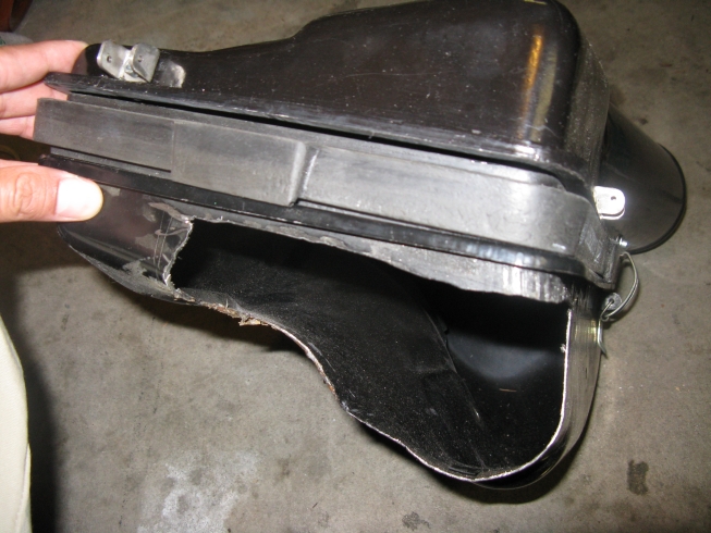

Kev & RZ,
The lower airbox should be opened up too, I will post some pics of what I did. I like the stock paper element for longevity of the engine (better filtration performance). I think the flow may offset the slightly more restrictive nature of paper filters.

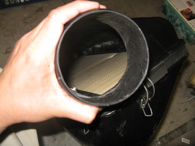

Kev,
Here are some photos of my lower and upper airbox:
For the lower airbox I made a HUGE cutout. At a later stage I will form some sheet metal to make it look nicer. I'm getting air from the sheet metal which I cut off from, right beside the radiator mount.

hi Z,
my airbox was cut the same way.
i ordered the lid from beninca.
i hope this mod will bring me a 100 HP

350 aus $ plus shipping 120 aus$ =$$$$$
Whoah, If i convert that to our banana currency I could buy another GTV here.

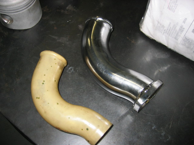

Z whats the intake size. have you a few more pics ? Check out these runners 48mm. They are going to be moulded in plastic. Dont ask price as they are not available and who knows which set up they will benefit until testing starts.
