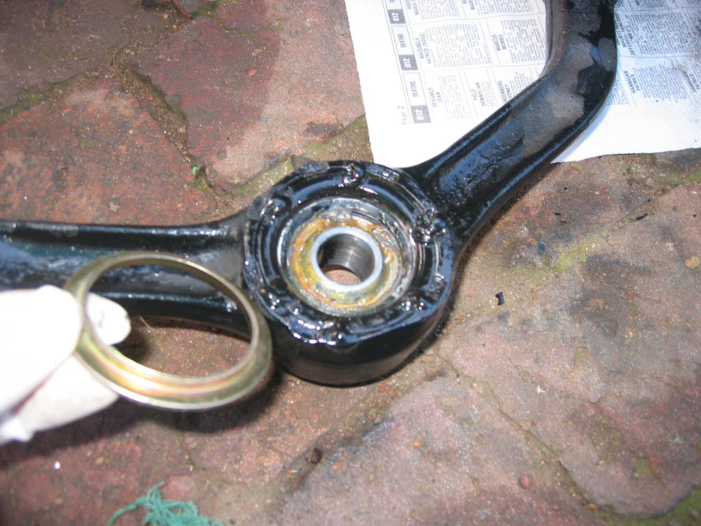

I bought a spherical bearing centre dedion bush for the race car from RS racing. I have just removed my polyurethane one which I bought from performatek and after three years of track racing its still perfect with no movement(wear). Upon installation of the new RS bush I need to know from anyone who has done it what did they use for spaces to stop the RS bush from moving in the dedion. The origional alfa bush has two aluminium rings. Do I use one of these ? I know its a press fit but soething must hold it in position.

It's a press fit from the top. If it wants to move it will move down, and you can't fit the bush through there ;) The two spacers you got with the SZ bearing will keep it firmly locked in the beam.

Dennis I pressed it in but there was still a 4mm gap so i put one of the origional(new) retaining rings in and put four spot welds around edges so bush cannot move in the dedion. I understand the two spaces keep it firmly in position in the cross member but that will not stop it moving in the dedion. Reason why I spot weld the ring on top as it was easier than hammering the edges in in. Sadly this was all done before I read the post but im sure all be ok.
pic of spot weld with rs bush in and type of clip used.
spacer ring.JPG (133.55 KiB) Viewed 7038 times

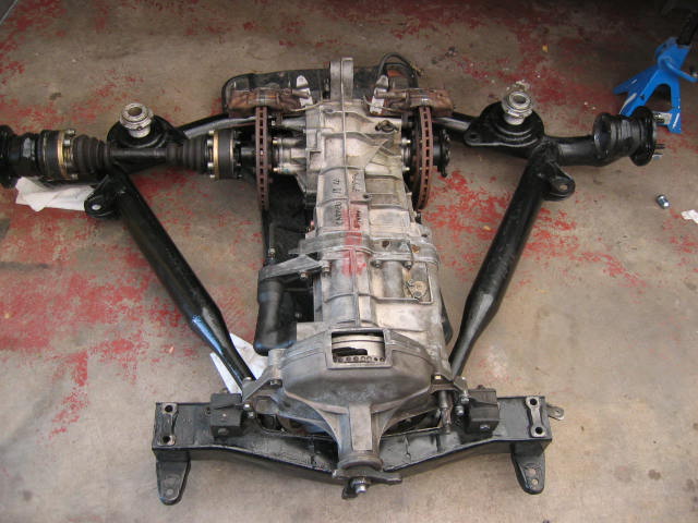

Tried assembling the whole rear including adjusting brakes before putting the dedion back. Its much quicker but you need another hand to balance the gearbox on the jack pad to raise it in to the underside of car.
Ok, now I finally understand why you guys need so much differential lock.
You are one halfshaft short of a picnic...
Hahhaa. The Mats does it again ! If I were you Kevin, I'd get the fire extinguisher ready NOW cause the guys aren't gonna let you off without arse burning jokes for a while...good time to take that holiday to OZ now buddy.. :D :D
Just goes to show those Sarrf Effricans can run with one halfshaft tied behind their back....
