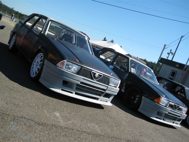

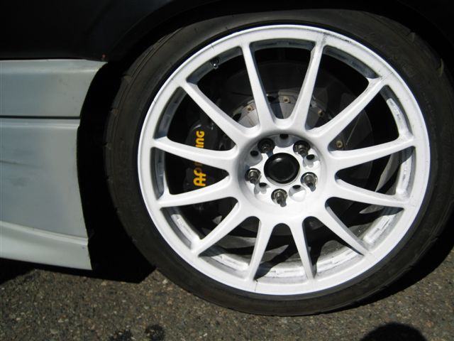

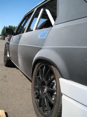

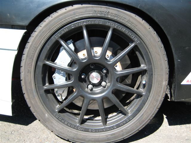

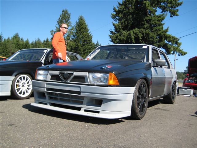

So - I don't understand it (and yeah - I could have glued a video to my car), but in the days leading up to all of this, we arguably had a bit more to think about than mounting cameras or who would be holding a video camera track-side...
Sorry guys - no video of the two 3.7s then I guess. Still, here are some pics; mine has the black wheels & black dials and Jes' has the white wheels & silver/white dials... Brad's blue car is the hot 12 valve 3.0 with the wing and Keith has the red 2.5 with the serpent on the side. Chris' is the black 2.5 with the snow-plow upfront and big gay wing on the rear as well.
