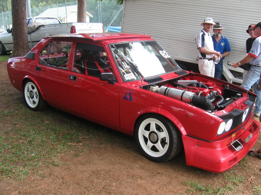

The snow plough is my comic answer to the wank factor of jet sized wings on cars.
Gotta admit, it gives a four door mum's taxi some attitude don't you think !!

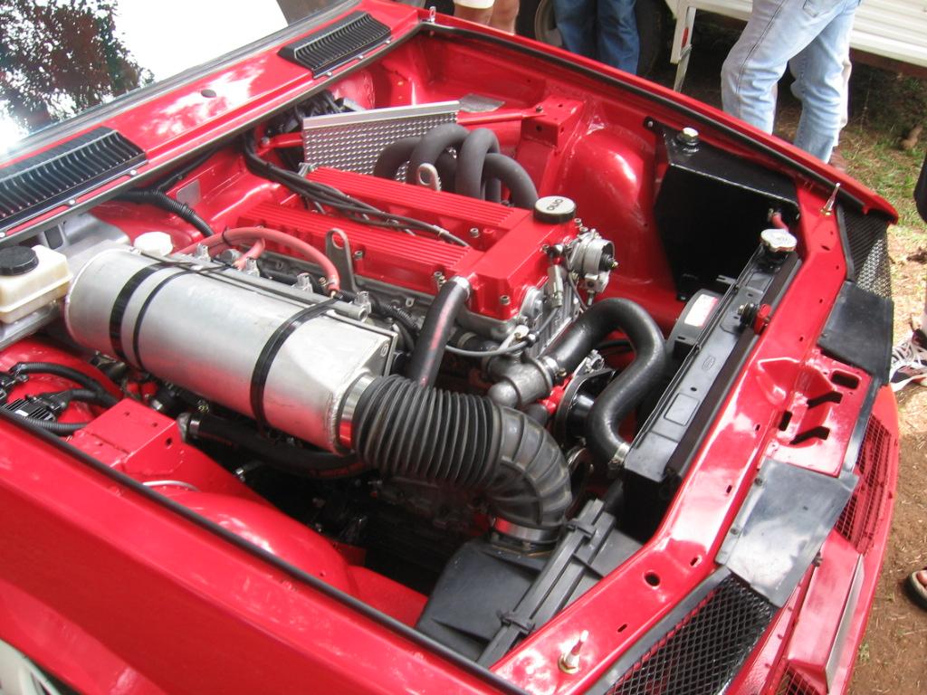

The headers look like a piece of cake but it took three days of work to fabricate and get the tuned lenghts just right. I hope you like the way I managed to get the system between the firewall and the steering rack cross member instead of under it. I don't know why Alfa didn't do that in the first place.

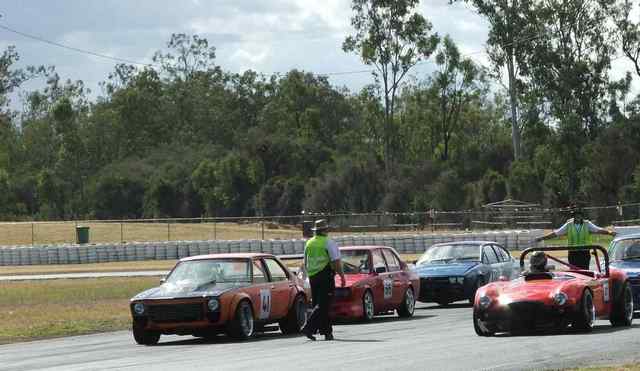

Had our second outing in the Brick at Queensland Raceway yesterday. Bit of an anticlimax. Car generally going well but discovered it has a mystery oil leak from the transmission. Yet to get it on the hoist and track the problem down. Also still sorting out rear damper/spring rates which don't seem to suit this track at the end of the main straight that has a a few camel humps for a surface.
To keep things as Alfa as possible using an original split dash tacho. This fella wants a completely different signal to the output of the Motec and so there is an electrical issue that I need to sort out too but we are making inroads to that so I am confident we will solve the problem. Living on the shift light at the moment..
Here's my mate Jacko gridding up..
- Brick Griding up 2nd Outing.jpg (28.46 KiB) Viewed 7922 times
