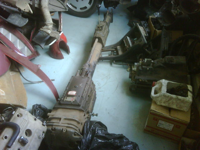

Engine pull this weekend to remove sump. Tooks some pics of some possible gearbox conversions.
- IMG00947-20100318-1337.jpg (51.71 KiB) Viewed 7161 times
