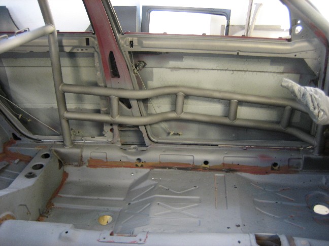

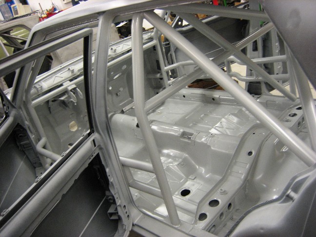

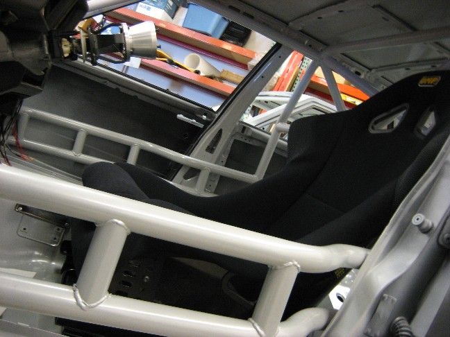

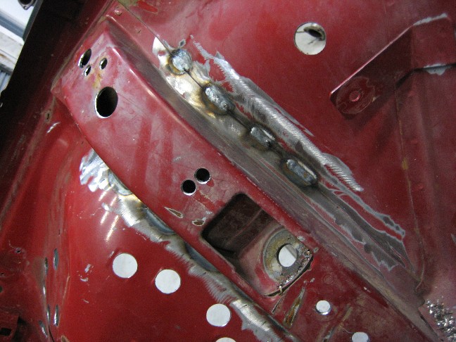

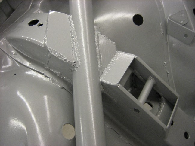

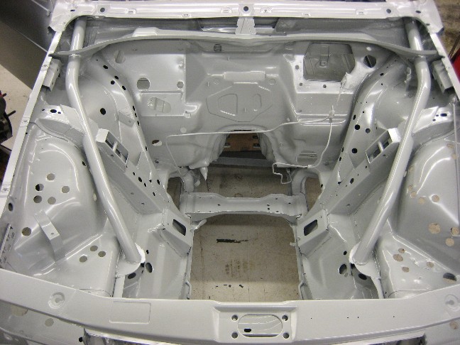

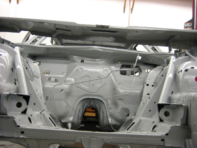

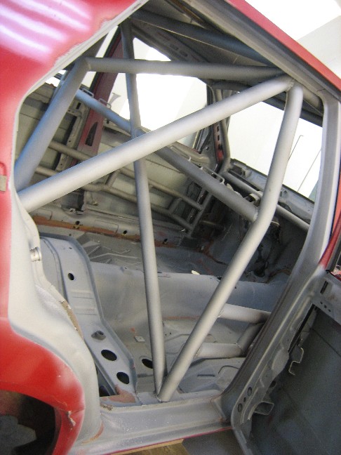

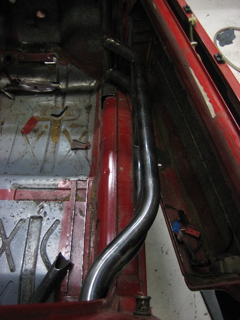

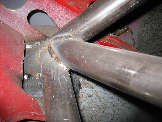

Cage in various stages of completion...
Also, stitch-welding details, corners before gussets, engine-bay reinforcements (similar to Jes' car), "NASCAR-style" door relieves (for the fat-guy) and the upper-shock mount strengthening (for coil-overs and no torsion-bars...)

Few more...

Ah John,I see you had to kink the cage at the doors so your fat ass will fit... :wink: :D :D :D :D
Nice project bud..Are you not impatient to get her done?
Not trying to bash your obvious serious project or anything but why did you bend/kink the pipes in the door? Looks like it will make the bars "softer" in an impact and the mechanics involved will try to bend the pipes inboard hingeing around the main hoop and push that part that goes next to the B-pillar int yuor torso/pelvic area. Not nice.
I know they all do it in CRASCHCAR ( :wink: ) but I have never seen it in any other series (or country). It would not pass a tech inspection here.

Not to mention they don't add a whole lot of stiffness?

A comment on the stitch welding and cage.
To do it right you need to do > 50% welding. And not only on places were forces are introduced! But along the path the forces take into the chassis.
The same route I would take with building a cage (steel in the path off the forces).
Primary: A cage is there to ensure your own safety.
But a well designed cage has also the steel in the places where you add stiffness to your chassis and still ads a minimum of weight.
In the real world everything is a compromise so it is not that simple.
But just adding sturdy tubes doesn't help if they are added to the chassis on a thin membrane or act as a hinge.
