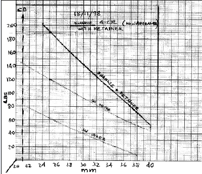

DON'T USE THE DAMPER COIL. I don't know what they do in the US, but for AR engines the triple setup is exceptionally nonlinear and more than 210lbs at 10mm lift (way too much)! I've used these sets over and over again without the dampers, in same and opposite wind coils, no problems ever. For high perf use, aim for seat pressures of 85-90lbs and 185-190lbs at 10mm lift. These measuremants are made using the std AR retainer (most retainers have a 2mm step for the inner spring) Make sure your installed height allows max valve lift plus 1-2mm at least before coil bind.If you want the whole curve just say so and I'll post the numbers, or (for a schnitzel) the graph! :lol:

Ok, I is a man'o me word but its almost midnight now, will post the graphs tomorrow (std AR springs and hi-perf ones from Arricambi) What do you want, 4 or 6cyl?? (they're different)

Anyway, I found the graph for the Arricambi (Shankle) 4cyl springs, but not the std ones. Don't worry, I got the stock numbers and they were exactly where the Shankle catalog said: seat pressure with installed height 35.5mm = 80lbs and pressure at 10mm lift (ie 25.5mm height) = 160lbs. Very important for high lift cams is the coil-bind height which for the performance springs is 20.5mm, in other words you can have up to 13mm safe valve lift!!
Don't bother with the two curves under the final one. They are the inner and outer spring graphs. They will NOT add up to the higher curve, as the inner spring is compressed 2mm by the retainer.
If you have lightweight valves you will logically need a value in between std and high perf, but it all depends on your max revs and cam design (specifically the acceleration features of the lobe)
Sorry for the quality guys, it is readable if you're determined enough!
