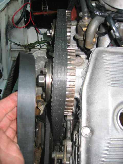

By the way check out the pic of the worn belt.
Belt migration...not good
I expect the crank and cams are parallel, how about the idler/diz?

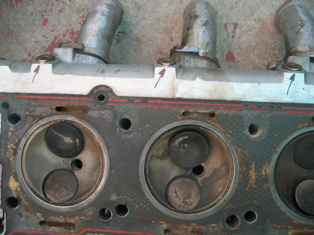

X-rad, found the problem with the belt migration after much" pain". The right cylinder head was skimmed at a slight angle by some useless engineering shop. As I bought this as an abandoned car I would have no idea who did it anyway. I will post a pic and you might see the angle it was skimmed by the different heights on each copper plug. Got a race this weekend so I got some busy nights ahead this week.

I would have checked that last...hope you got enough metal for an even shave(or another head)!
I am guessing you checked both sides?!
Got spare heads which i will use. It was only one skimmed skew. The Budget car is costing me time at this stage but I know there is no such thing as cheap and easy motorsport. The 3.7 is making good progress.

What are we looking at with the picture of the two belts? I'm guessing that the uneven head caused the belt to twist a bit, but what else?

Grant ,the two belts was just showing a comparison between the worn one(from touching belt covers) and a new one.
