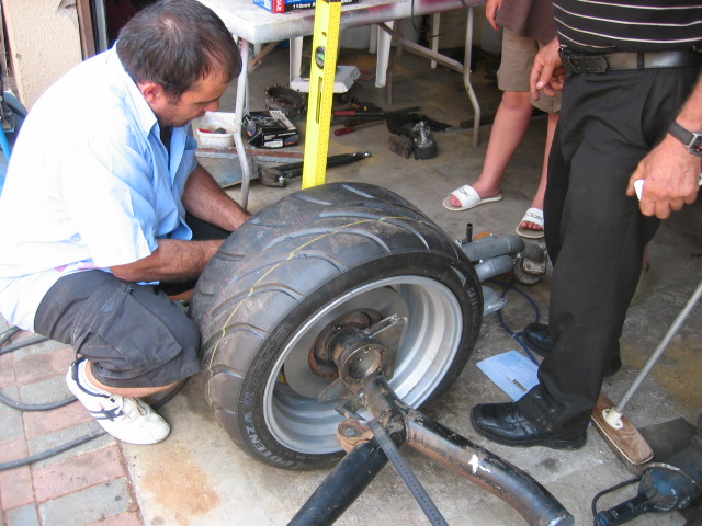

MD, good news is the owner(Joe) of the monstrous TT GTV6(which was South Africas fastest GTV) is back in business after breaking his back. So the Ferrari inspired gtv is back on schedule. Sadly both turbos rusted in this period so it is start again time. His brother has not missed a beat on the mad 155 mid mount. They have just remade the rear dedion with a slot in it to lower the gearbox. Pic to follow
- IMG_2906.JPG (127.01 KiB) Viewed 8584 times

Kevin, the picture of the de-dion, is he using the original shock mounts for coil-overs?

Bruce, yes he is using origional point. I took a video of it in the car today . Will post it after new year.

Bruce, correction , the rear shocks are not mounted on this new dedion on shock points. We were wondering today if a shock broke what would we be the best solution to creat least possible damage. Good soulution was to put bump stop between gearbox and dedion so the car can atleast rest on something otherthan the wheels.
When my coil over shock broke my car fell straight onto wheels(wheel arch) scary thought if it was at speed.
