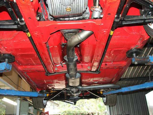

The Brick runs a Motec. Apart from the engine bay exhaust which you will find on page 4 of this topic set, here is a photo of the balance of the system under the chassis. It consists of a resonator after the secondary pipe flange followed by a straight through muffler and twin pipes exit for clearance.
The system produces a noise level of 105db(A) @ 5000 rpm-10db(A) in excess of requirements at Lakeside so to race there it needs a further muffler fitted and the outlet will have to go to the rear which of course means more weight, bugger it.

What !! No roll cage under the car ?? :shock: :D :D
Looks like ground clearance issues to me... 8)
Where does that strange angle come from? Engine tilted towards the right or even pointed to the right? :shock:
