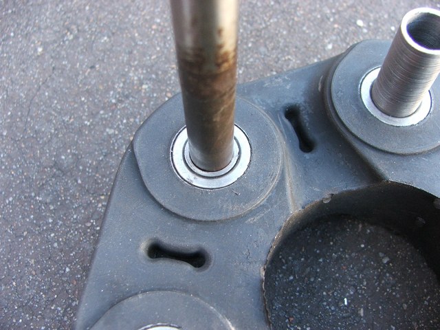

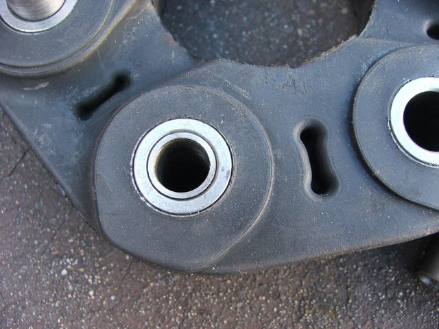

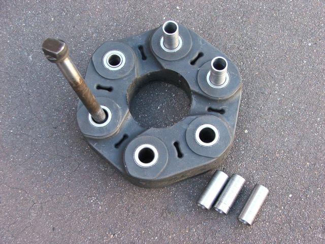

As usual, the propshaft is getting a modification so here is the mod to the front donut. The PCDs are the same as the Alfa but the stud holes are 2mm bigger. This needs some packer spacers made to take up the slack.
I machined these spacers out of some solid bar and then trimmed them to length.

are these the BMW donuts or XR6?
do you have a source where i can buy these?
from looking at the picture these dounts are thiner than the alfa ones, so would need a spacer to work with the standard propshaft. but i assume u are using a propshaft with universal joints?
Any place that supplies BMW parts. The number is 26 11 1229 065
Yes you have to pack out the fitment so it is the same thickness as the original. You can make specific washers or just use new ones.

According to the bmw number it comes from a variety of beemers, but the 4.0 v8 models all seem to have them. Also the 3.0d versions off 3 and 5 series use these. so they should be able to handle a lot of torque... :P
they are 105mm pcd and with 14mm bolts. the old number was 26 11 1 227 690.

Yes much stiffer (relatively) speaking. Lesser couplings are more compliant and you can twist them a little in your hand but not the V8 one.

That all sounds interesting but I already have a plan. I am using the above front donut with a one piece shaft and a UV at the rear. Hope to fit it during the week if I get a chance.
