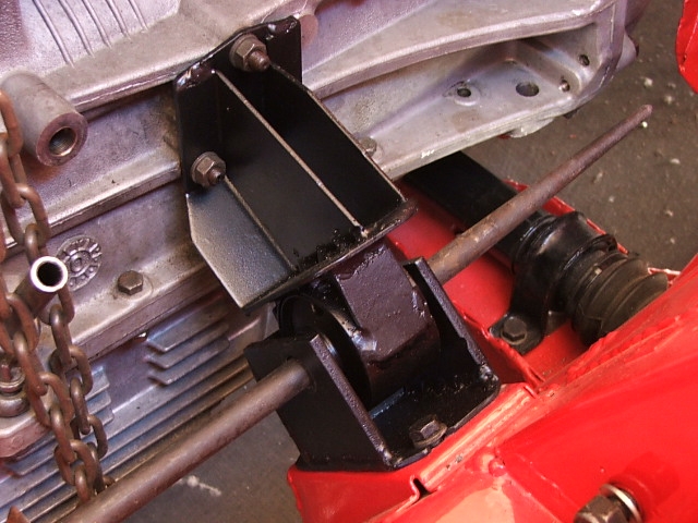

Ah must say you're a sharp one Mats. The engine is tilted to the right for bonnett clearance reasons because of the ITBs.
See photo for modification to engine mount to create tilt and improve reliability of the mount. Obviously you need to visualise the final fixing with a 16mm bolt.

Steering column on the RHS is nice too I bet, plenty of clearence for the exhaust routing over the rack...

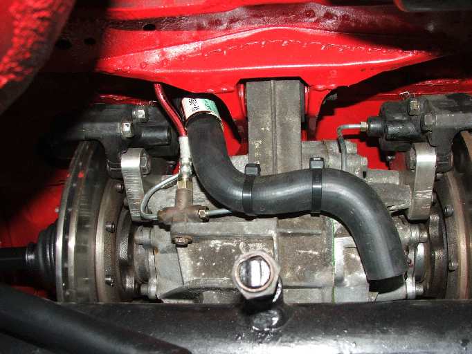

After I had a silly leak from a missing bolt on top the gearbox, I discovered that oil contamination of the rear brakes wasn't much fun to drive on or clean up after. Having fixed that original minor issue, I then thought if the vent ever leaks, I could have the same problem (although it hasn't leaked so far).
So made this little modification by raising the vent tube and fixing a 25mm ID hose to it to conduct any possible spillage away from the brakes. The idea is not perfect but its better than zip. Can be easily improved upon if it is really necessary but good and cheap insurance for now.
In the photo the tube size looks huge but in practice its not really a radiator hose !!
- Gearbox Vent Drain.jpg (52.46 KiB) Viewed 8098 times
Those rear brake rotors look huge! Is the aluminum of the transaxle casing at the right rear mounting of the adaptor for the caliper cracked?
Did you find some affordable rotors and calipers that work reasonably well with the Alfa pieces? How much is custom beyond the adapter for the caliper? Such a pain to adjust the Alfa rear calipers. Why did they do it that way?

The rotors are custom made from a combination of ATE centres and Nissan RB32 Turbo rotors and calipers. They have no handbrake component in this configuration although you could fit an inline hydraulic one if you want a handbrake.
The cost is probably not relevant owing to the different countries we live in.
The fitting is quite involved and largely depends on how low your car is set up. They are however self adjusting. If you want a conversion like this, contact DANIEL from this forum and he can make you all the bits. He made mine.

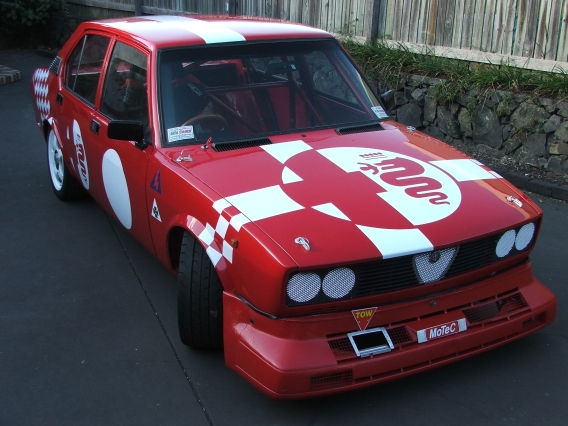

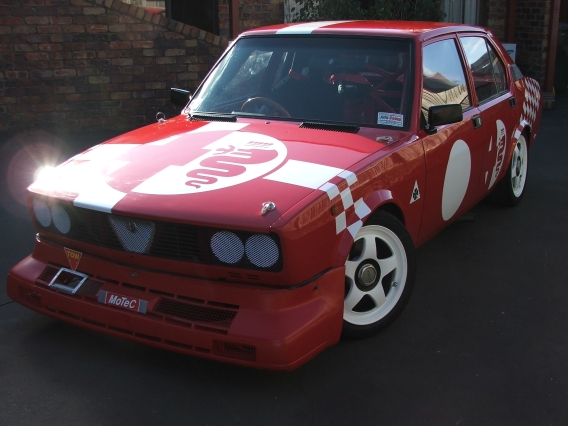

Hey guys. I can now stop driving the Brick on the track in the nude. He now has a bunch of new clothes so he can fit in with in crowd. He hee, check him out..
Dennis, thanks heaps mate.
- Rear right.jpg (198.21 KiB) Viewed 8069 times
- Front right.jpg (198.57 KiB) Viewed 8072 times
- Rear left.jpg (219.59 KiB) Viewed 8072 times
- Front left.jpg (170.34 KiB) Viewed 8069 times
Yeah, I've christened it the "105 Nudge Bar".

Just a quick question about your exhaust...does it easily pass the CAMS noise test?
As usual, really nice work.

Very nice piece of gear
But I've got to ask, is your snow plow from an upside down 75?
If it is, does the owner of the upside down 75 know that you have taken the front of his/her car and stuck it on an Alfetta race car?
How much snow do you guys get in Queensland? Does it help you grow banana's?
Seriously tho, are you prepared to share some front suspension pictures and specs....? Did I read about some upside down ball joints in another thread for this car?
Mr Midnight
Yes it does if you use 2 Kernel Sanders chicken wings to plug yer ears with.
De 4 Duk. The answer is yes in good time. No point prommoting a concept that is unproven. Wait until the end of the race season and I'll tell you if it works and how good/bad it is. It would be foolish for you to repeat my mistakes.
BTW the 105 nudge bar is not a 75 front bumper. Stick to Coopers and stop drinking that Murray brew and you just might come good..
