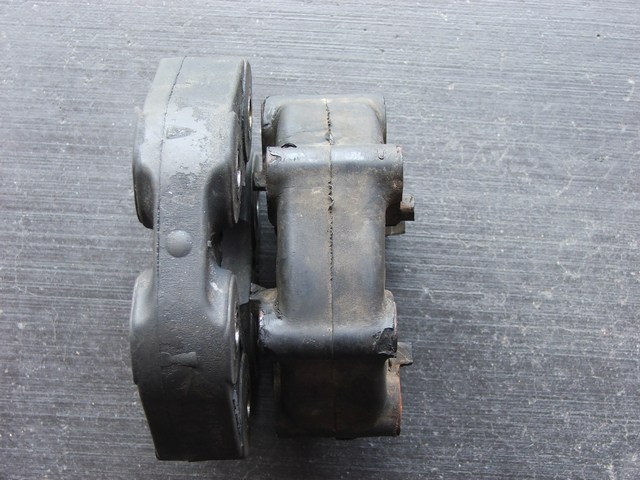

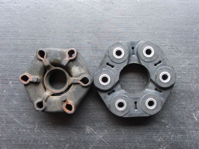

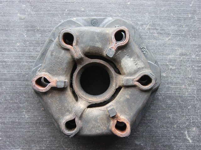

FOUL UP !!As with all projects, the best intentions go astray. I spent all of my time making sure the fixing bolt centres of the replacement donut were correct, even making spacers for them that I overlooked the overall diameter. This is because I have done a number of previous conversions which all worked so I just sort of took it for granted that the diameter was not going to be an issue. I roughly measured the rear engione mount opening to see if it would accommodate it and it seemed that it would. Now that I come to install it, I find only about a 2mm clearance at the circumference whereas the original Alfa donut has around 10-12mm.
There is only one reason for this. I'M Dickhead !! :oops: :oops:
So do not follow me in this post. You could wind up in the same dog poo.
This is one of the reasons why I was reluctant to post before testing for my previous car because things don't allways work out the way you expect.
Here's some pics to show you the problem. Sure it can be fitted but there isn't enough rotational room for the donut to "grow" when under full rotation load so that it will rub itself on the inside housing to destruction.
Back to the drawing board.....
1 Front donut comparison.jpg (75.61 KiB) Viewed 8358 times
2 Front donut comparison.jpg (89.6 KiB) Viewed 8360 times
3 Front donut comparison.jpg (91.08 KiB) Viewed 8359 times

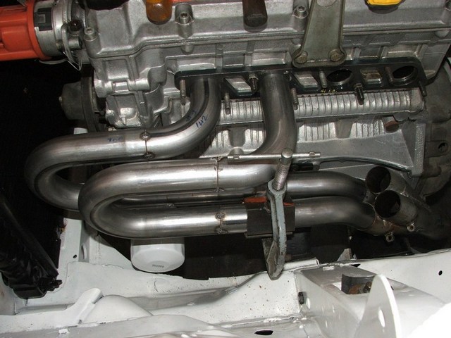

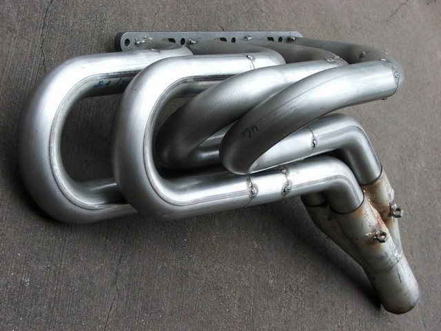

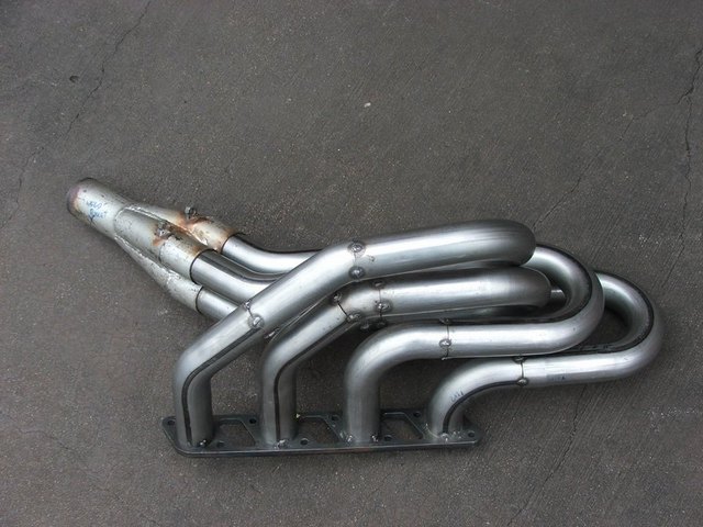

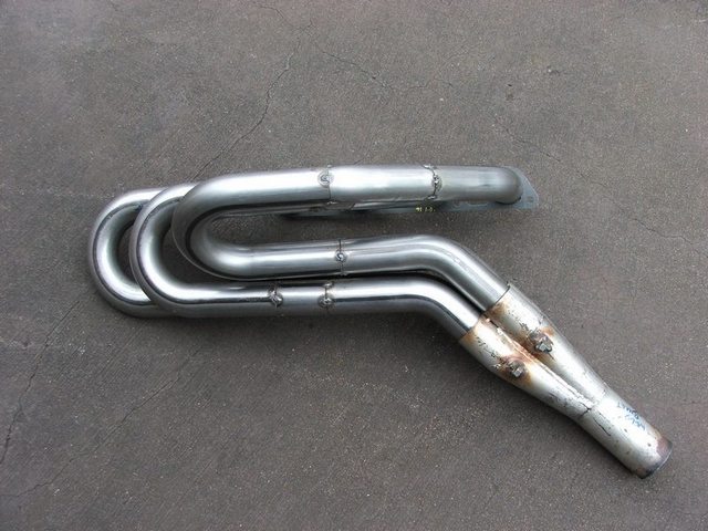

Started to feel a bit better today so I thought I'd have a crack at finishing the headers I started. Primaries 38mm I.D. x 915mm four into one merge collector.
These are for bottom end torque on my street engine. They can be further tuned by adding or removing lengths where they join the collector to get a proper match.
I think they are kind of cool. They remind me of some motor cycle headers.

Nice.
Alternator delete or switch sides?
Hi Mats, thanks. Yep alternator is on the intake side. See page #5

nah mate, those headers won't work. The zorst gas is not gunna go fowards like that! Ya gotta point em backwards, like on a drag car!

What made you go for the 4-1 in favour of the 4-2-1?

nice work :!:
they look good and im sure they will flow good :D
do you buy the tubing from an exhaust shop? or bend yourself?
Mats. I hear where you are coming from. For ease of construction of the exhaust for a medium power output engine but tuned for bottom end torque, the 4>1 with goilet collector is nearly as good.It is also easier to cut or add to the end of the pipes before the collector to finalise the tuned length prior to stiching on the secondary section. Additionally if we decide to upgrade the power output of the engine later and shift the power band up the rev range, we'll be using bigger ID pipes and shorter ones but the basic pattern is there for me to replicate and I don't have to scratch the head too much for how I am going to make the next lot.
Jason, I just got one question for ya? Does a fart go backwards and land between your ears if you're running in reverse? :D Lunacy appreciated at all times.
Brad,
I use prefabricated bends which I source from exhaust material wholesalers that supply the trade. Unfortunately they will not deal with retail enquiries. You may be lucky enough for an exhaust shop to sell you the individual bends or they may bend some up for you for a price. I cannot be sure.
The manifold plate is laser cut from 10mm mild steel by a laser cutting workshop.
For anyone else following this topic
The configuration of these headers as seen is contigent upon the location of the alternator on the intake side of the engine which keeps it out of harms way anyway.
