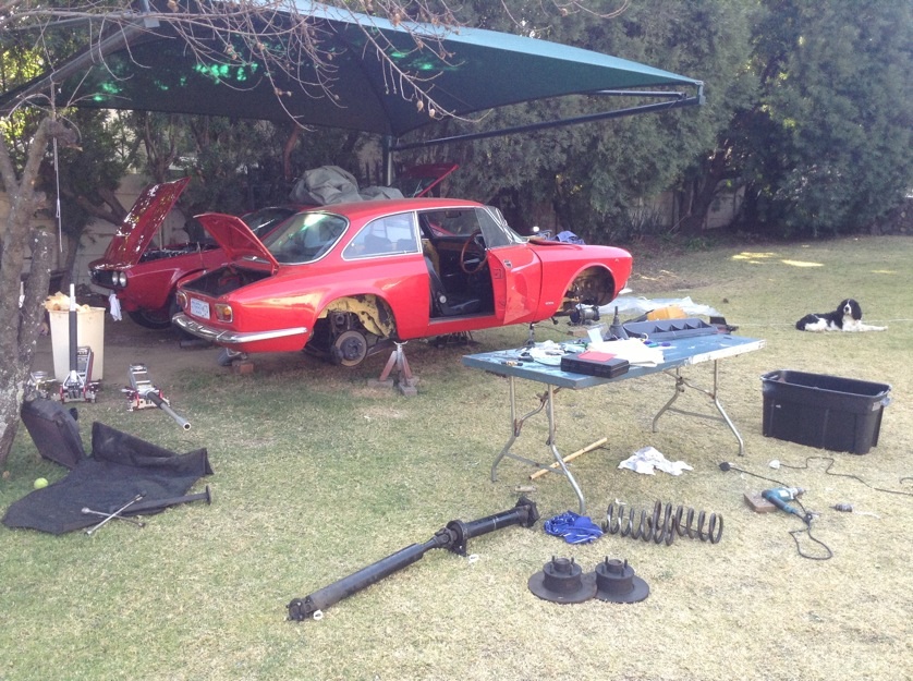

Not sure if I'm gonna make it to complete car as I leave SA on Tuesday next week . Anyway today was completing gearbox mounts , heating and pressing in rear Dedion to allow calipers to clear . My brake system seems to be a sprinkler system at the moment as the copper washers on banjos are seeping . Have not had this before . Gear lever and linkage is now custom as tunnel is 25mm different to similliair position in the M3 . Pictures will show better new gear lever system .
I have doubts if my prop is gonna be vibration free with that universal but we will see . Better option would have been to use M3 CV with sliding join .

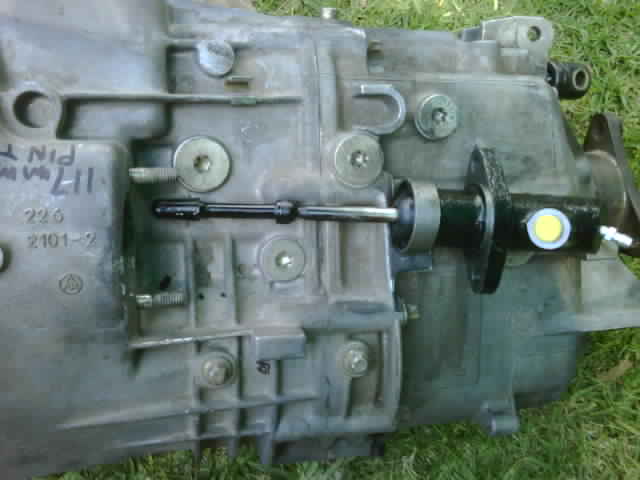

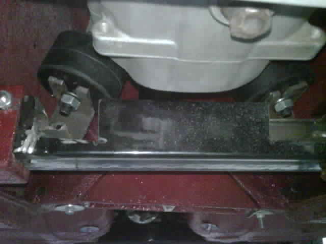

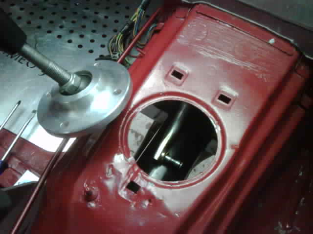

some additional pics of gear box, lever and assembly
G/Box tunnel assembly
kevin 50 gear assembly.jpg (21.36 KiB) Viewed 9860 times
Brackets fro g/box mounts
kevin 49 clutch 2.jpg (16.35 KiB) Viewed 9860 times
extended clutch pin
extended clutch pin
kevin 48 extended cluch pin.jpg (22 KiB) Viewed 9860 times

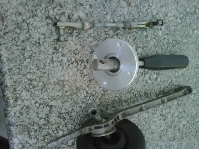

New gear lever
New gear lever
kevin 47 new gear lever.jpg (28.83 KiB) Viewed 9860 times

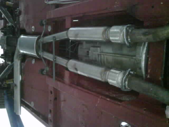

full exhaust
full exhaust
kevin 46 exhaust.jpg (16.1 KiB) Viewed 9860 times

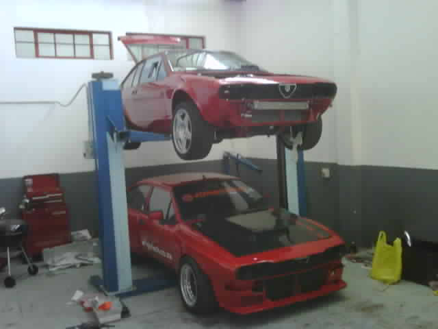

Wide body vs Std body pic
Wide Body vs STD body (and a Weber Braai!!! ) :)
kevin 51 wide body vs std body.jpg (15.81 KiB) Viewed 9848 times
That weber braai ( barbie) has been in good use - must have consumed 2kg of rump steak in two days :D SA style . Got all wiring complete and gotech/Powermods all wired in with help from Paul ( owner Marlboro giulietta ) . So bottom line is I did not make it in time to get police clearance on car and final testing in order to load into container on Tuesday . So I will leave car in "storage" for few months and come back for a week to finalize , test and load . Great pity . Anyway will post some up to date pics tomorrow .

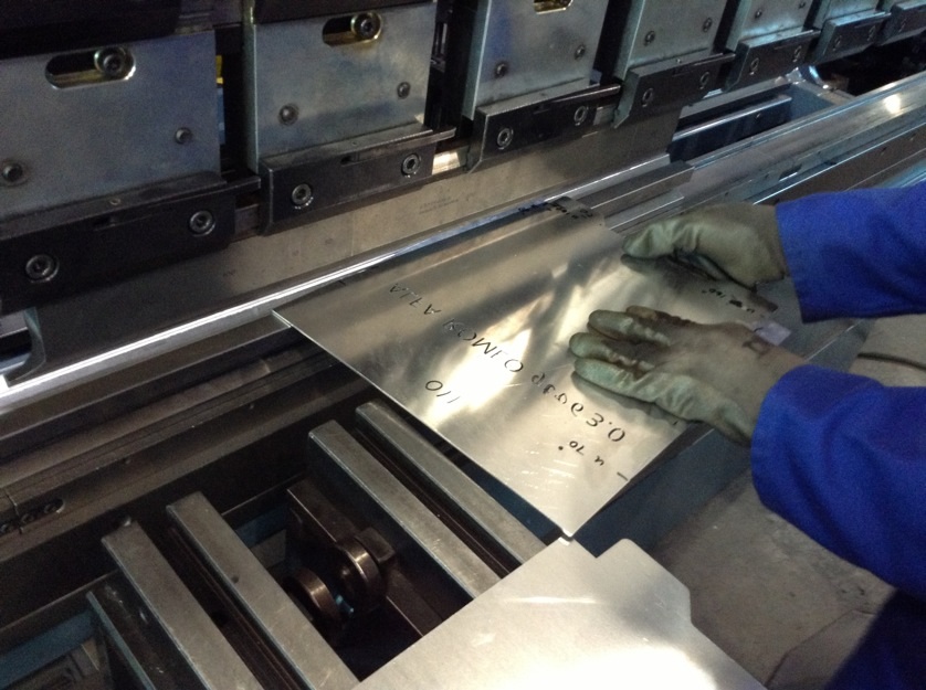

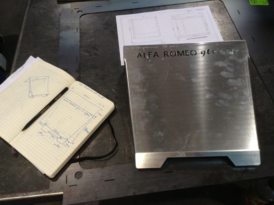

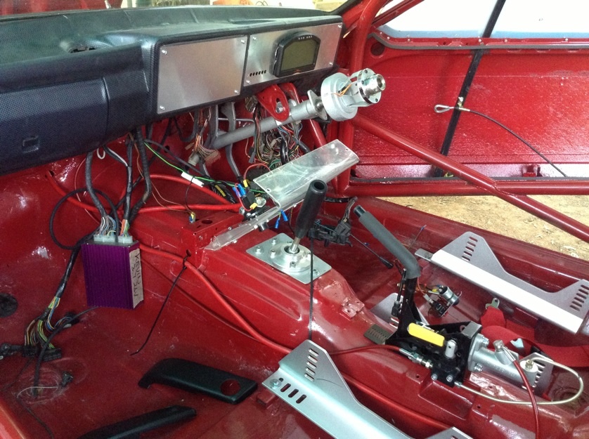

Work continues . Started making a centre consul which takes the shape of the bm tunnel . Laser cut it and bent it at my friends shop today .( Laser fab)

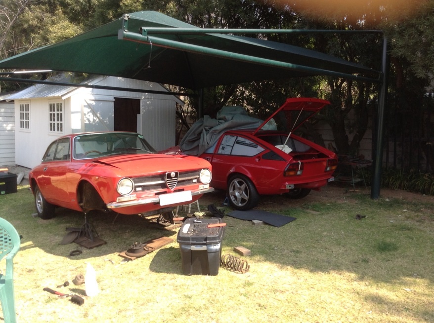

Bit of distraction on 3.7 but got junior suspension stripped out to go to Fernando . Hope to get some more pics of the 3.7 nearing completion . Only took it out of storage after six months .

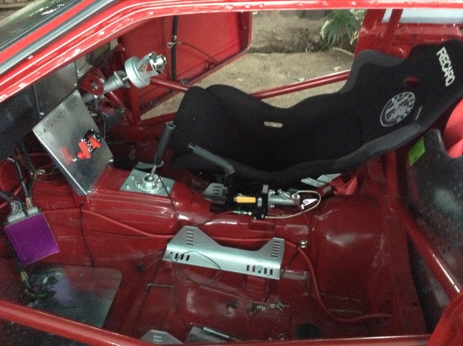

Started working on interior , fitting kill switches and start button . I can still reach the kill switch easily . Unfortunately I left my wiring manual in the Uk so struggling to figure which relays activate the brown wire once you power up .

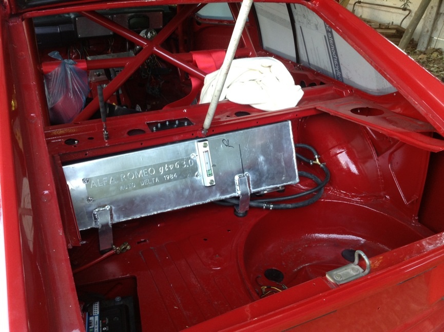

Petrol tank is now in which has its own built in swirl pot . Tank has three chambers with a fall to the swirl pot . Still to put foam in tank . Yes I know its high ( high cg) but I still wanted to carry spare wheel and leave battery in back as I still want to drive to race tracks .

Centre consul ( spelling) now in with the lazy boy chair . Finally got rid of the Porsche logo on the recaros

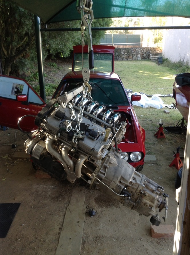

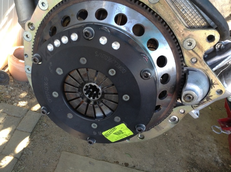

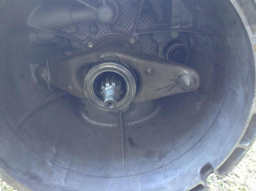

All was going well but picked up issue with clutch fork which is touching pressure plate . Aaarrggghhhh. So out comes engine and box again tomorrow and will make an adjustable pivot . I should have asked all the guys who have done this previously so could have saved myself some time . I will post pics of that mod so If there is another nutcase out there doing this conversion they can do it once . :(
Took engine out this afternoon to find where clutch fork was touch and its quite obvious . Will post pics to show problem .
The caps screws above on clutch are touching edge on clutch fork so I will make a longer pivot point on the left which will reduce angle . Will tap into housing and put adjustable bolt with locknut .
