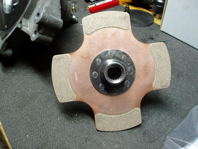

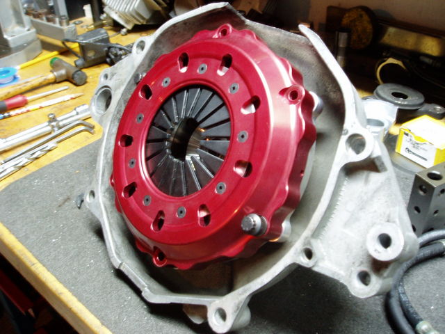

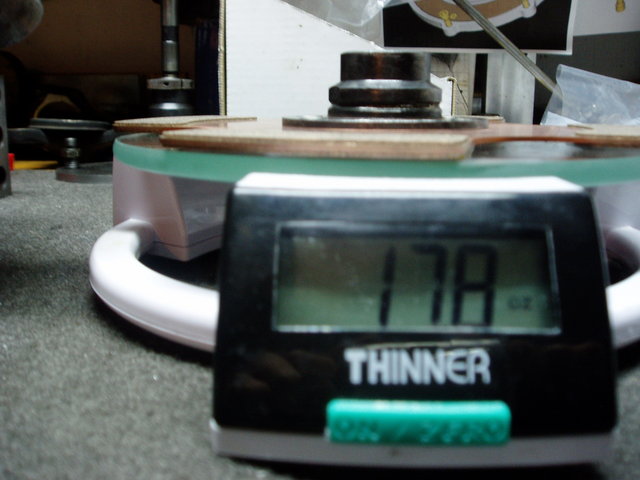

The plan is to use one disk at the time. Another on the pic is just a spare. The pressure plate weights less than 1.9 kilos and the disk with center weights 0.6 kg.
And as always, there must be also a question.
Can you suggest any throw out bearing to use? Should be a one with radius contact patch to match pressure plate.

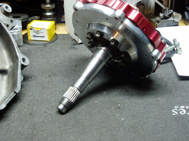

Heres some pics of my clutch project. A fair amount of machine work was involved.I made the concentric slave as its the only reasonable way to actuate the stiff clutch. Unfortunately I did not realize how much stiffer the pressure plate is over stock and will have to remake the slave with more area. Still results are very encouraging. Unbelievable improvement in response and shifting. Some judder on startoff but I drive this setup to work and in traffic wich is a pretty brutal test of this type of clutch. So far so good. When I replace the slave Ill post more pics of the wear so far.
-Tom Phillips.
This is the pressure plate and insert that I fabbed.
This works well so far but will have to have more hydralic area to reduce pedal pressure. Easy to bleed! 20 minutes. By myself!
this makes the syncros job a lot easier

Hi, the current slave area is 630mm2 but I figure Ill need double that for comfortable pedal pressure. Let me know if you find a good master cylinder wich fits. I tossed the entire rotating package except for the shaft. There really wasnt much to be gained by remaking it so I kept it. What did you do for the spline? Did quartermaster have the 19 tooth broach?

The pressure plate is from RAM. I did the flywheel assembly. Not much point in making the pressure plate with so many good clutch makers around. I did the flywheel asembly and slave. I also had to mod the disk hub cause the supplier did not have the odd ball broach for the alfa spline. What about your disc? does quartermaster have a hub to fit the alfa transaxle?
BTW: Ram said this single disk can handle 500lbs torque. Let me know if you find an alfa v6 that needs more!

Quartermaster doesn't have centers with suitable spline for Alfa, at least I couldn't find it from their list. I broke two standard disks and took centers from them. Some turning on lathe, bolting them on friction plates and voila.

Helix has the disks with Alfa spline.

In the 80`s and early 90`s AP made a 3 puck disc for the std gtv6 twin plate clutch with the correct splined center..There might still be some of those lying around. For interest sake they also supplied a std Alfa presure plate with an uprated diaphram..I bought my lsat new complete AP clutch in 1996...
