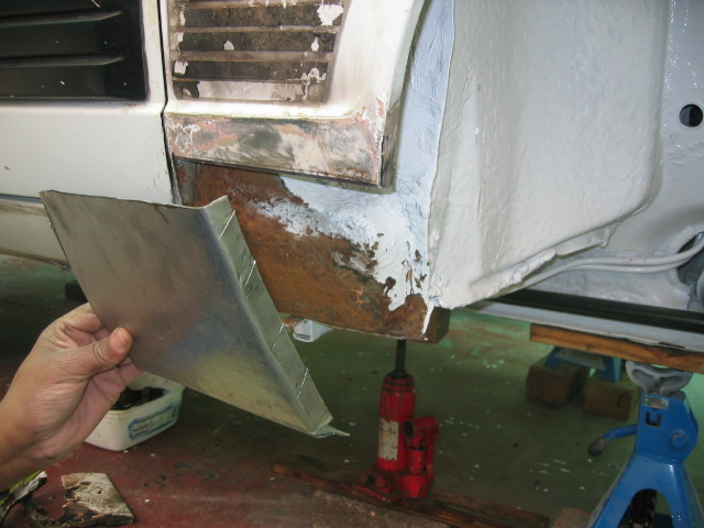

The first step was to strip the car totally underneath, clean it and give it a coat of paint so you dont have dirt and oil over the assembly of the suspension, gearbox, prop etc. Also gives me a chance to see what needs replacing. Upon doing this I discovered a fair bit of rust in the floor pannels, cills and rear cill. Hence the plan has started to chainge so I figure I must cut all the the rust out. This is starting to become a big job if its gonna be done right.
Budget is creeping but I have managed to borrow two pro's in metal work from a friend for a few days to roll some new panels.
cut rusty cills

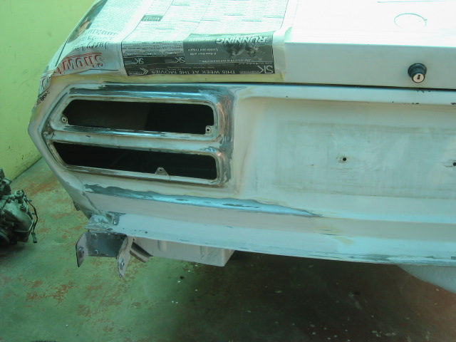

Cut out major rust hole in passenger floor and new plate put.
Believe it or not its just from bad maintenance of drain holes in these areas thats caused the rust otherwise the body is perfect. No accident damage anywher.
Finish of back and start flattening.

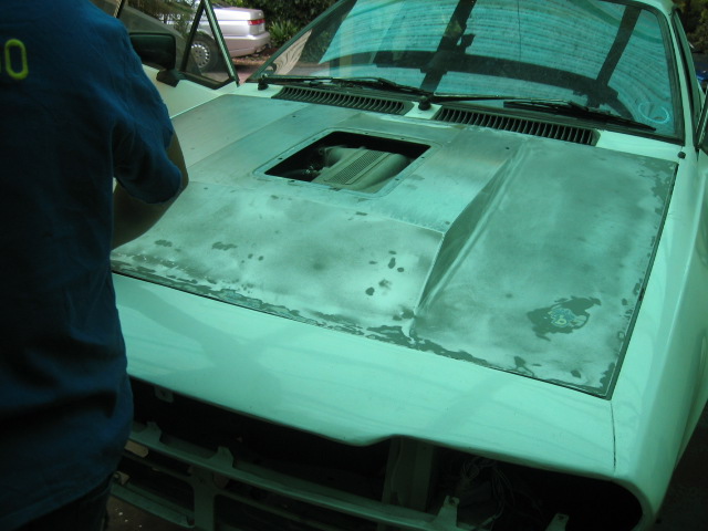

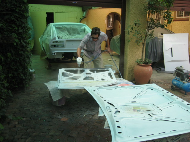

Drive way is starting to look like hell but im sure a pressure cleaner will do the trick. I will spray all the internals of the doors as they will be exposed. Some will say cut this all out and save weight but im not going there at this stage . Maybe later on in the season but i mustv get car on the road in a months time.
Thank goodness Baz popped in. He picked up major spray problems on my final coat . If you dont know he is also an expert in spraypainting. Fast drying hardner, bad technique etc. Any way final coat complete and perfect with assistance.

Looks great Kev. Just wondering what grade steel you use on A-pillars. I dug out a heap of rust in my GTV and need to replace some steel.
I think Kev did some metallurgical analysis and was still not quite sure what to use.He then cut a piece out from the chassis and had it spectographically gas analyzed..It came up with an excotic material that he would have to import from Russia so he just used mild steel plate... :D :D :D :D :D :wink:
Kevin,
Where is your respirator??? I get sick just by using spray cans!
Your right Z, lungs not so good. Normally do wear one. Thought the internals would be a quick job.
The cills are mild steel.
