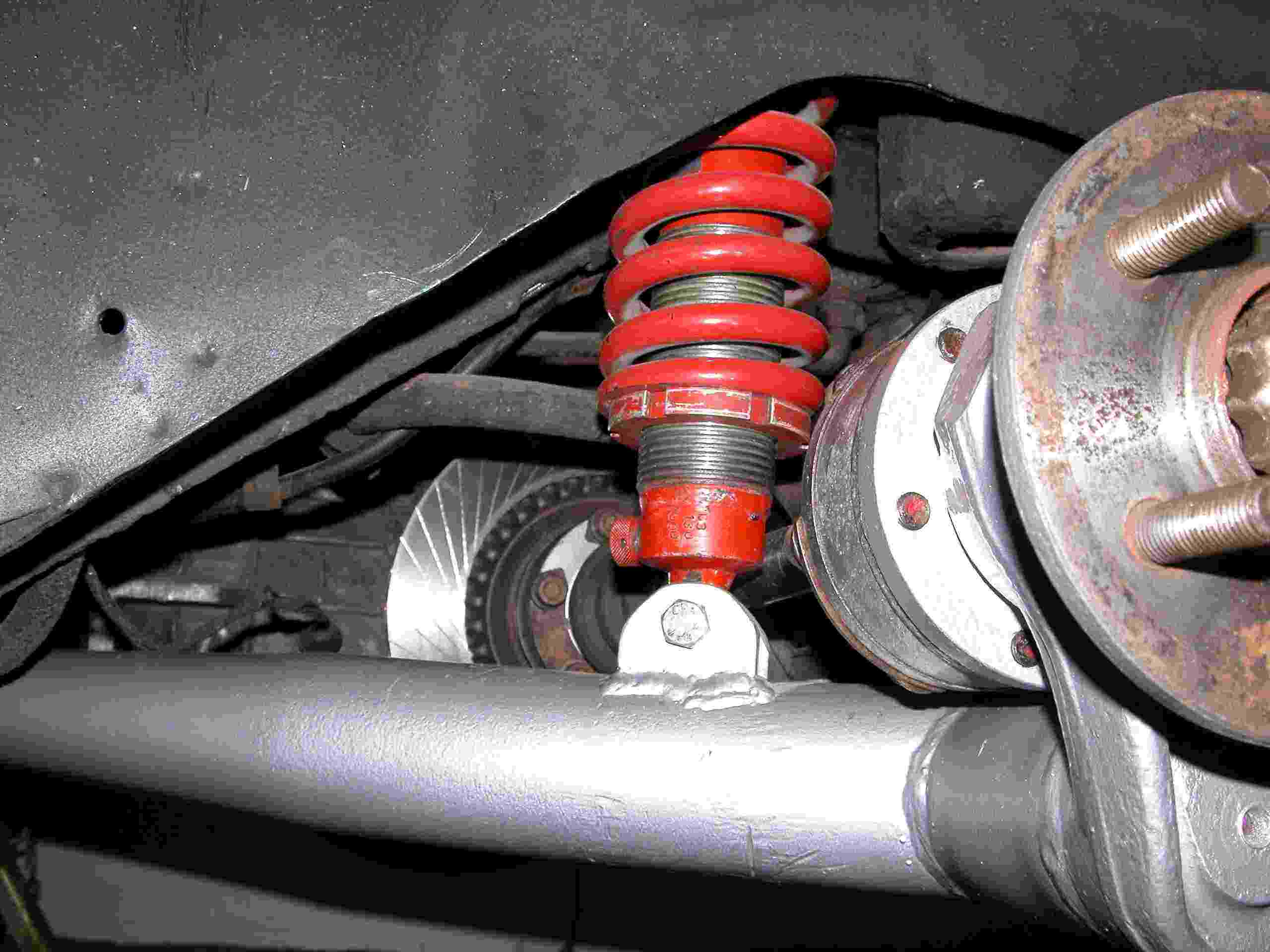

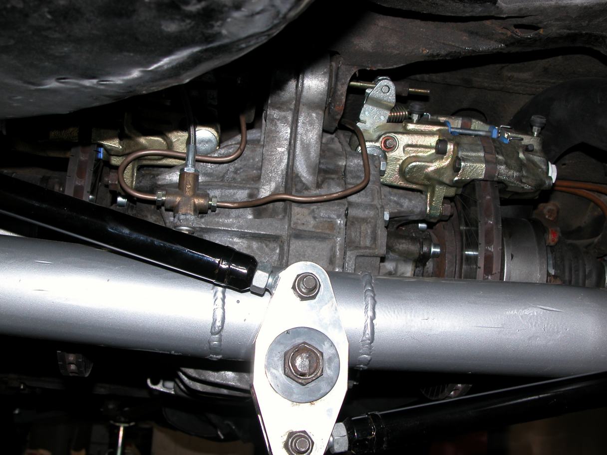

More pics

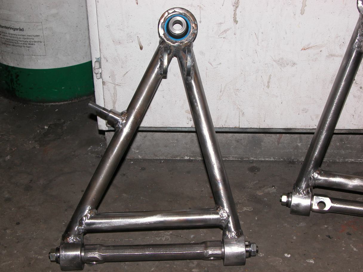

Now thats a serious track car. Great pics.Have you got a few more pics on the upper and lower arms to post.

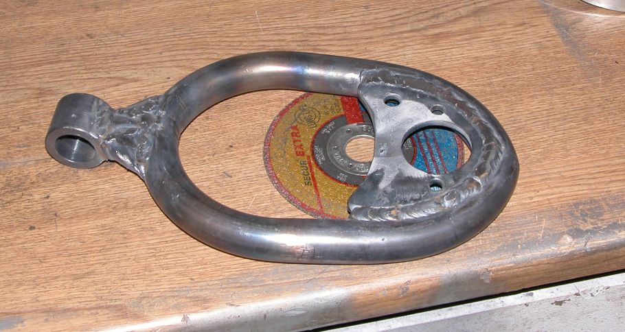

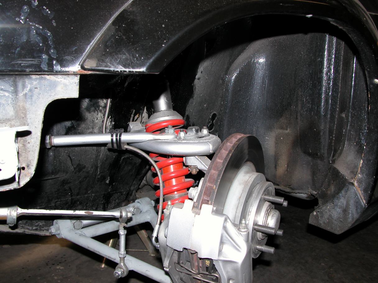

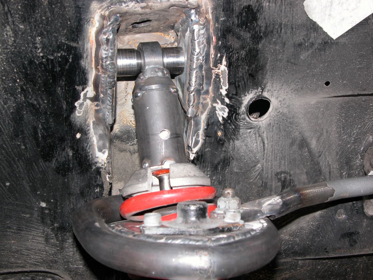

Pics of upper and lower A-arms.

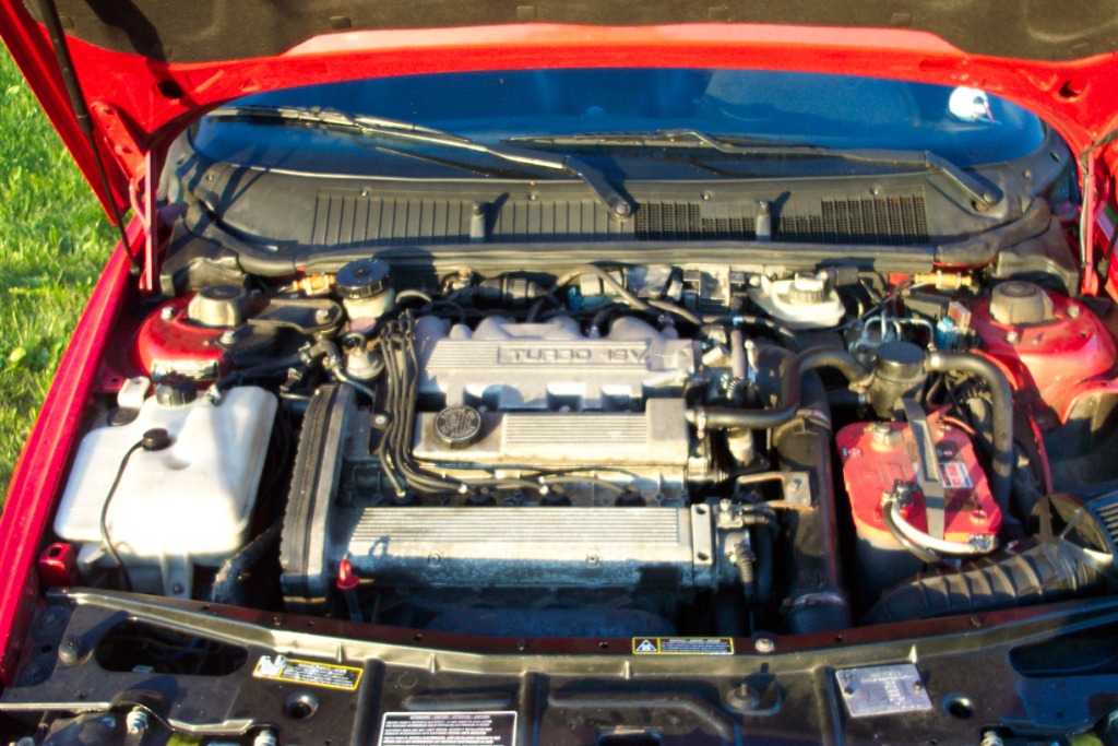

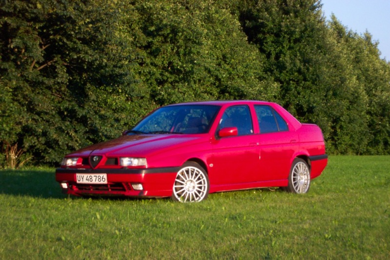

Maurizio,
Here are 2. The car is equipped with a chip from Squadra in Holland. Makes 228 HP. Heavy car (1500 kgs) but great fun to drive.
