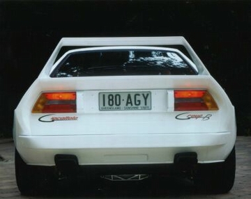

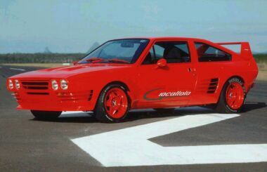

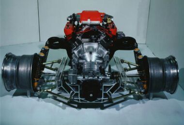

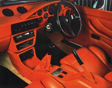

The Giocattolo is certainly in the ballpark but its not a GTV and ultimately runs a Holden V8. As good as the car is, it would have been more gratifying to see it all Alfa in my opinion. Buy hey, the guys who gottem say their worth gold !
Nevertheless, I see where you are coming from Bazza.
Here's some pics of it for those not familiar with this Oz production car:
I think an early steering correction is needed though:
Don't want to put a dampner on any enthusiasm but I would suggest that to keep our "Project Alfa" all Alfa would see a more challenging and probably more satisfying end result by keeping it in the family so to speak. Otherwise it will quickly become a totally unrecognisable Alfa GTV and lose the relationship with this forum which in the main is about the GTV6
