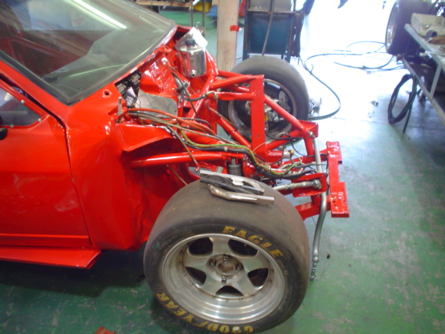

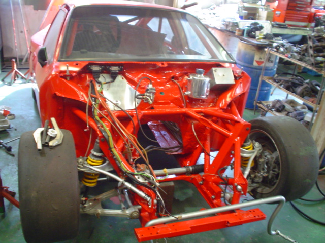

He is revamping the old GTV racer to go "scare" some of the big boys here as he says.
Sooo,we are trying some different things on the old 400hp base engine I did 15 years ago..

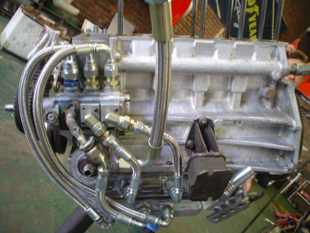

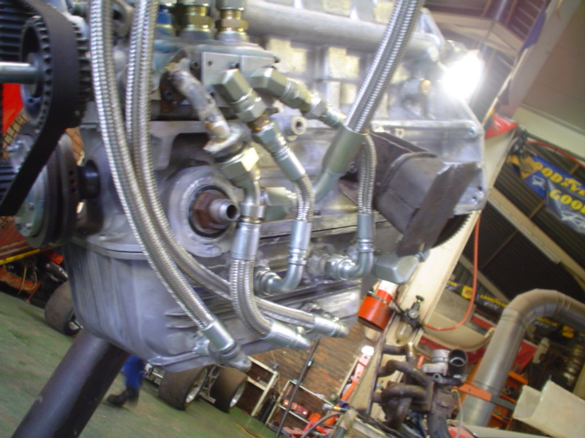

Franco came up with a very novel dry sump system that we hope will work well...
So far the car has been stripped and rebuilt in anticipation of the new power plant.
Ill update as we progress..
8)
8)
The new experimental dry sump setup... :shock:

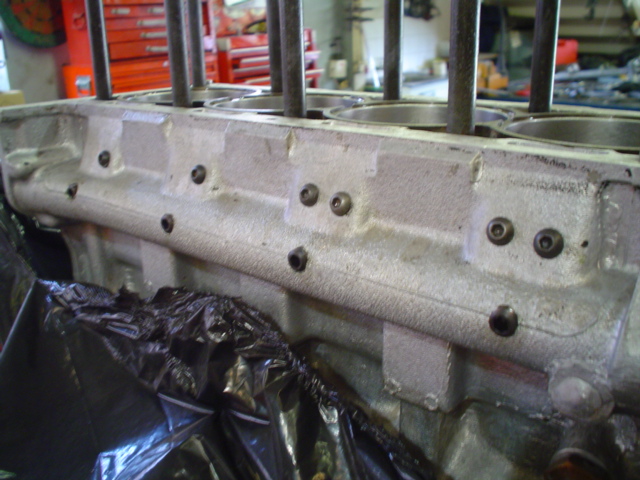

Remember all those stories about old Magnesium (Electron..hehe..for Jim and Mike..) blocks disintegrating from old age ??
BS..This is my old magnesium Autodelta race block from the seventies..Its sturdier today than it ever was ! Engine number DO 8 !

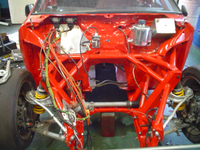

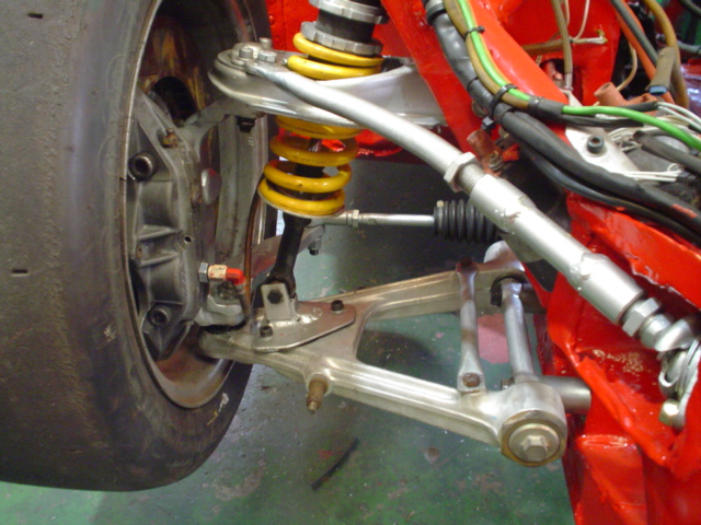

That's some serious fabrication work for the foward subframe. It looks great.
Is there a good reason for turning the LCA upside-down instead of making a new one?

Mats wrote:Is there a good reason for turning the LCA upside-down instead of making a new one?
Might be the autodelta lower A arms they didn't want to loose, if they are light weight?
These are the proper Autodelta Aluminum LCA`s..This is how they are.. 8)
