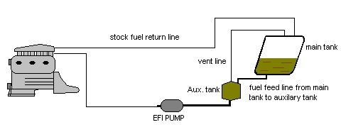

Ok I was trying to come up with something and, erm. please dont flame me here, im running a fever right now (thanks to our "warm" spring), if you see some irrational ideas here:
yea I know fuel return line enters the tank from bottom...
no surge.jpg (18.94 KiB) Viewed 10779 times
Looks like a complicated way to make the fuel system perform weird. :wink:
Go with the first plan or make som bulkheads in the tank to control the fuel movements.
this will work...
just put the return line also on the aux. tank. and use more then one pickup-point on the original tank, preferably on both sides of the tank. larger diameter hose really helps here.
Used that setup on the Opel Kadett C Caravan with a 2.0 16v turbo engine from a friend, worked great.

Maybe I'm over simplifying the problem (and therefore the solution), but wouldn't a small tank between the main tank and the pump that sits below the main tank (not a problem in a GTV6 as the main tank is so high), holds a couple of litres and is vented back into the main tank (so any air drawn in can escape), ensure a reasonably consistent supply (unless you wanted to do skidpan work with only a few litres in the tank :lol: ) Maybe that is what you meant with the diagram?
My own low bucks racing solution is to run with at least 20 litres on board :oops:
Oh, so long as the pump is below the tank, I don't see why its orientation would be an issue?

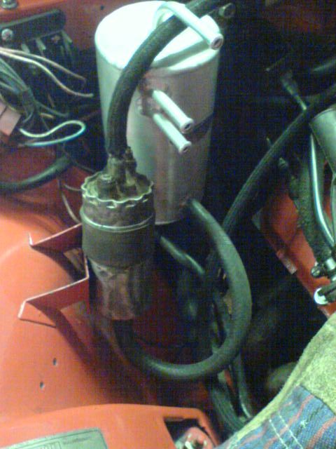

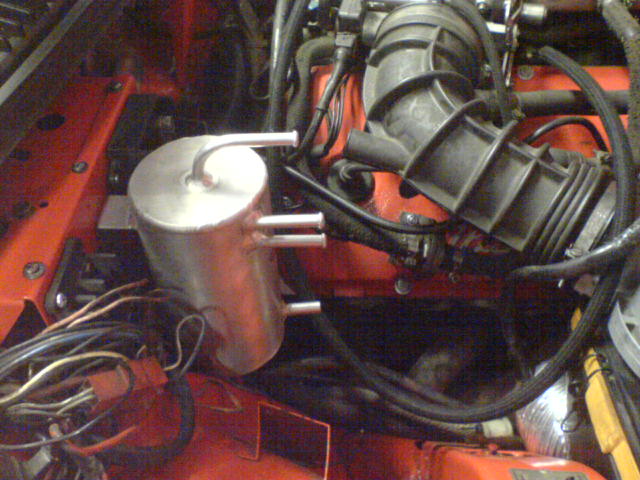

Well, it's the priming/friction/bearings whatever i was concerned about. Since I'll place it below the surge tank hope there will be no problems. Well no risk no fun.

Are you mounting surge tank and fuel pump in the engine compartment?
I think you may get hard starting since surge tank and fuel pump sits above main tank, and hence fuel may drain back to main tank when engien is turned off - not sure it will run well even if you get it started. The pump would have to suck air/gas all the way from the main tank through the surge tank - I doubt that will work. These pumps are not good at sucking. Usually, it is all mounted at a level below the main tank so that gravity will feed the pump. Maybe you have a separate feed pump?
Anyway, I guess you can always try and see what happens.
Re: Fuel surge tank question
You will also be heating up the fuel which isn't very good.
