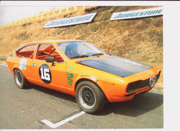

I have an alfa romeo alfeta GTV year 1978 motor 2000cc (same body of GTV6) and maybe you can help me out to find a differential box, my car has a 410 and there are some others with 430 but talking with some friend that I race with, they had tell me that there is one 478 which is faster, if this is true can you tell me where can a buy one like this???? I race my car in El Salvador central america with another 29 cars
