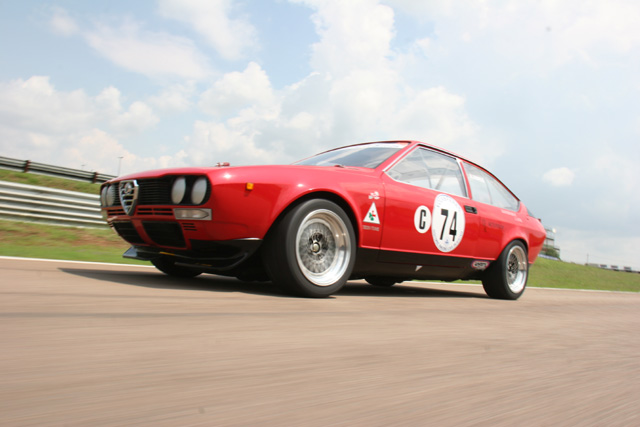

Frosty, post some pics of the car before you start. Its great to watch a project start. Look on Alfabb forum for a 75 race car build by JJ. Its really interesting. The cage he has will be very similiar to what you will do apart from the doors. They follow a NASCAR design which you will recognise if you ever watch there series on near fatal crashes. You might have to sift through some of the replies(not going there as its behind us). Look at castor arm conversion with ball joint. From this thread you can guage whats pretty much out of budget.
Hey Barry, Jose has put the ultra light weight Alfetta GT together again. have you seen it.
Ps Frosty,just leave the pics of the jumping caslte out ,dont want to make Baz jealous.
Pic below by Andrew
Pic below by Andrew
- IMG_9405resize.jpg (79.77 KiB) Viewed 8714 times
