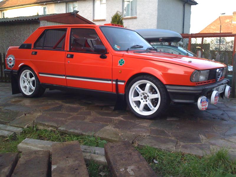

Very Nice and clean Giulie!! love the wheels too, where are you located? Always nice to see a Giulie like that!
Re: Giulietta Stage rally car
FIrst thought it was an OZMobile but second thoughts the houses don't look right but then its RHD...um?
UK.
Thought so...I can spot a big brake conversion tooMats wrote:UK.

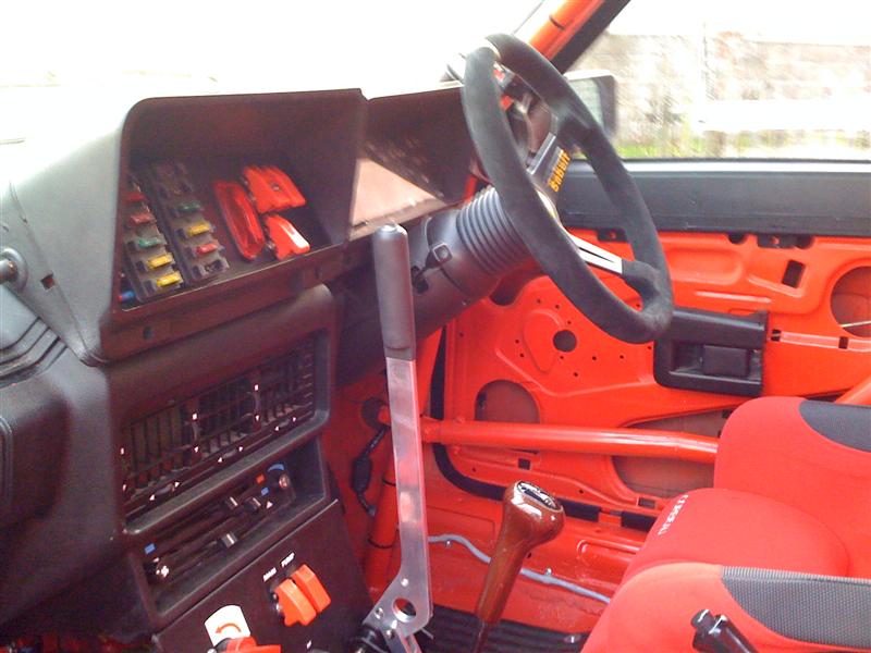

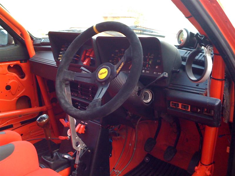

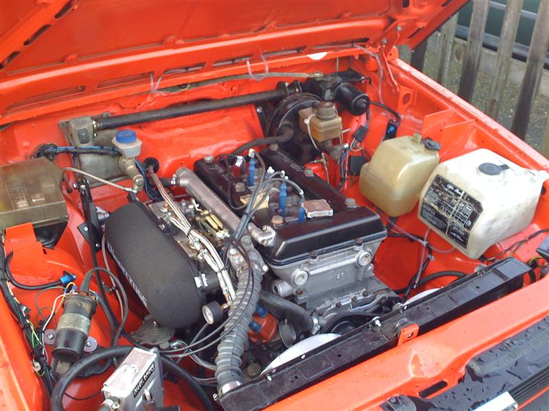

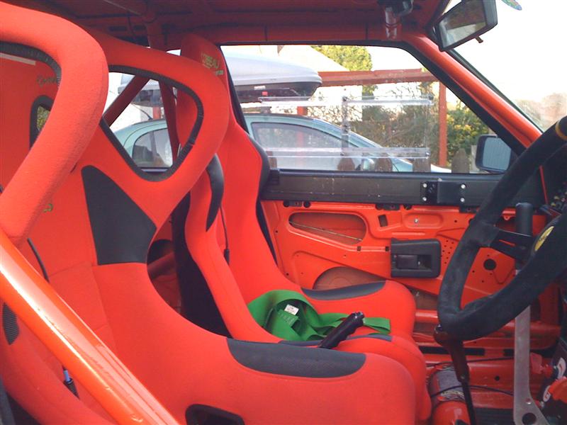

Hi all
Yes its a UK car and these things are seriously rare over here,in 3 years i have only seen 5 for sale, i bought 3 of those to make this one.
Totally stripped, restored, seam welded, strengthened, roof vent and caged shell before fresh paint. All glass (except windscreen) replaced with light tinted perspex + sliders
Rebuilt 2.0 with Jim Evans gas flowed and large valve head, 1.8 inlet cam, balanced bottom end and rebuilt Weber 45's.
Mixed a few transaxles up to get a short gear set, TS LSD and 4.3 crown wheel and pinion, standard rear brake (to be upgraded)
Gaz 2 1/4" front adjustable struts (no torsion bars), Gaz adjustable rear struts with pigtail spring on alloy height adjusters. All one off by Gaz.
Full Superfelx bushing throughout.
28mm front antiroll bar (made myself), 25.4mm rear anti roll bar on its way.
Wilwood alloy 4 pots with 280mm brake rotors on custom bells.
All brake and fuel lines inside car with euroquip braid pipe and fitting, hydraulic handbrake and bias valve.
Battery in alloy boot tray with power line inside car plus full rewire.
2 x Corbeau seats with TRS harnesses, alloy co drivers footrest.
Sump guard and soon to be made DeDion guard.
Plus lots of other odds and ends.
