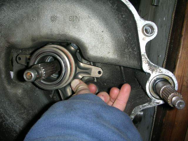

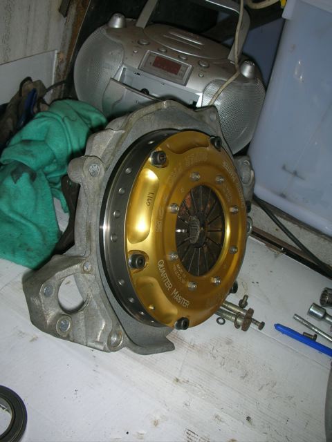

this is the setup i use. been great so far. nice engagment.
i have been using a tilton hyd release bearing aswell.
the clutch is a twin plate.

Benski, great stuff - very clever. Whats the reason for staying with twin plate when going to all the effort. Personally twin plate is easier as i have many spare GTV6 clutch housings. But single plate is lighter. Imput welcome.
Question is if you have access to both housings which is the best way forward for racing ?
Re: Racing Clutches (lightweight)
Kevin,
the clutch housing is actually from a 75 ts. the only difference i found was the method of retaining the flywheel bearing. gtv6 uses a locknut and other cars seem to all use a circlip.
went with a twin plate as i have had great success with them in the past. plus it was cheap off ebay .
i had a flywheel made.
the weight of this set up is significantly lighter than the standard twin plate. plus the smaller diameter helps.
this is on a race car and doesn't need the use a road car gets.
gear changes are great.
